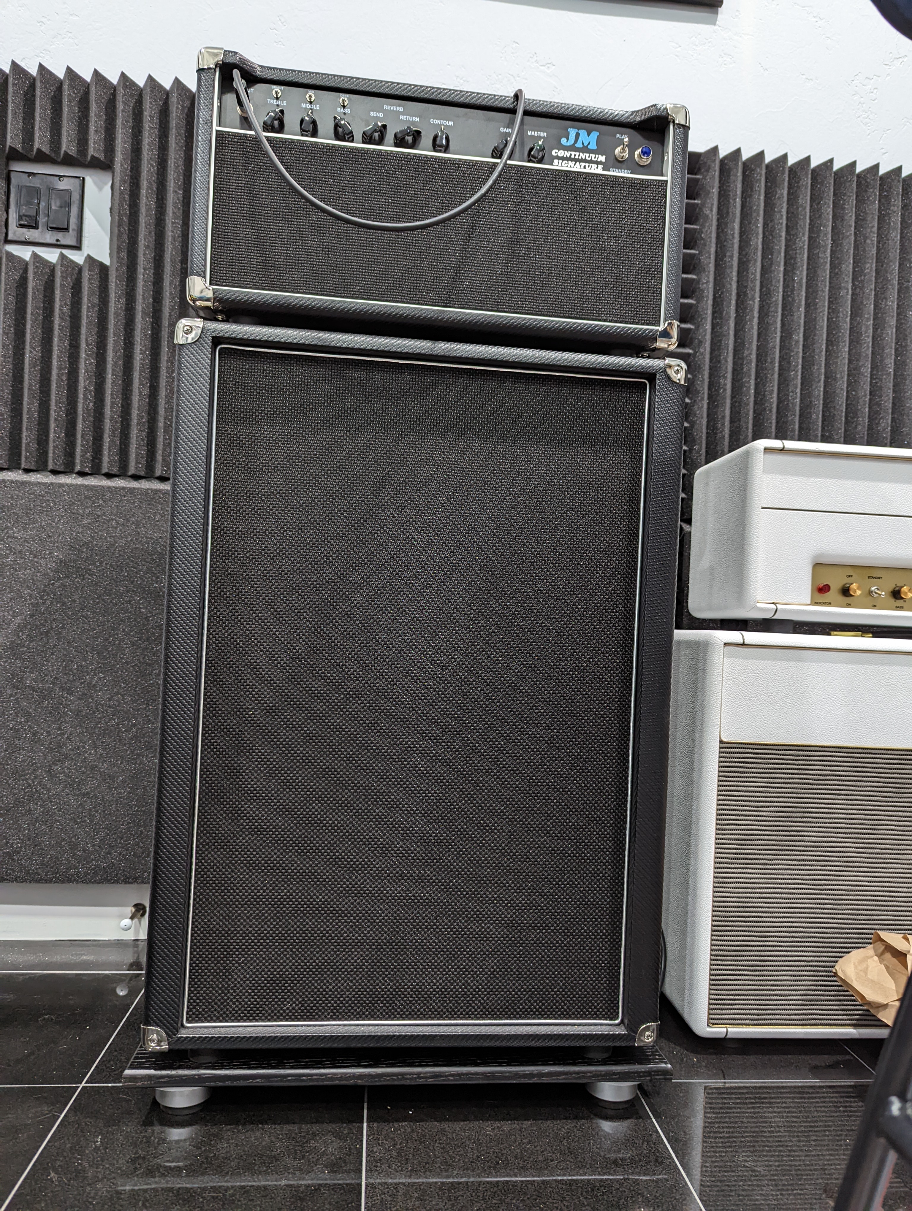

Just wondering if any of you use Iso pucks or the auralex gramma boards or any other decoupling for your amps?
I just moved to a new house and ordered some of the stage 1 isoacoustics pucks. I'm going to mount them to a plywood board and see what difference it makes. Will be a few weeks until I get around to this while we unpack and get settled. But I will report back if anyone is interested.

I use a 2" thick closed cell foam pad to isolate my bass rig. Decouples the cab nicely from boomy/stages, or my homes floor, so I'm not driving the joists. My ghetto Gramma.

I finally got around to building my decoupling board and testing it. I could definitely notice improvements and plan to build another board or two for different sized amps. Bass and low mids feel tighter, especially with distortion.
After a certain level of loudness, I still get some nasty resonance in my room from windows and doors vibrating, but I didn't really expect this to eliminate that.
I had a scrap piece of solid cedar that I used. I'd recommend a wider piece than this as the isoacoustics feet are a little wobbly by nature. Especially with a vertical 2x12 and 100 watter on top.
Ripped the board to size, drilled holes for the feet, rounded over the edges with a router, shot some satin black spray paint, and mounted the feet. Pretty quick and easy.
