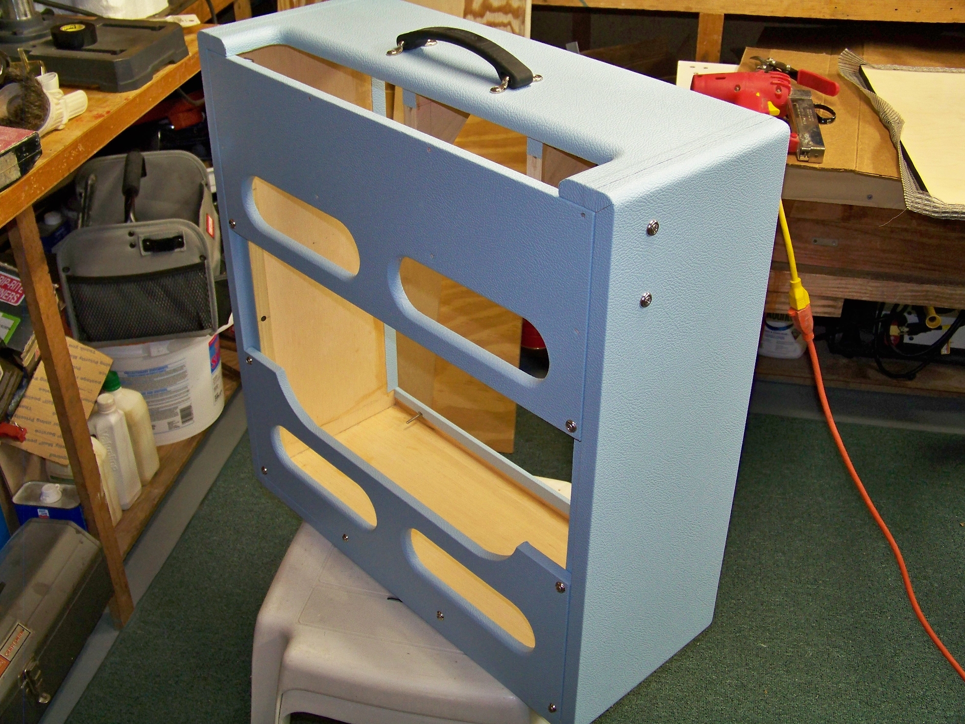

I have always thought the Fender Narrow Panel style cabs were very cool. Thought I'd use this design as a cab for a Supro 1688TN build. I was thinking all ash, with a natural finish, but my local hardwoods dealer had very little to choose from. So I went with plywood, 3/4" for the cab using blind rabbet joints with Gorilla glue, and 1/2" for the speaker and rear baffles. Covered in a baby blue tolex adhered with Weldwood original contact cement and some hefty ventilation. It will house a Eminence 15" Big Ben speaker.
I've had it assembled prior to covering it and it sounded pretty good. The cleans are - well... clean - and as the volume is brought up the distortion becomes chewy. No metal with this amp, but electric blues to hard rock very doable - what I was aiming for.

Very nice work!! That looks really sharp.

Love the color! I've moved the thread to the speakers and cabinets subforum.

Impressed...with the cabinet, of course! But your carpet! Good sawdust collection system?

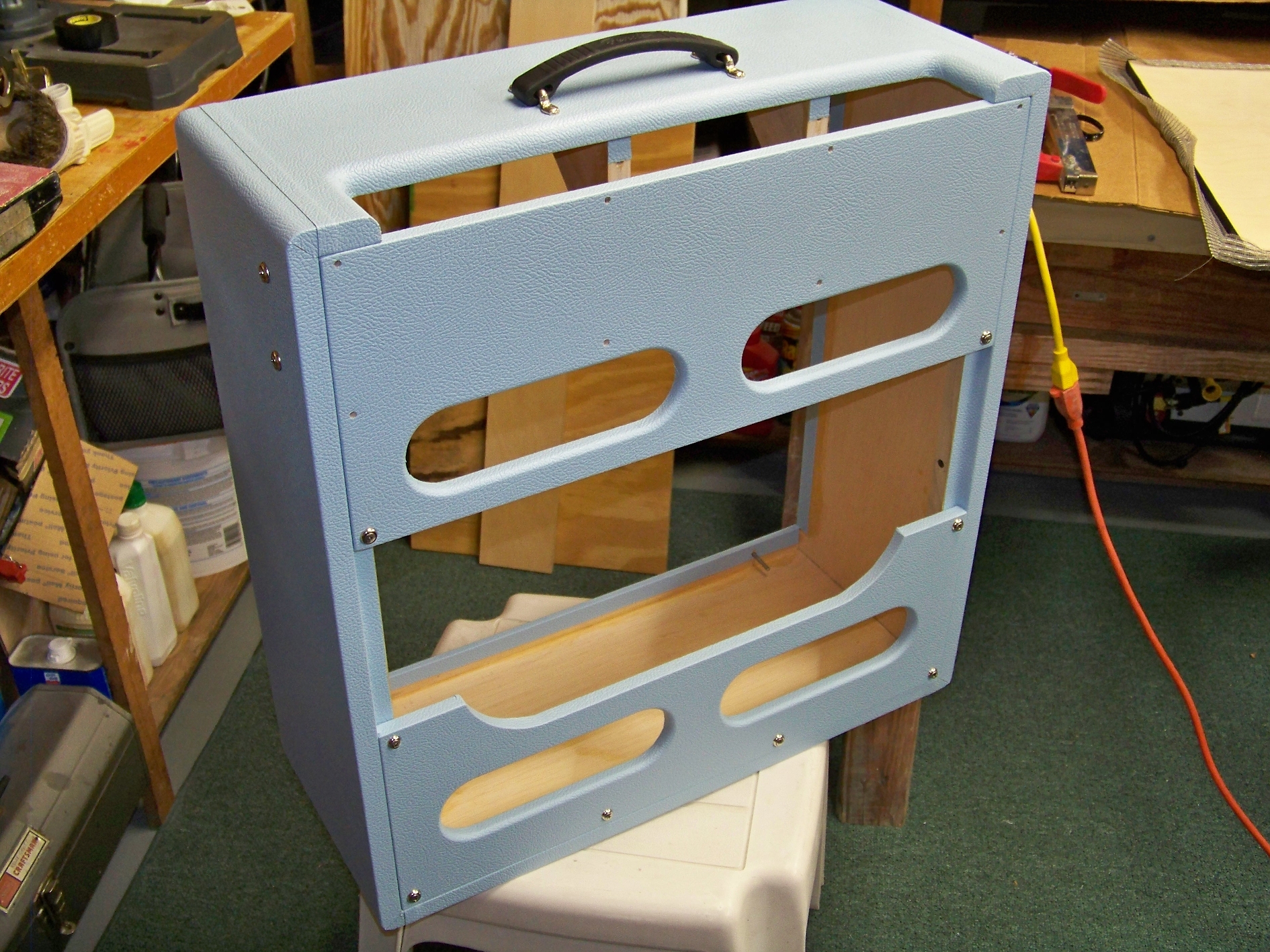

Here it is assembled. I am chasing down some intermittent hash that has emerged in the normal channel. If I were to build this again, I'd skip the normal channel and add in reverb.
And if you use this grillcloth from AES https://www.tubesandmore.com/products/g ... ite/Silver be careful when cutting it to size. The wire shards are like razor blades. I wondered why the cloth was turning red....

That is a great looking build! Nice finish out and attention to details.
