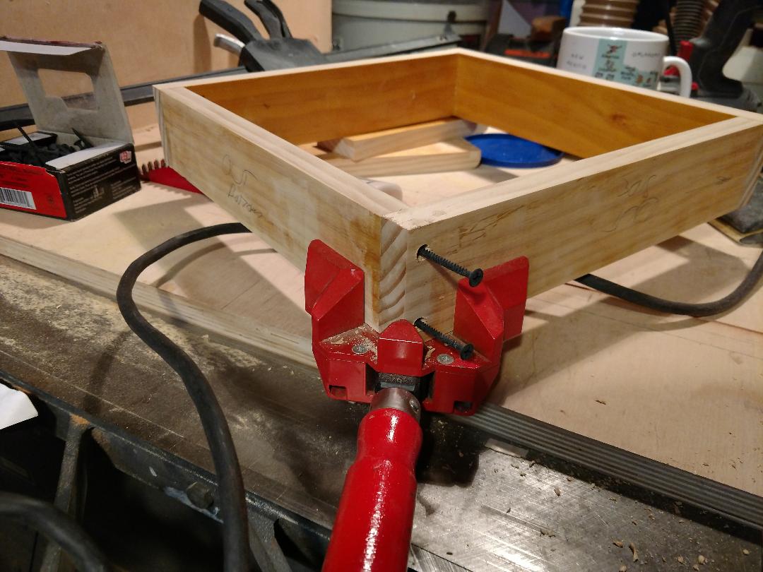

Time for guts. I ripped up an old OS open back combo pine cab for the interior bracing - do love cutting pine! The baffle frame I built outside the cab.
Picture frame clamping jig word well for any 90° joint.
