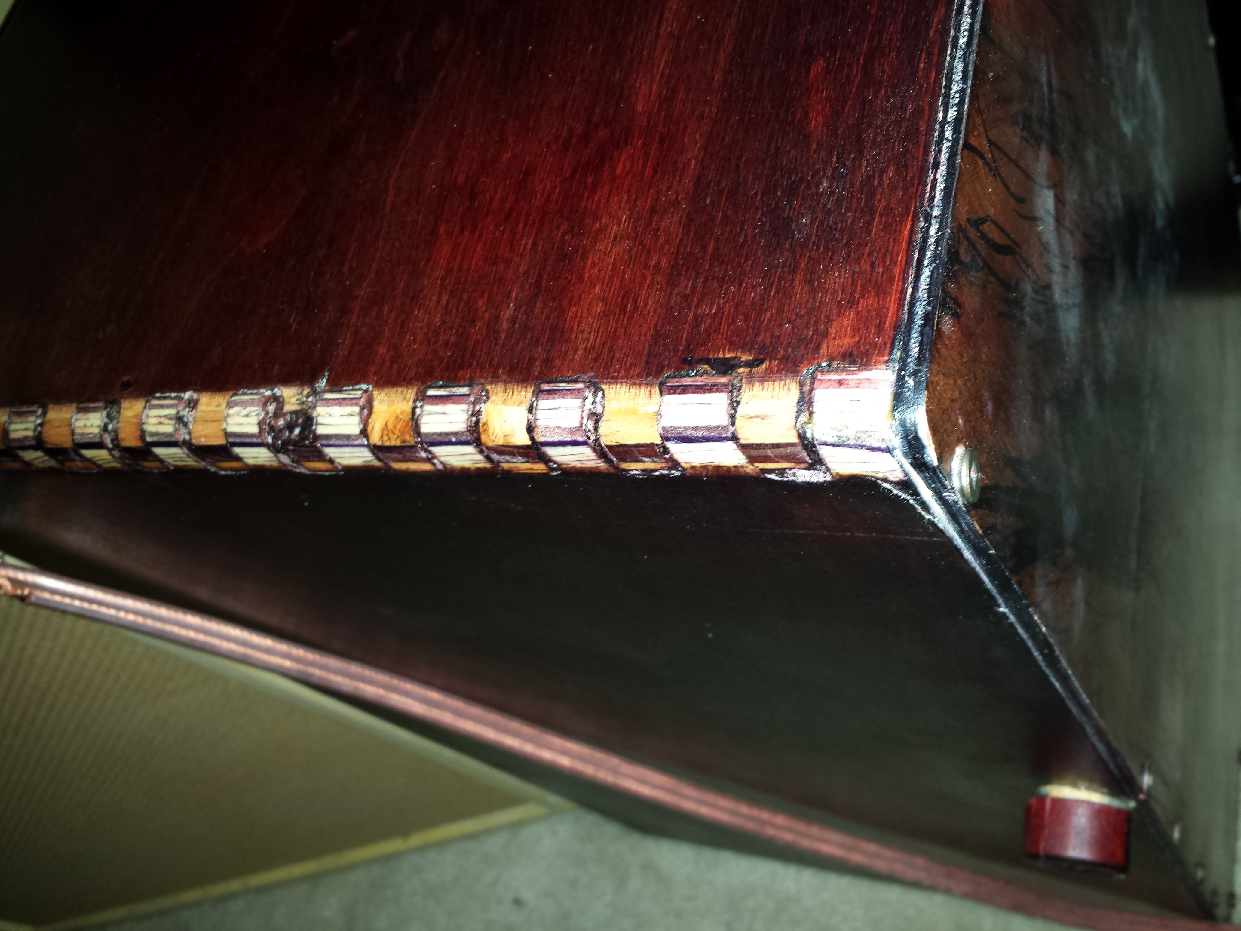

I used finger joints, which stink in plywood, and my jig kept slipping (the epic story is detailed here https://tubeamparchive.com/viewtopic.php?t=25605). So some of the finger joints are all screwy and need to be filled. I glued & screwed a some braces inside to add extra glue surface for strength to make up for the weaker finger joints.
I did all the glue-up with Titebond wood glue instead of epoxy, just easier to deal with. I'll still fill the ruined finger joints and other surface imperfections with wood-flour-thickened epoxy though, that'll adhere way better than any wood filler I can think of.

Anyhow, picture below:
