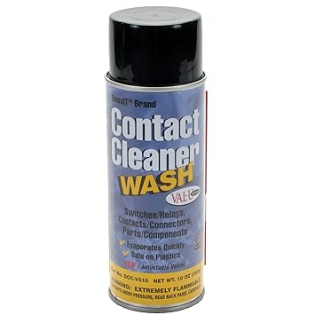

I like this stuff for cleaning pots. But even after adjusting the "variable" nozzle to "low", the smallest shot I can manage is about 10 times as much as I need or want. Anyone else experience this?

Yepper, it's all too common with this type of product. I used to use products like this when I was a Navy electrician - contact cleaner, water displacement sprays, etc. I think I finally just got over the overspray issue, and started hosing equipment down with the stuff. Who knows, maybe there's a niche market for an aerosol attenuator.
Hmmm, I wonder if you could just smash the tube a lil' bit with pliers. I've never tried it, but if you have spare spray tubes, you might give it a shot.
Re: DeOxit BLAST!!!
I already modded the spray tube so I could get a 90-degree angle. Far easier to spray into some pots that way.
Yeah, I think that's a good idea. Mod a spray tube for a finer, smaller aperture.
I'll set up a new web store for spray tube modders. Spraytubegarage.com.

Funny, I just looked once more at the image of the can and noticed "Flushing Action" highlighted on the label. Truth!
P.S. and OBTW: Probably NOT a good idea to smoke while using this product. (Hint: It is also flammable.) :shock: :lol:

Got heat shrink? Superglue? Skinny piece of wire? Here's what I do, with a new, clean plastic "snorkel" spray pipe, park the wire in one end, tiny dot of superglue on the outside of the plastic tube. Slide a little piece of narrow heatshrink over the end with the wire sticking thru. Let the superglue set then heat up the heatshrink. Slide the wire out. Your new aperture will be the wire diameter. Repeat as necessary.
Tried it without glue, and spray pressure blows the HST off the end. :(

Yup, D-5 & F-5 cans, maybe others too, twist the nozzle all the way counterclockwise.
Another mod for the delivery tube: I had a plastic applicator tip from a crazy glue bottle, never did use it. Just jammed this tiny long funnel on the plastic tube, it's got a bend for fitting into pot slots & wherever else AND chokes down the diameter. Friction fit, so far so good.

I went years wasting canned aerosol cleaners and solvents- then my buddy showed me these
http://www.fabricationtoolsandmaterials ... s/aasa.htm
you fill a dispensing bottle with whatever solvent you see fit and the small metal needles get right in there, waste less cleaner/lube and it does a better job, saves the time you spend mopping up the excess cleaner too ;)
I have 3 different de-oxit products in these currently, no issues!
deoxit also sells most of their solvents in non aerosol form as well..
not what you would call cost effective, but if you factor in the waste that happens with the aerosol can you get more bang for your buck.
