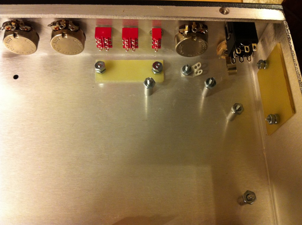

Re: YAOB (yet another one-zero-two build)

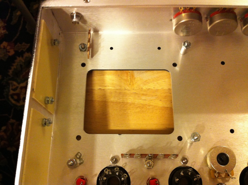

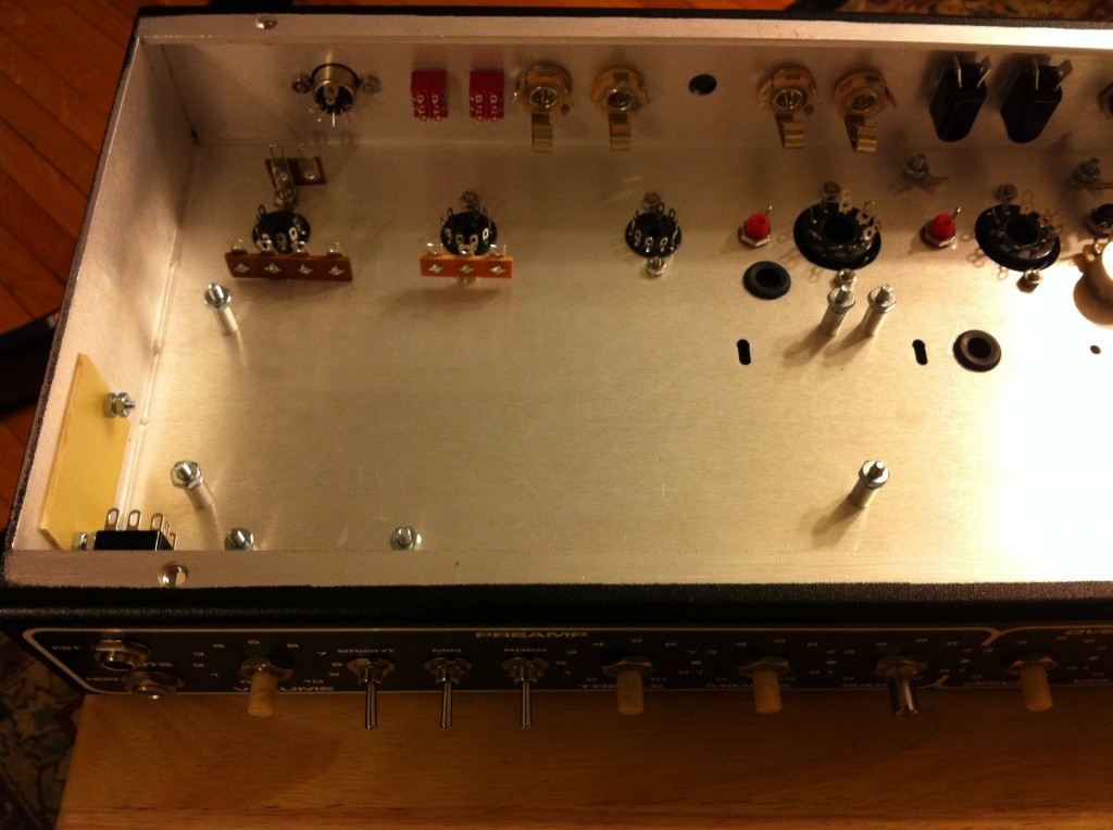

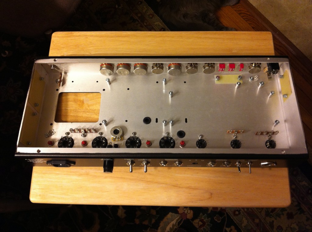

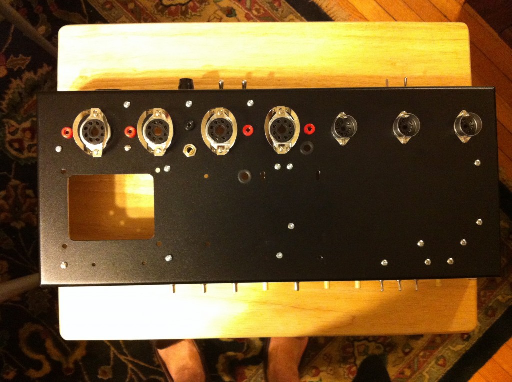

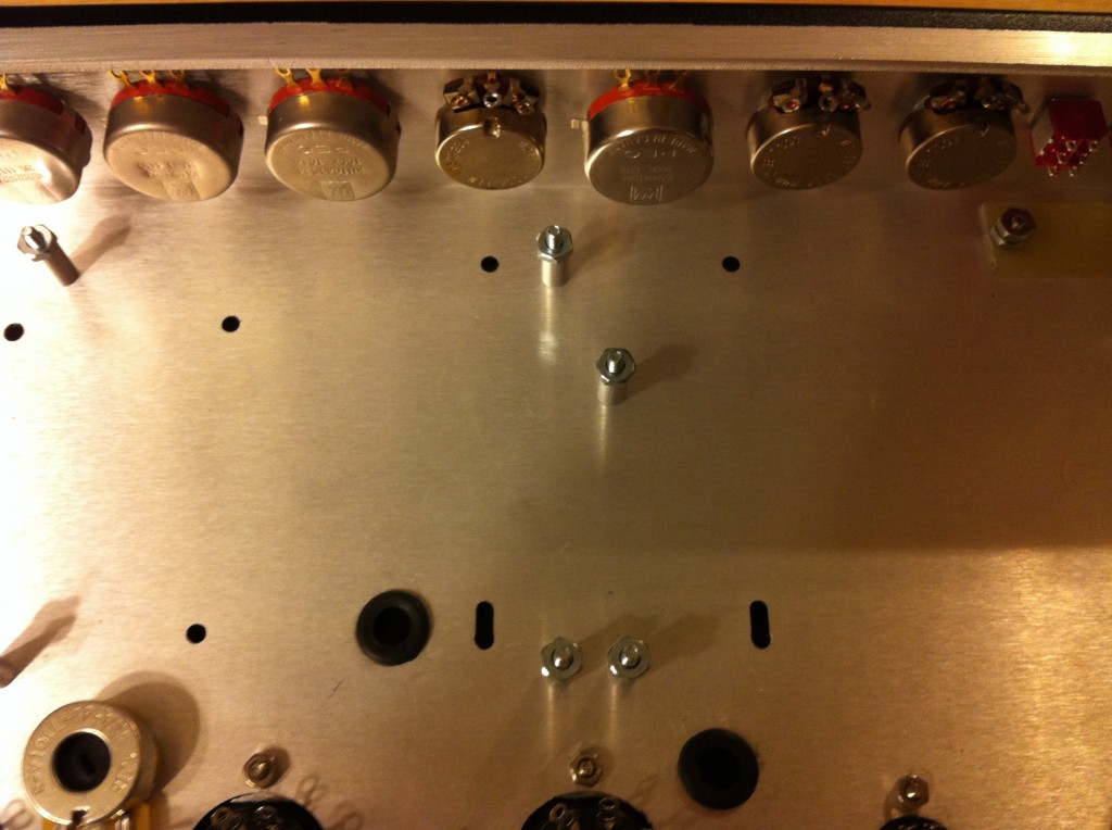

The hardware installation is done. Now off to populate the boards.

BTW: there's no hole for a ground lug for the relay supply in the CE chassis. Where would be a good place to put the relay grounds? Just install a lug on the power transformer bolt?
-Aaron
Yes there is and the relay supply is grounded at the center post of the 3 lug terminal for the regulator. Even with a dedicated relay PT, I've used only those existing holes.aflynt wrote:
-Aaron
TM
Thanks! That makes sense. I was wondering why the center terminal of the regulator was grounded twice on the layouts.ToneMerc wrote:Yes there is and the relay supply is grounded at the center post of the 3 lug terminal for the regulator. Even with a dedicated relay PT, I've used only those existing holes.aflynt wrote:
-Aaron
TM
-Aaron

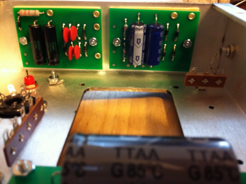

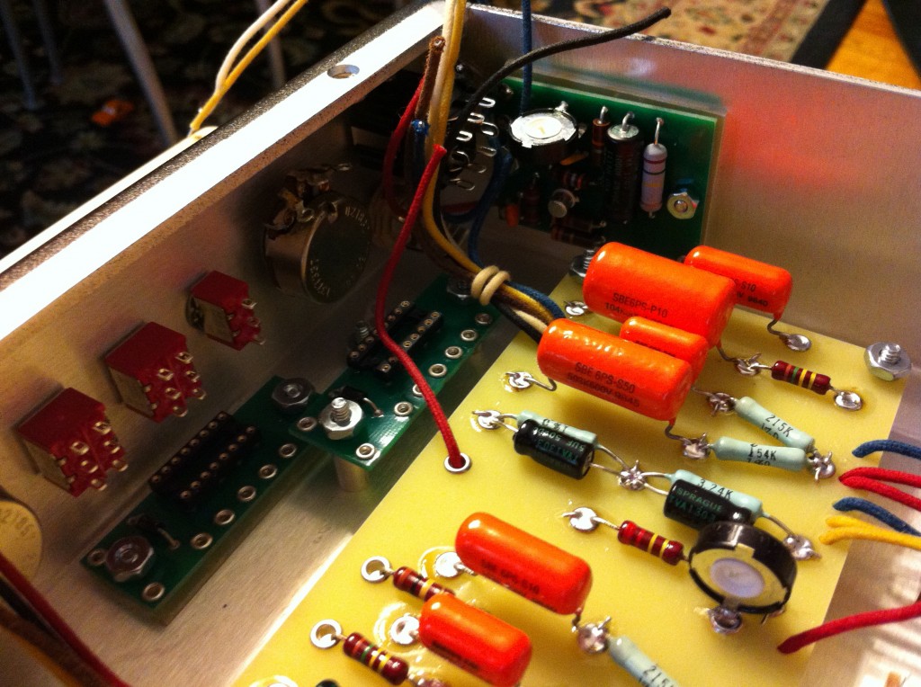

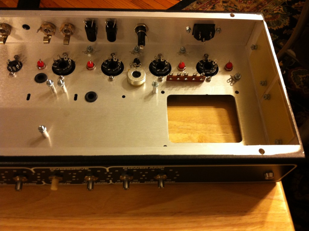

The boards are populated and it's beginning to look more like an amp. In reality I think I'm still pretty close to the beginning of the whole process, though. I've forgotten how tricky eyelets can be. I've gotten spoiled with the pedal builds I've done on fabbed PCBs lately.

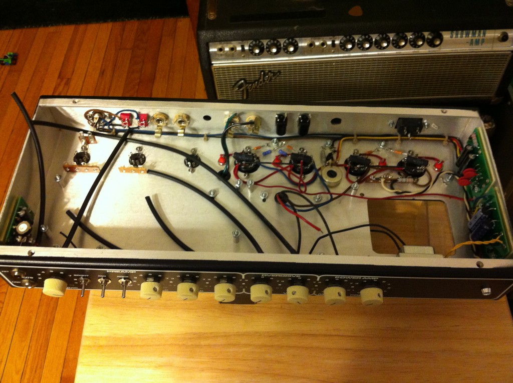

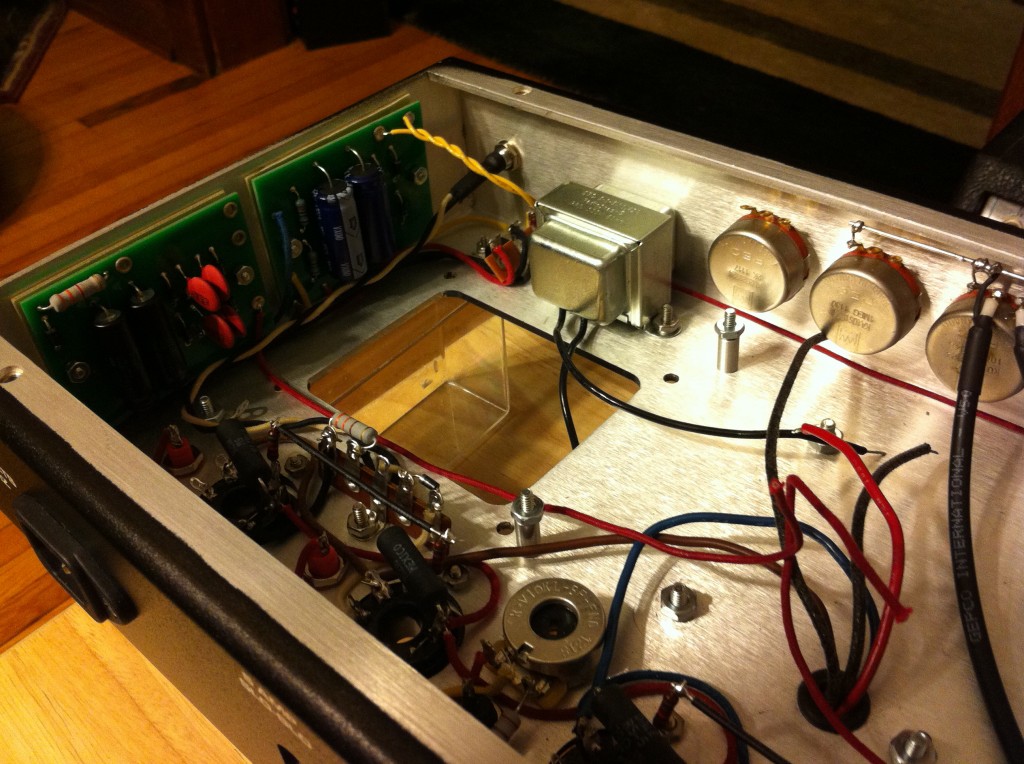

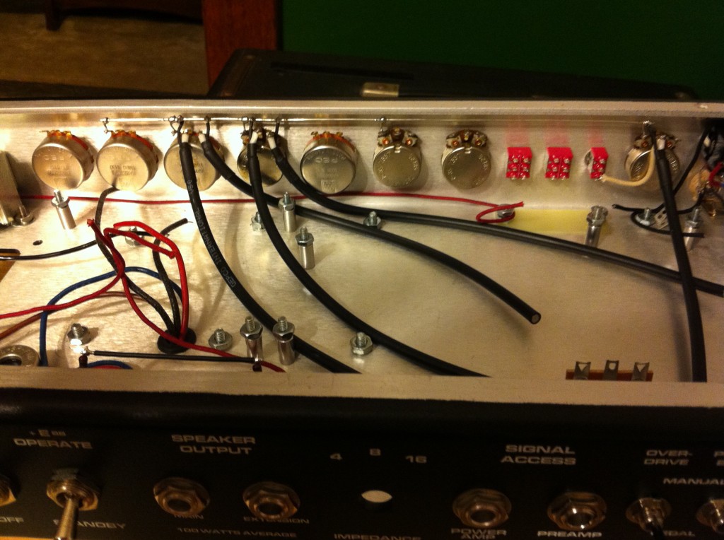

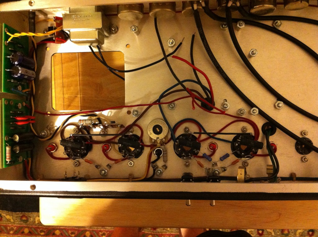

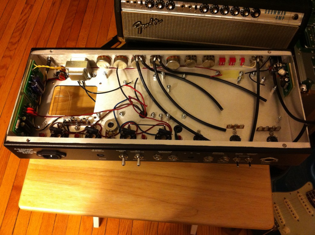

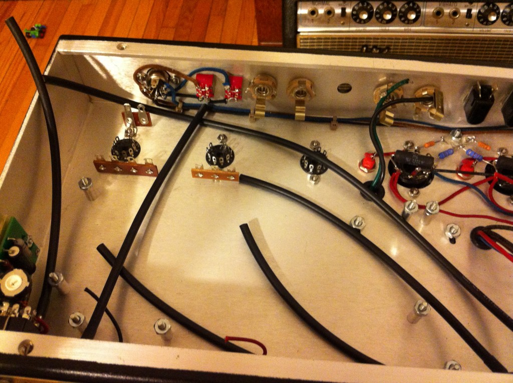

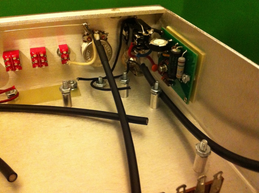

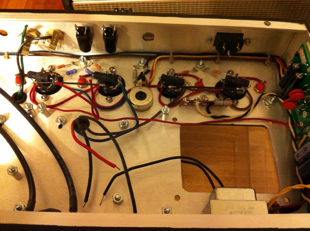

I was out of town for a week so I haven't made as much progress as I would have hoped, but I did get a buch of stuff done yesterday. The relay ps board and bias supply board are wired in as is the indicator lamp. The power tubes are all wired up with OT and choke installed. The foot switch jack and manual switches are wired up. The front bus bar, input jacks, FET board, and all shielded wire is in place.
After some not-so-spectacular results I decided to forego wiring the braid on the shielded wire to the pots and just shrink-tube and run the shield to the bus bar instead. Hopefully that won't induce too much extraneous hum.

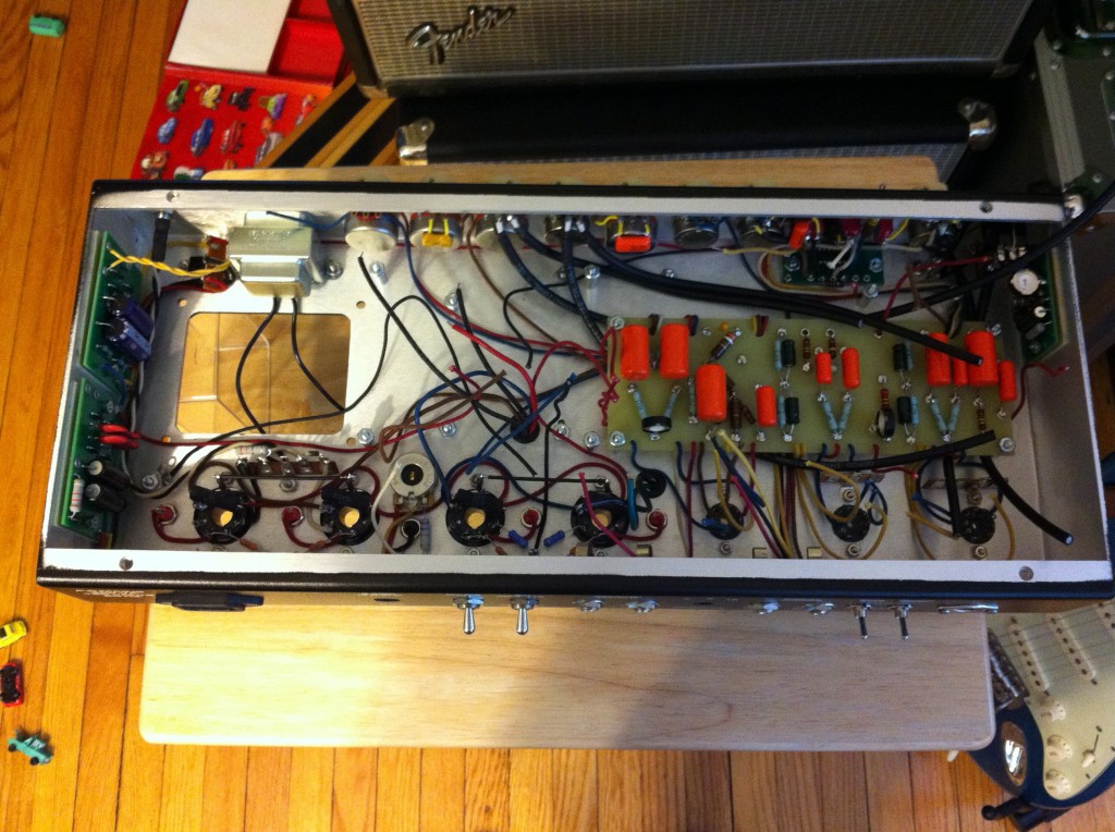

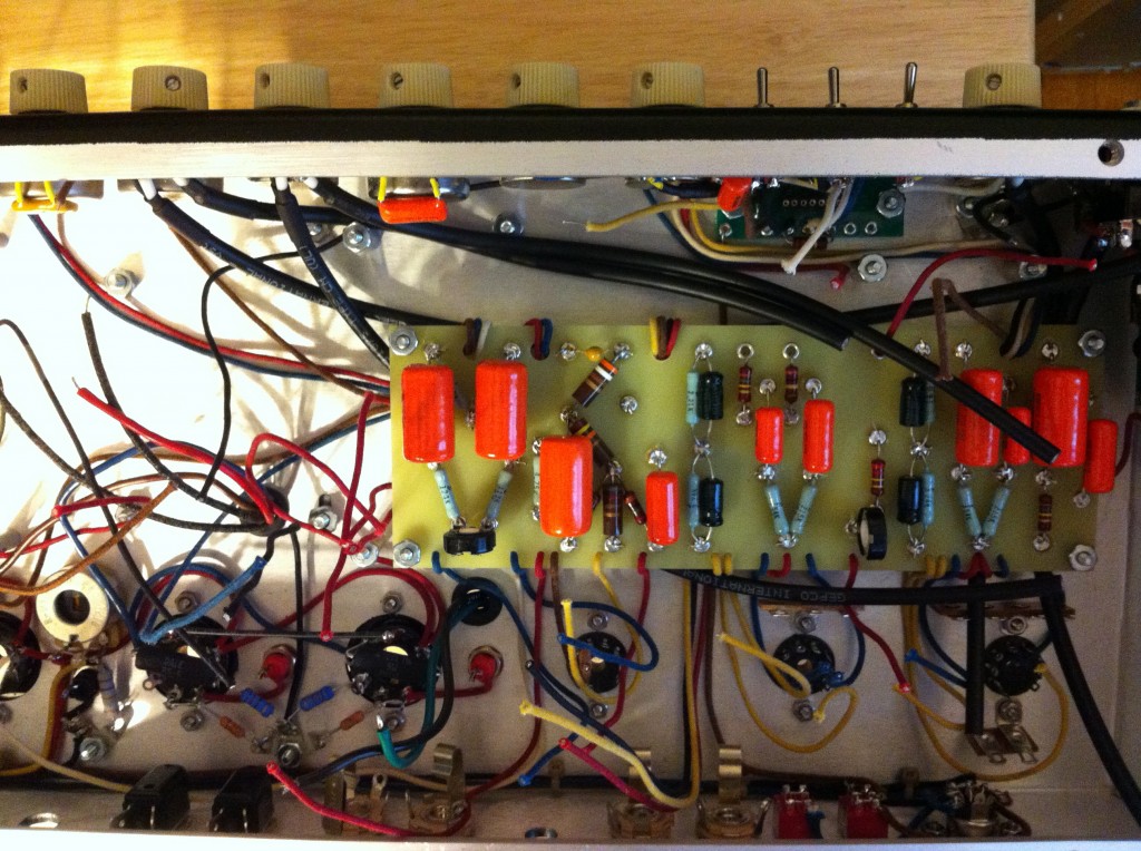

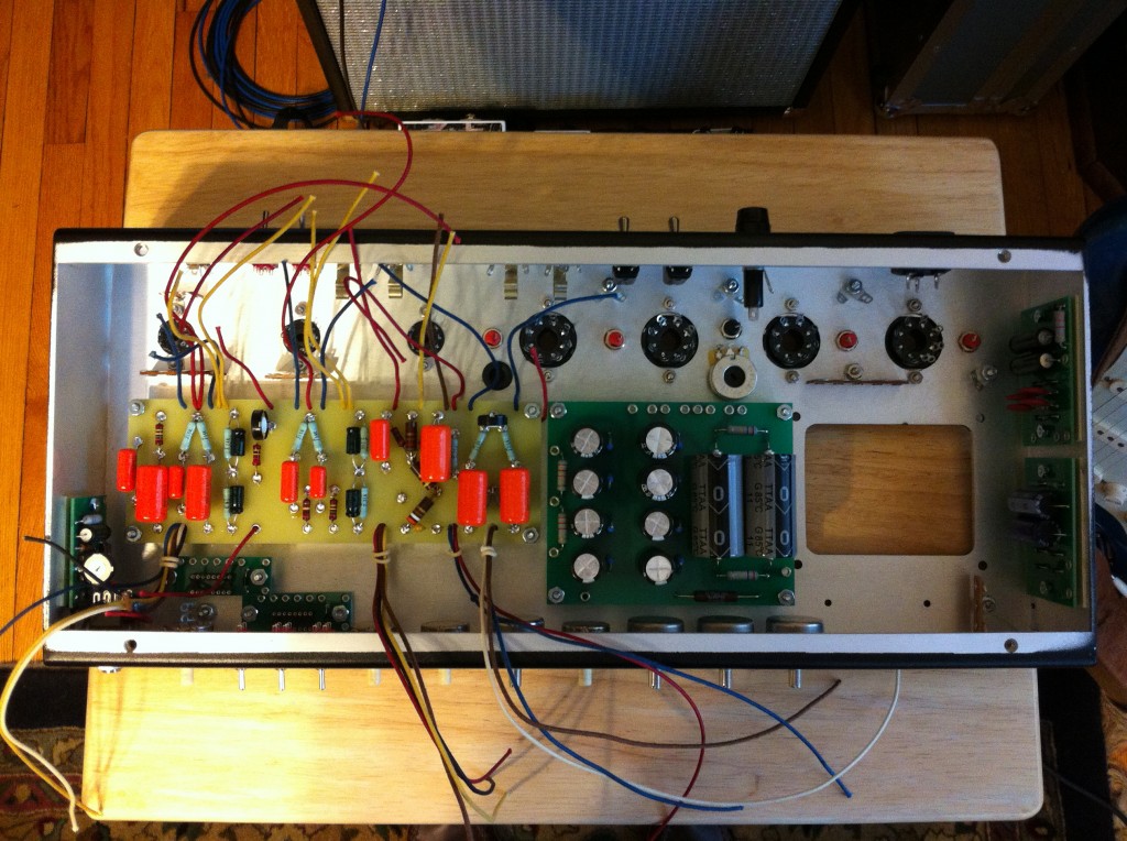

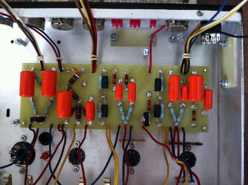

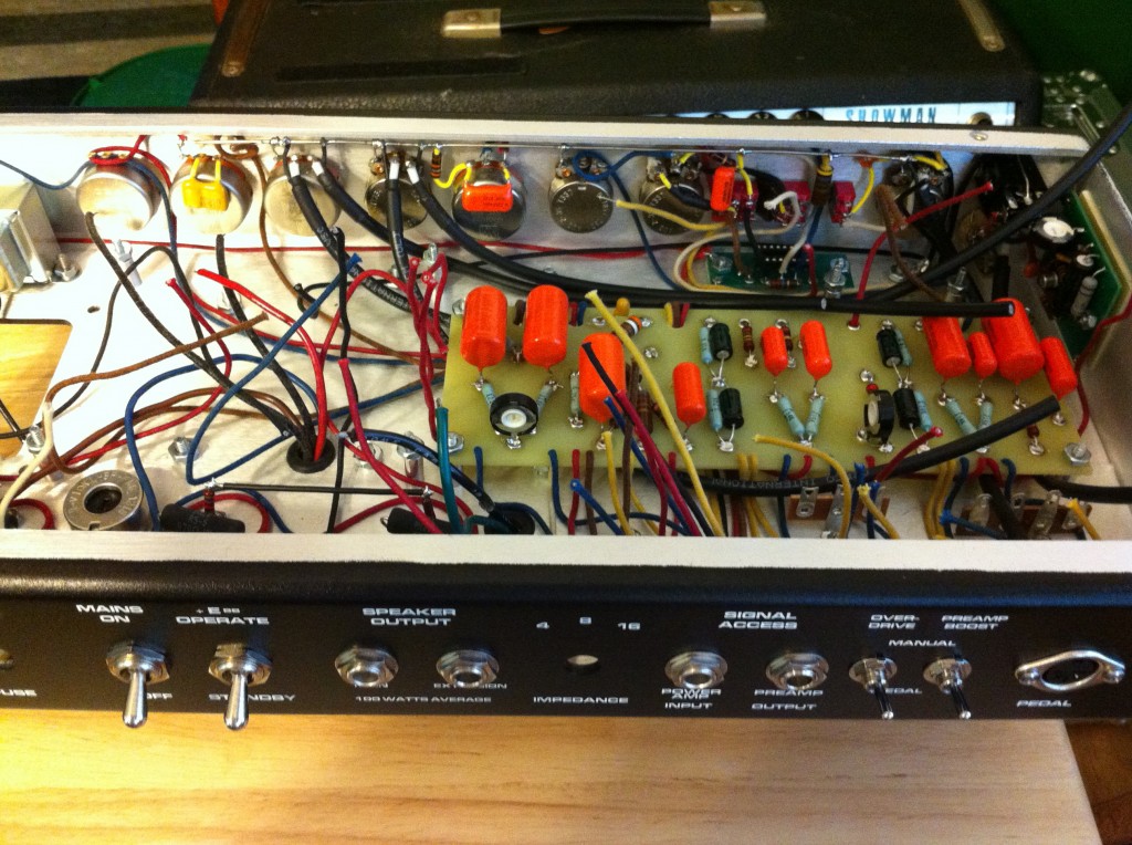

Holy spaghetti Batman! This is going pretty slowly. I think 90% of my time is spent attempting to put leads/components in the right place before soldering though. I'm just going to chalk it up to me being a clumsy oaf. When it takes 8 tries to install a nut and washer you know you're less than graceful.
Anyway... I've mostly got the front panel wired up now and am now moving on to wiring in the preamp board.

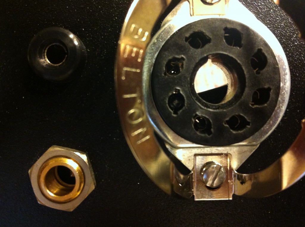

Ugh!!! Power tube socket solder blob. I'm hoping I can get this out somehow.
