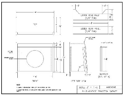

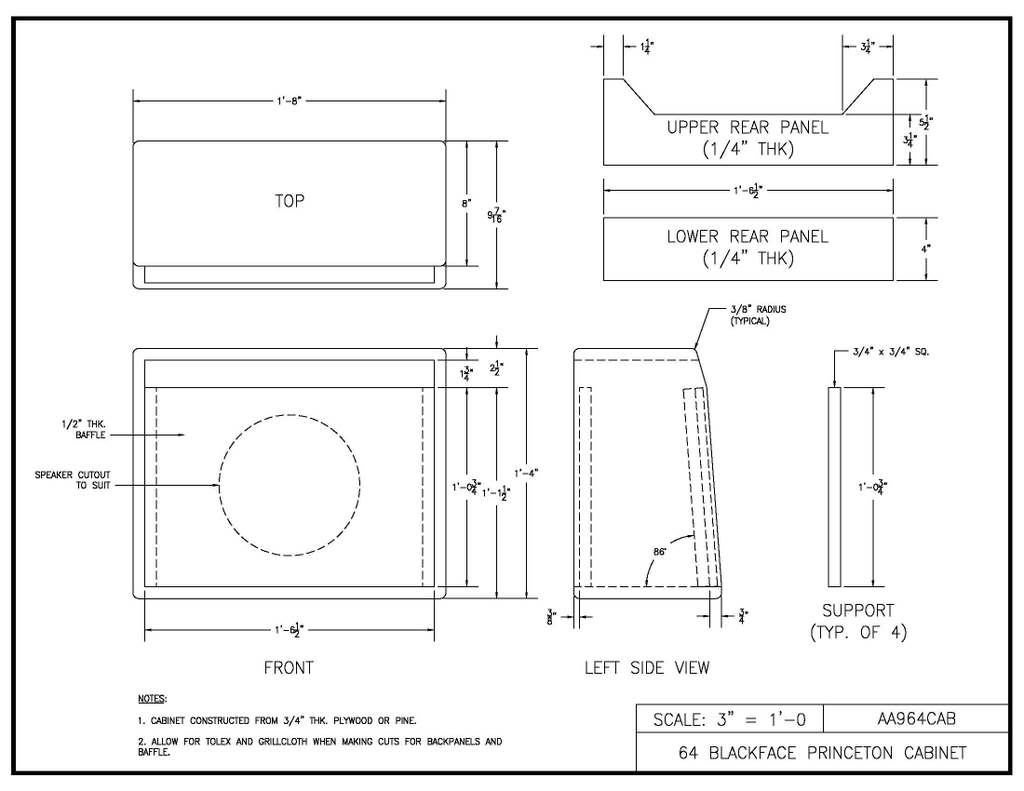

The Tremolux is slighter longer then the BF Bassman chassis.
I have attached the BF Princeton cab plan that you can go by but should increase the height to allow for 12" speaker and clear the output transformer.
Re: rehousing a 62' Tremolux in a combo cabinet
Yep, definitely check the transformer clearance to speaker before you cut any boards.

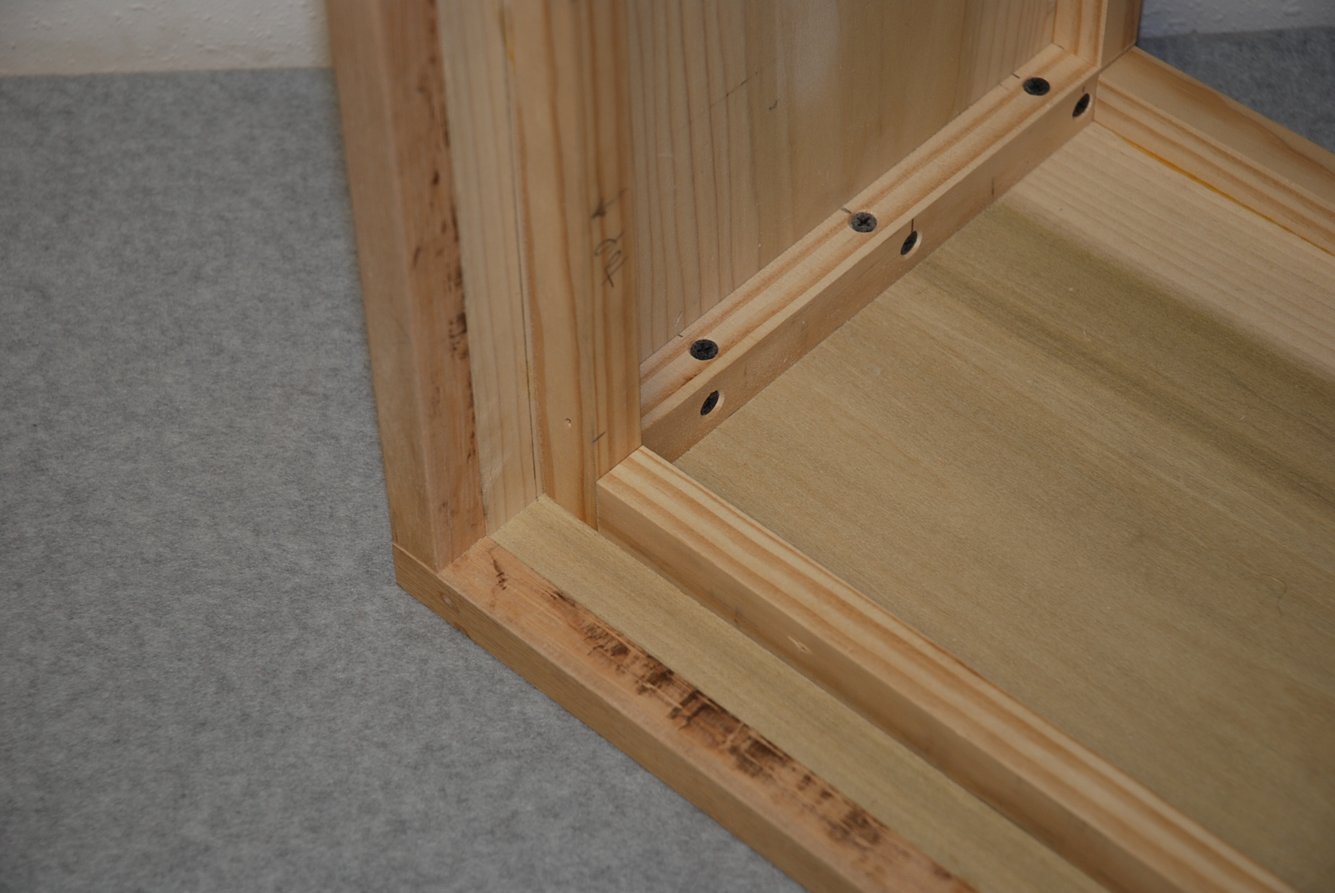

For ease of construction I would use the butt joint as Structo mentioned.

Geeze wrote:You report you liked the Marshall 4x10 cab - FYI the Marshall 'Sound' is more the amp than the speakers. Find out what speakers were in the 4x10 - this would be a good place to start. If you loved the sound I doubt there is a good reason for changing the transformers.
Thanks for the reinforced butt join pic. I might go for that at first. How do you attach the pieces of wood required to attach the speaker panel? Glue? screws from the outside ?
Thanks in advance
add4
Posts: 7
Joined: Fri Jan 10, 2014 4:04 pm
Post by add4 »
Also aren't the reinforcements on the upper panel taking the chassis position on the corners?
