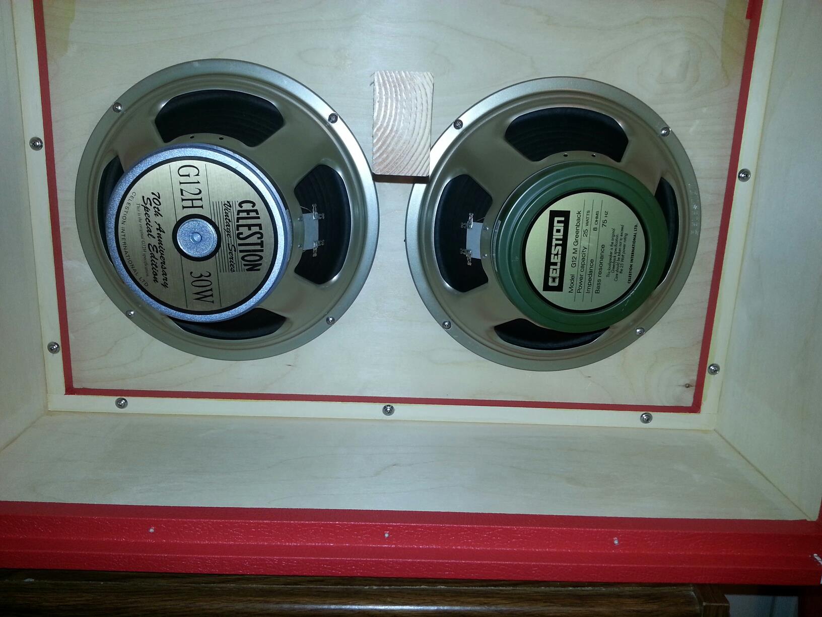

Well Ill break the ice on this one.The coolest experience I had last year was building a 2x12 maple cab and using a alnico blue and a greenback together.Never tried it before and it really sounded cool.I want to get 2 scumbacks next in a cab Im doing now.I like having removable back panal sections as well.You get to have a choice on how much you want open.
Speaker cabs really can make a amp change in a big way.The depth of a cab in the 2x12 produce more base and bottom.I have a recto cab that really takes marshall well.I think that cab is about 14" deep.Mike

My go-to cab for the past few years is also affordable. I bought an unloaded Avatar 2x12 (convertible, but I have it closed), and put in an Eminence Man-o-War and an Eminence Texas Heat. I love this cab for rock at full volume, and for playing quietly at home. Now nothing else sounds right. Not to say nothing else sounds good; I have a Celestion Blue in an open-backed pine cab that's awesome. But my Avatar has become the baseline for everything else.

Mikey I mixed up the same pair, Celestion Alnico blue with Celestion 25w green back. But then I got a Gold and paired that with the blue. The other blue is paired with Celestion 12H.

I bet the Gold and the Blue together was killer.!!!

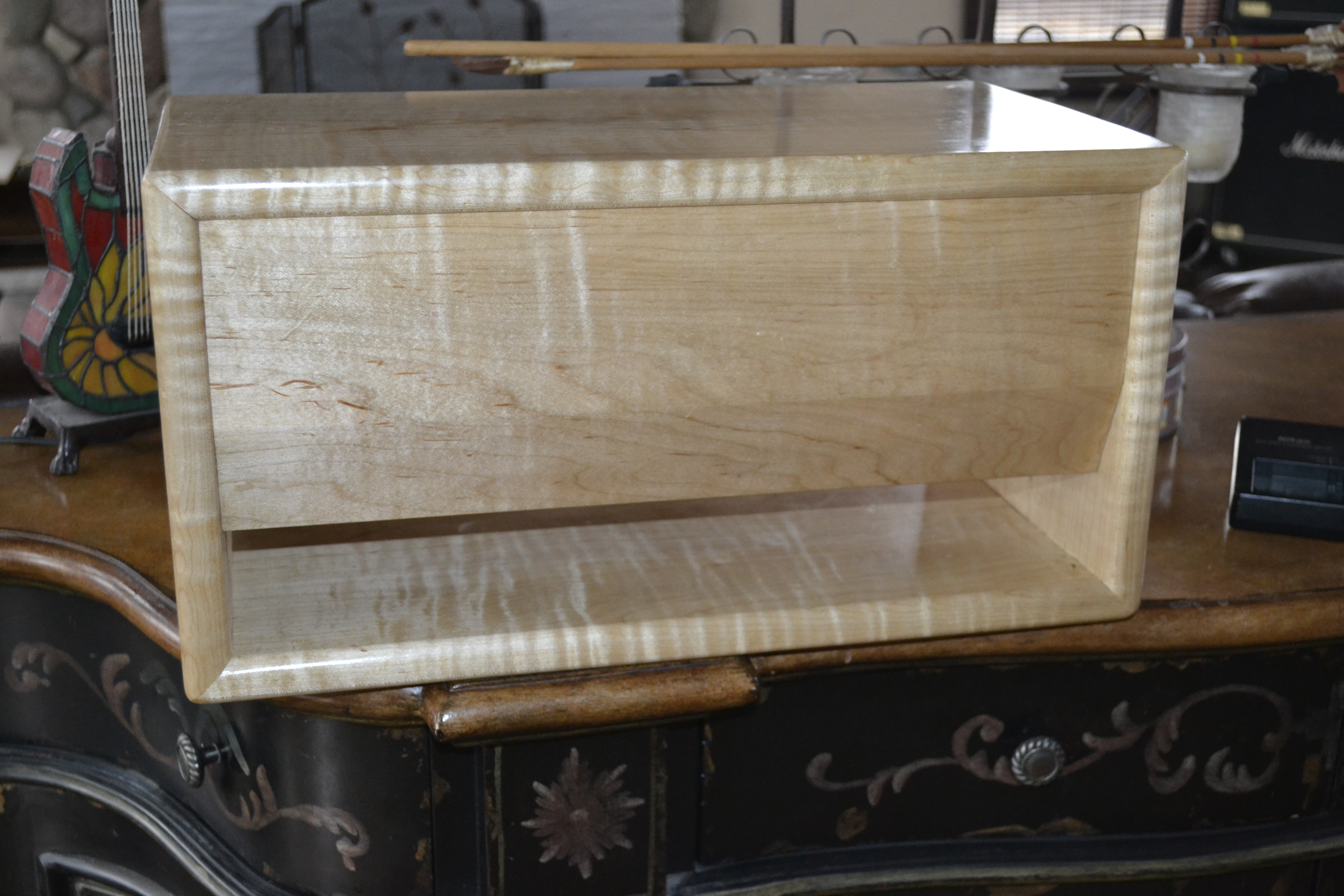

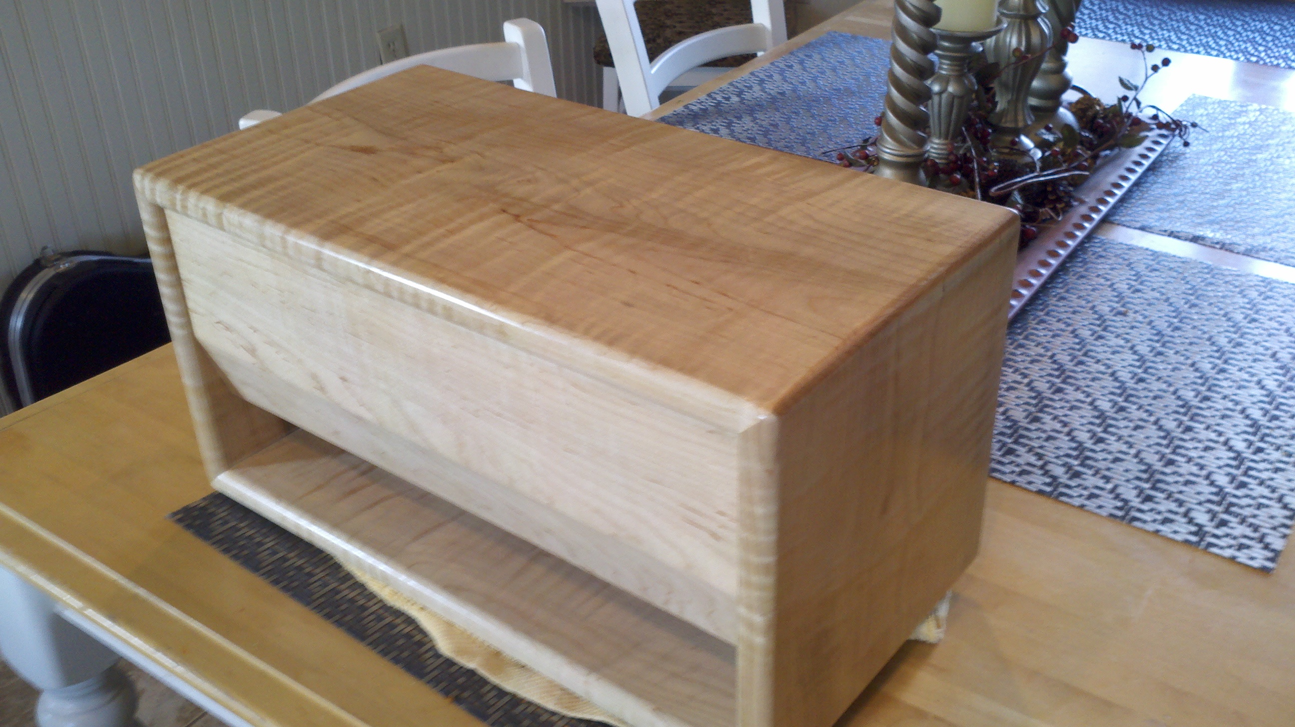

Today I started to put finish a natural maple for my buddy Bob.No dye just the pure maple.Little by little the figure comes to life with the oil.Gosh I love wood!!!!!!!!

Mike - that cab is Stunning!
Mikey's cabs force me to build better amps.
Anything that looks that good, has to sound great too.
Great Work Mike - you've got skills brother!

Very nice Mikey it's a lot like the one you built for me buddy.

Wow, that is gorgeous Mikey! :D

Sweet cab.Is that miter jointed? Do you use Biscuits or something else to reenforce it.

Here's one of my favorite speaker combinations.
Celestian vintage 30 and a Celestian Greenback.

I Likey!!!!!!I dont think I would ever put the same two speakers together after the one I built for my buddy.I bet the V30 and the greenback is killer.Im going to try to do that soon.Thanks Mikey

In reply to the cab I use beech tendons in the miters ,they are from a festool domino tool.Cant get anything as strong as this.Biscuits just line things up but really dont add strength.They will never come apart with this system.Mikey
