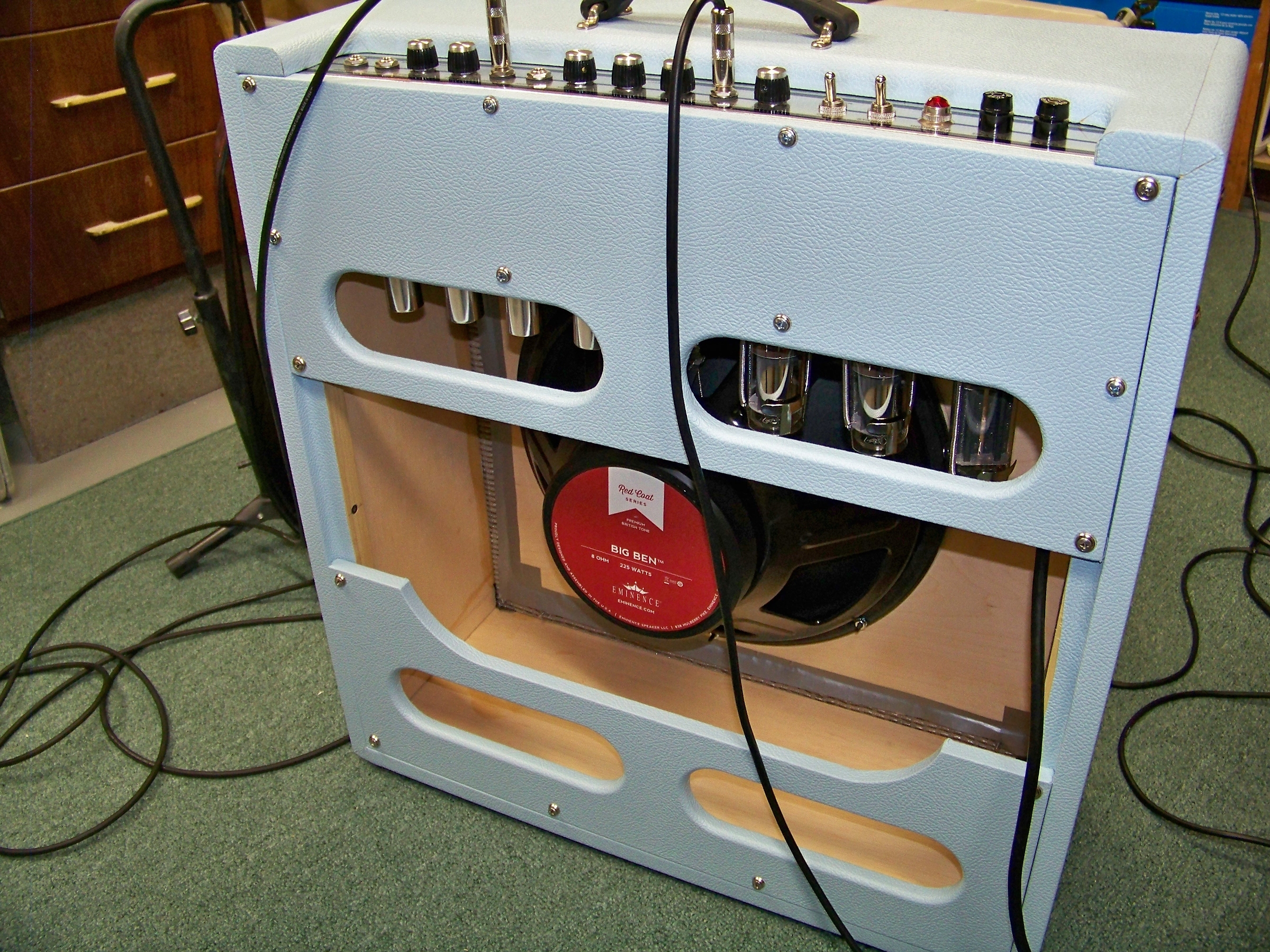

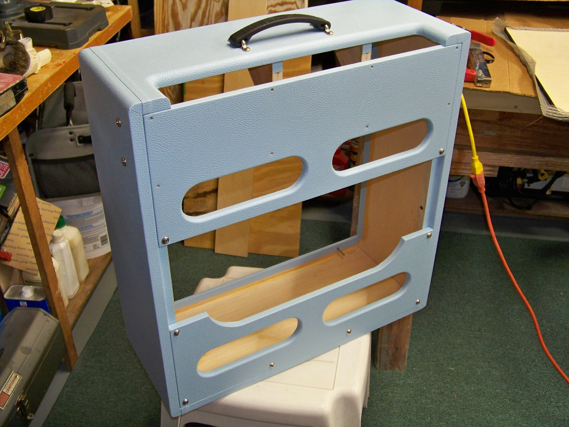

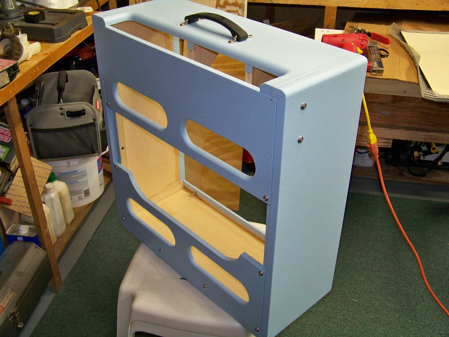

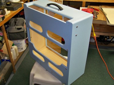

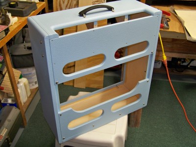

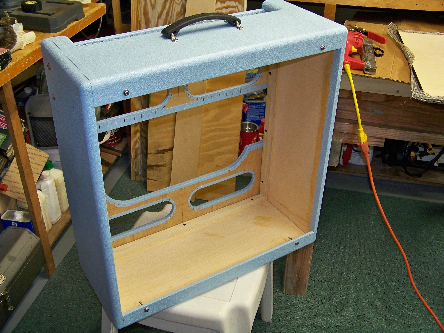

I have always thought the Fender Narrow Panel style cabs were very cool. Thought I'd use this design as a cab for a Supro 1688TN build. I was thinking all ash, with a natural finish, but my local hardwoods dealer had very little to choose from. So I went with plywood, 3/4" for the cab using blind rabbet joints with Gorilla glue, and 1/2" for the speaker and rear baffles. Covered in a baby blue tolex adhered with Weldwood original contact cement and some hefty ventilation. It will house a Eminence 15" Big Ben speaker.
I've had it assembled prior to covering it and it sounded pretty good. The cleans are - well... clean - and as the volume is brought up the distortion becomes chewy. No metal with this amp, but electric blues to hard rock very doable - what I was aiming for.

Very nice work!! That looks really sharp.

Love the color! I've moved the thread to the speakers and cabinets subforum.

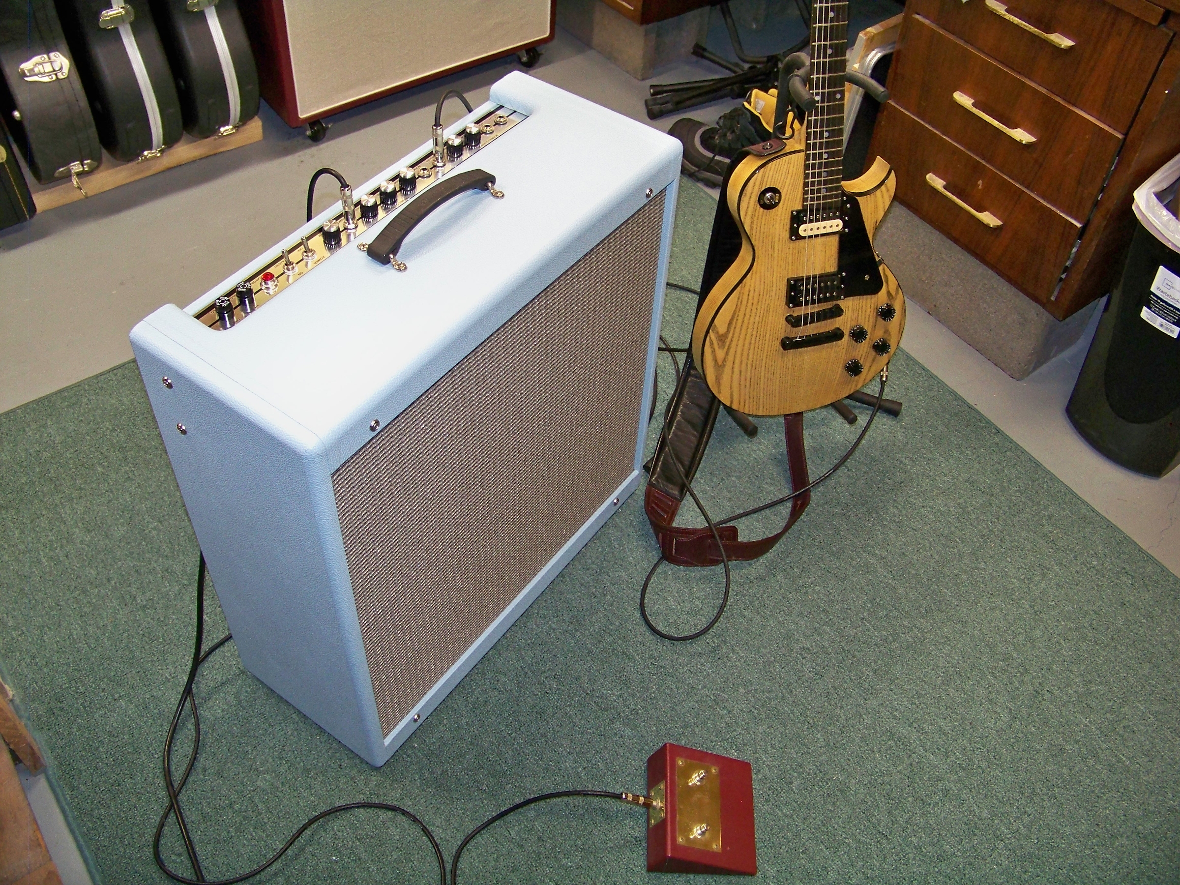

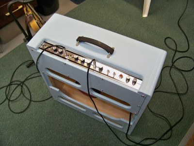

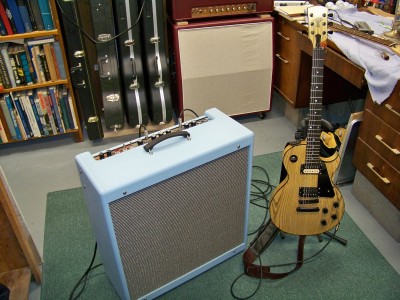

Here it is assembled. I am chasing down some intermittent hash that has emerged in the normal channel. If I were to build this again, I'd skip the normal channel and add in reverb.
And if you use this grillcloth from AES https://www.tubesandmore.com/products/g ... ite/Silver be careful when cutting it to size. The wire shards are like razor blades. I wondered why the cloth was turning red....
