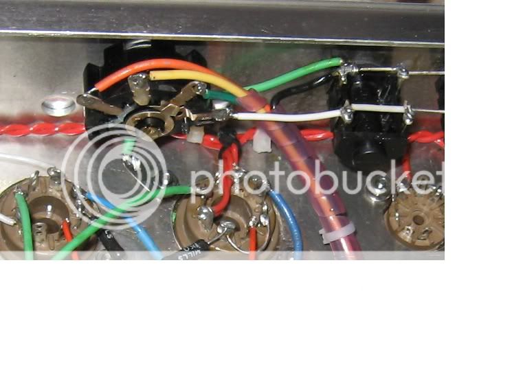

Alexo wrote:
FWIW, I've found that it makes pretty much zero difference where you ground the speaker jack, just go for the shortest wire run.
I agree. In this amp, I just ran a short wire to a solder lug on the nearest power tube mounting bolt:
[IMG:761:571]http://i514.photobucket.com/albums/t346 ... arygnd.jpg[/img]
