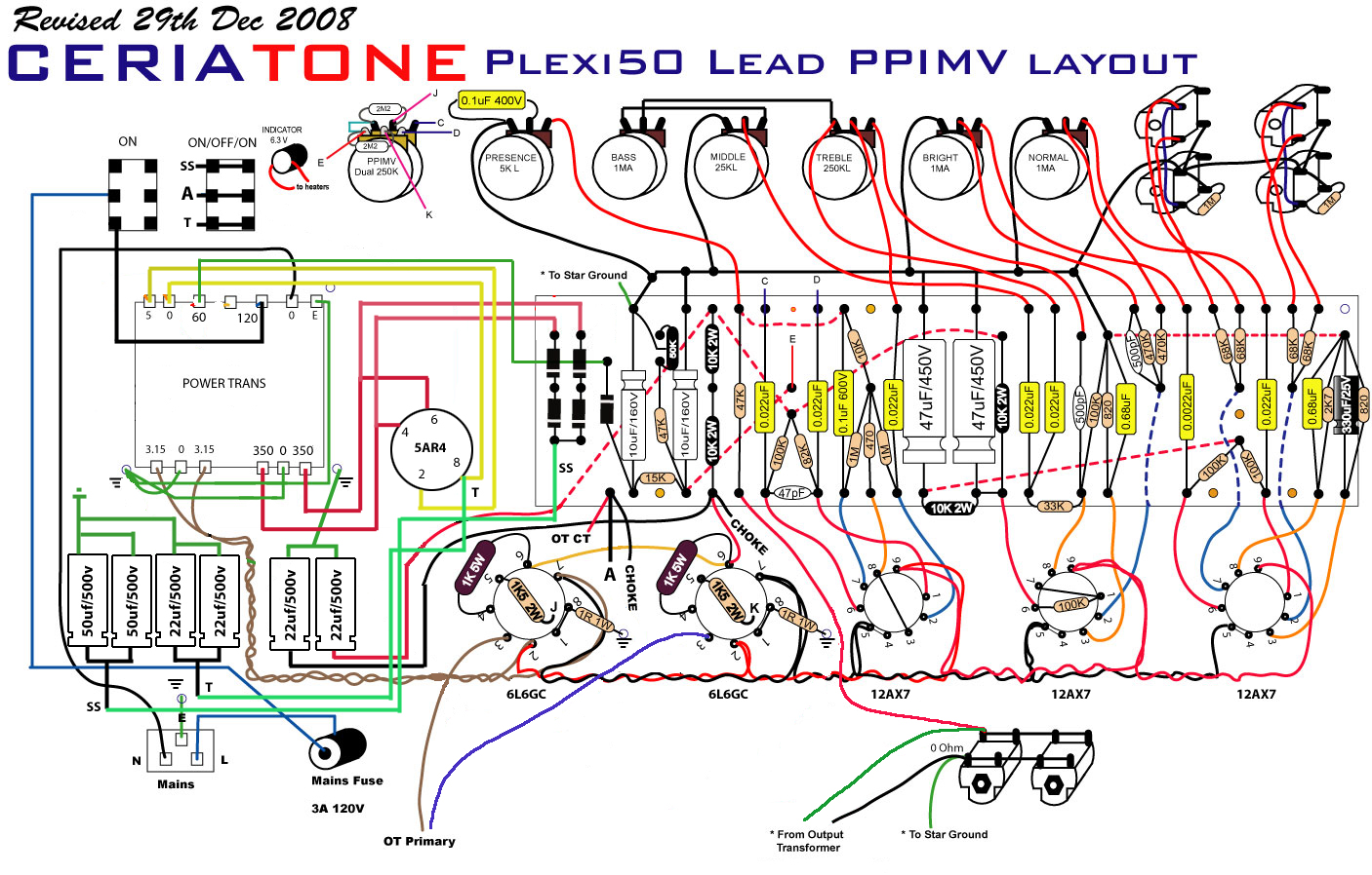

I started with the Ceriatone layout and made some changes. I'm going dual rectifier with switching and reservoir caps for each rectifier. I also removed the voltage and impedance selectors. I'll be using 6L6GC and 12AX7 tubes with a 5AR4 rectifier.
[IMG:1406:898]http://www.crenshawweb.com/plexi50/plexi50mod2.jpg[/img]

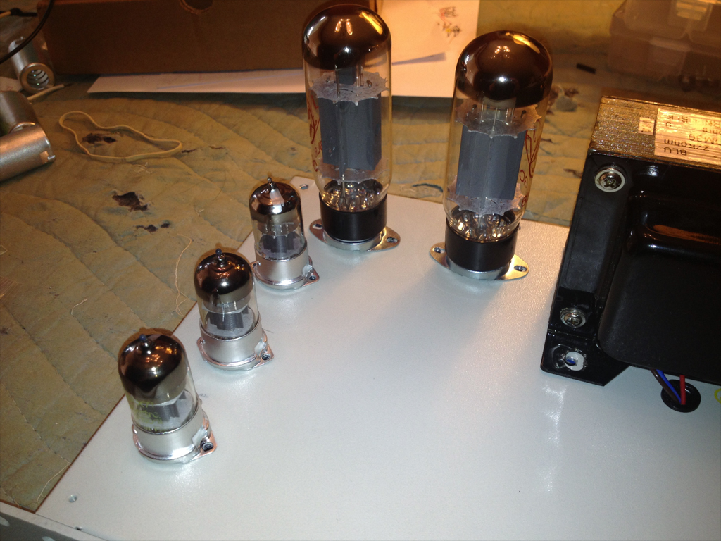

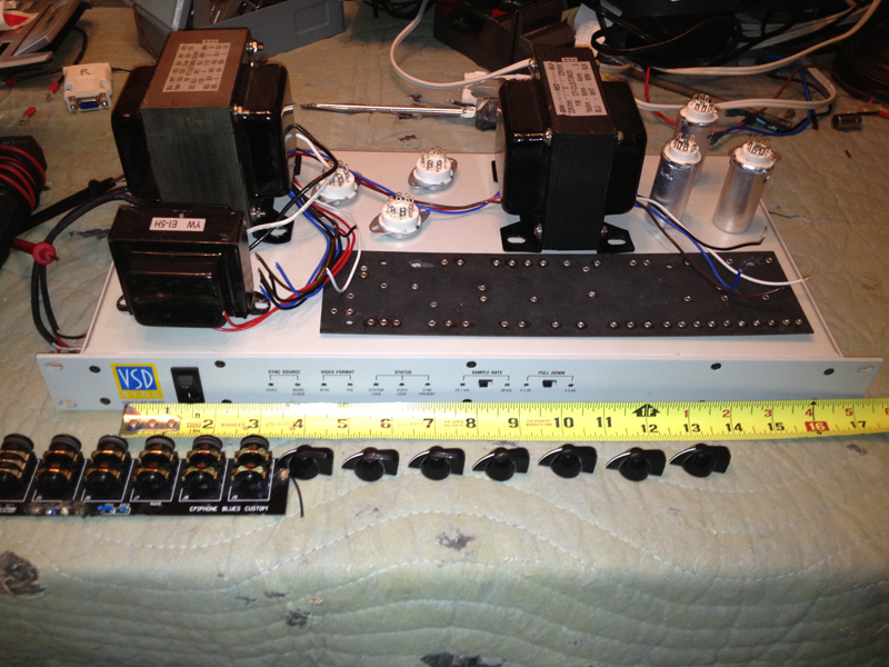

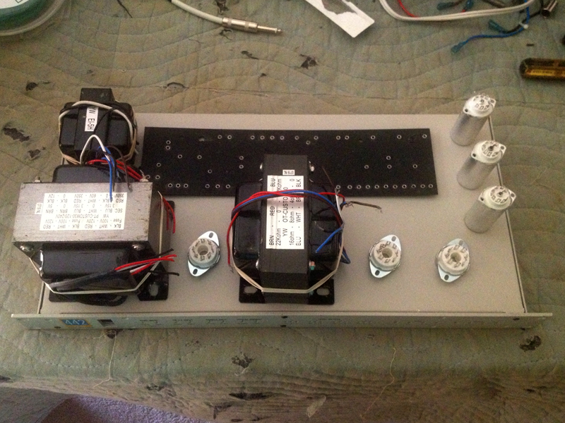

Looks like I'll have just enough room for the 4 inputs, 7 chicken heads, pilot and 2 switches. (power and tube/standby/solid state). I'm not sure about the layout. I want to get the pre tubes as far as possible from the OT.

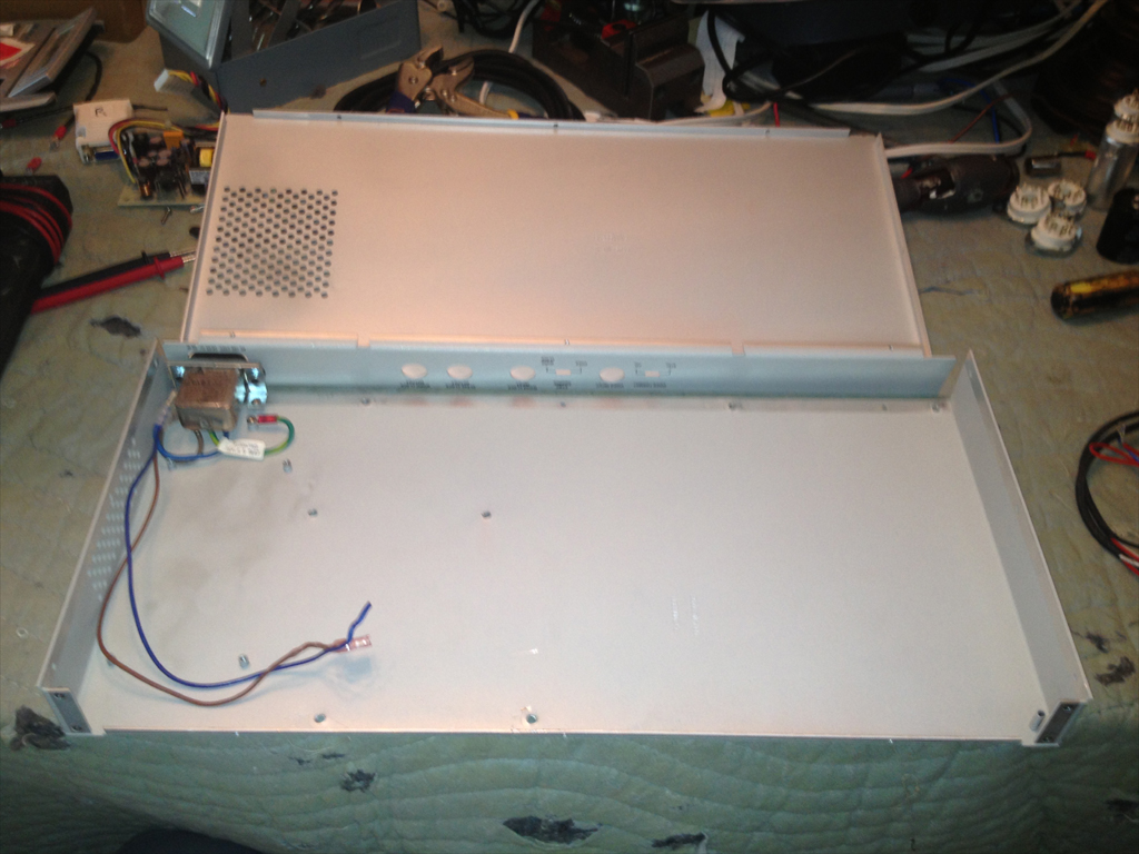

Both small parts orders shipped same day so I might have parts by the weekend. If not, I have work to do on the chassis first anyway. I picked up some step bits at HF last night to get socket holes cut.
I finally found a bit that would remove the security screws on the front panel and was able to strip the chassis. I'll pick up a small sheet of aluminum and get started on machining the new face plate. I might make one to cover the holes on the back as well. I think I'll paint the entire chassis silver metallic. I have some DupliColor Candy base left over from my Strat builds. I'll use water slide for the input and pot labels.

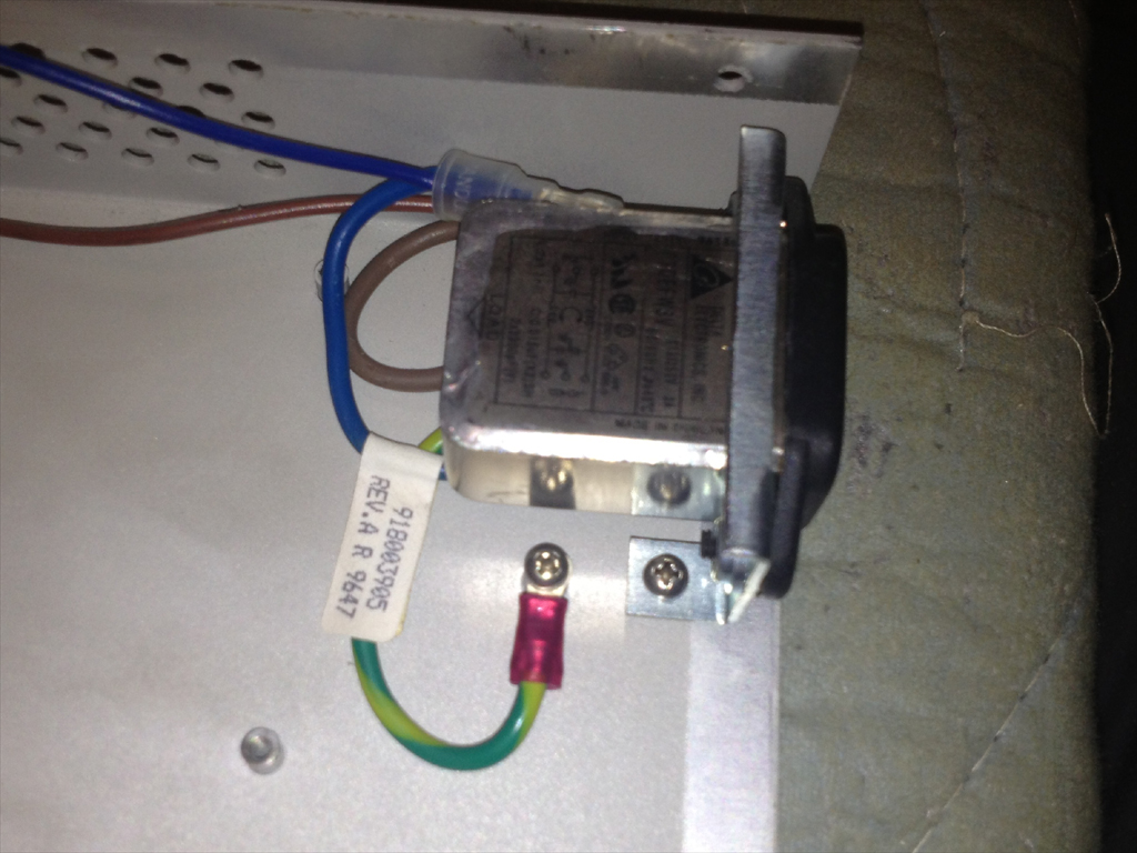

Here's the cool AC socket. It's already grounded to the chassis and appears to be well mounted.

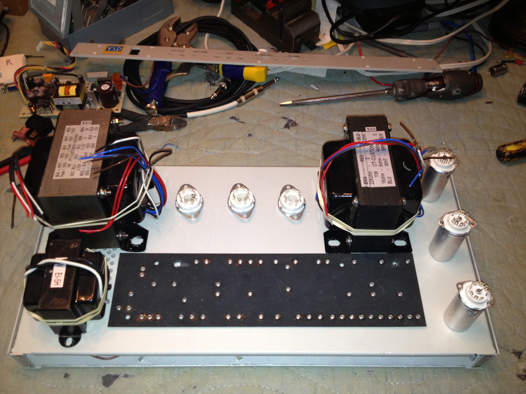

I came up with another layout that gets each set of tubes back in a straight line. Still not sure what I'm going to do on the layout.
[IMG:1024:768]http://www.crenshawweb.com/plexi50/build07.jpg[/img]

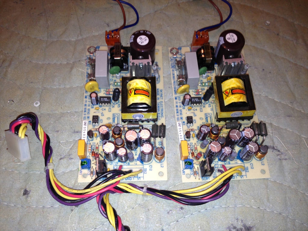

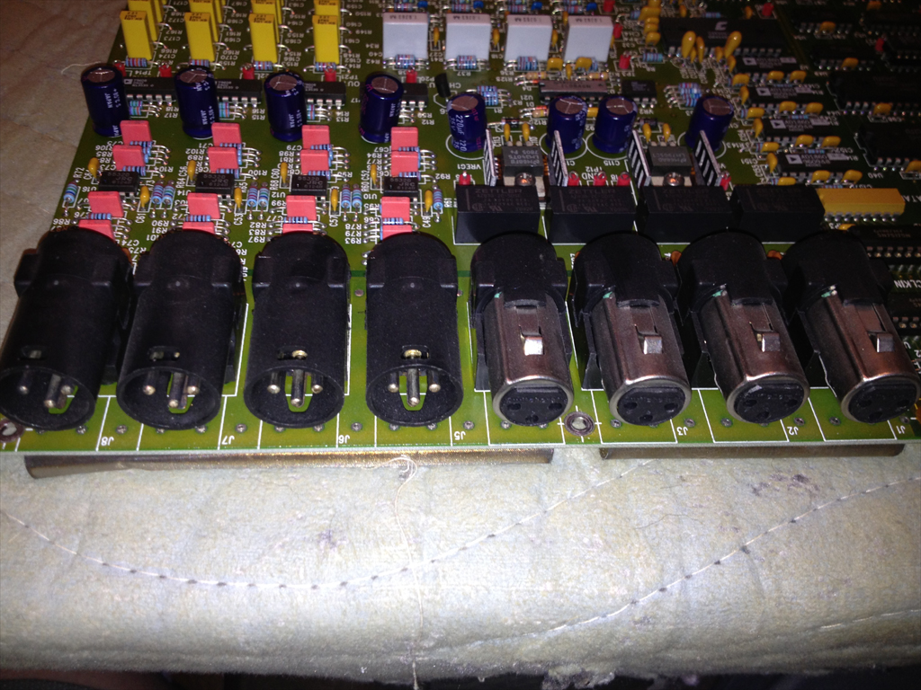

I stripped two of the chassis and saved the power supplies. Will definitely come in handy for projects down the road. I'm not sure if they're AC or DC. There are some healthy sized diodes on the boards so I'm guessing DC. They're only marked V1, V2 and V3. I'll have to power them up and meter them.
[IMG:1024:768]http://www.crenshawweb.com/plexi50/build08.jpg[/img]
I'll also save the PCB mount XLR amd BNC connectors as well as several banks of trimmers.

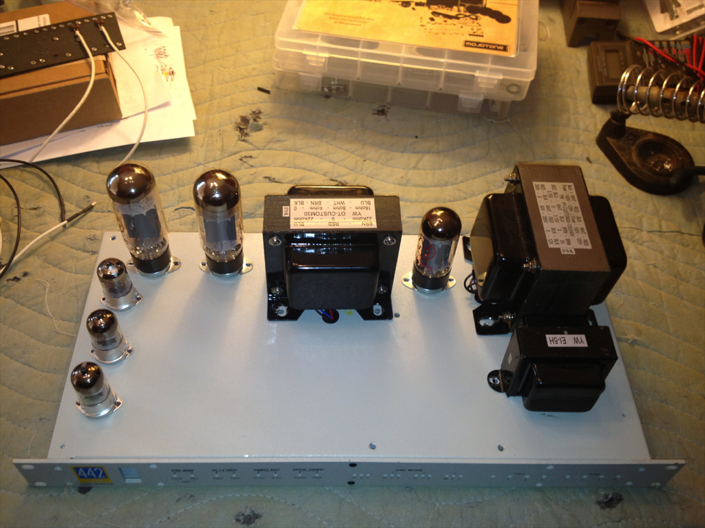

Latest layout. Seems workable except for changing the rectifier tube. It gives me about as much distance as I'm going to get between OT and pre tubes.
[IMG:800:600]http://www.crenshawweb.com/plexi50/build10.jpg[/img]

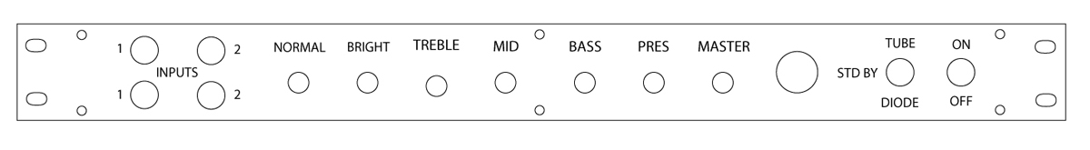

Face plate layout.
[IMG:1200:165]http://www.crenshawweb.com/plexi50/face_plate.jpg[/img]

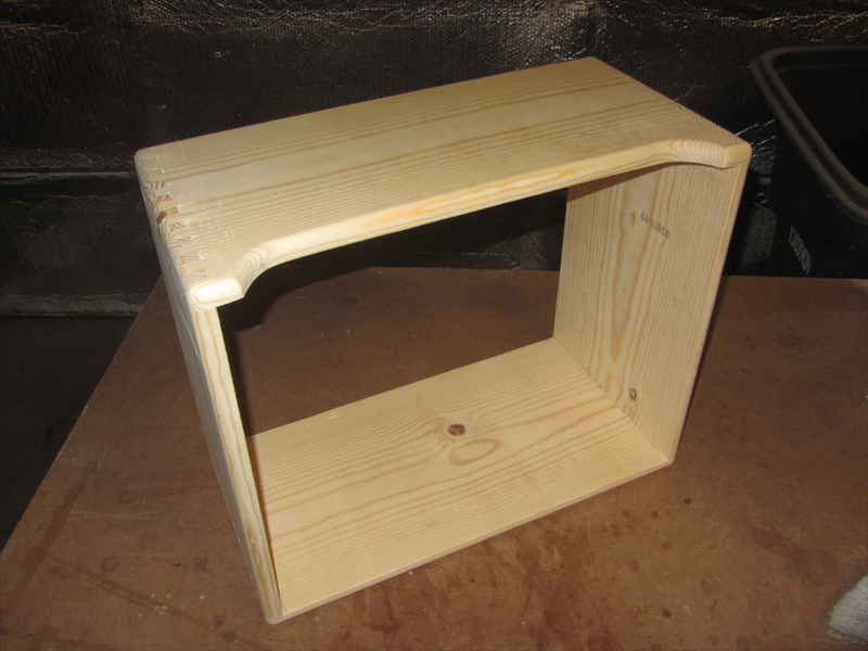

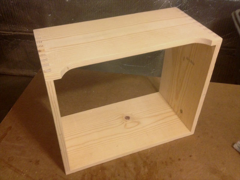

I got the cab cur and glued up.

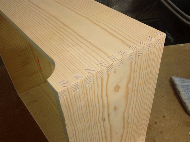

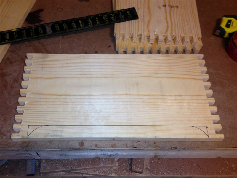

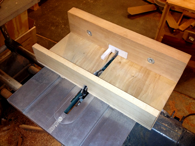

I used the box joint jig that I made during my Bassman build. It's really easy to use and it dials in very quickly. So far I've been getting great results with it. Here it is set up on my trusty Shopsmith. I was looking for a dado table insert and found an entire table on eBay for less than what most were paying for the insert...it's all in the timing I guess. Now I just swap out tables instead of inserts. :cool:
[IMG:800:600]http://www.crenshawweb.com/plexi50/build14.jpg[/img]

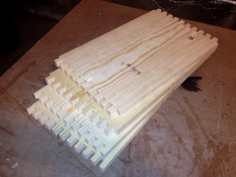

Box joints cut and ready for a dry fit.
[IMG:800:600]http://www.crenshawweb.com/plexi50/build15.jpg[/img]

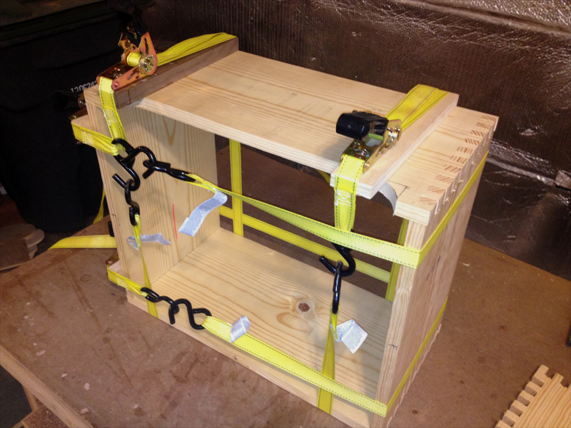

[IMG:800:600]http://www.crenshawweb.com/plexi50/build17.jpg[/img]

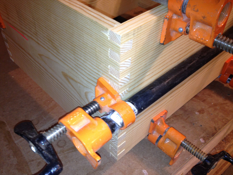

Then I cut the recess for the chassis.
[IMG:800:600]http://www.crenshawweb.com/plexi50/build18.jpg[/img]
All glued up. I'll get the round overs, cleats and baffle done tomorrow.
[IMG:800:600]http://www.crenshawweb.com/plexi50/build19.jpg[/img]

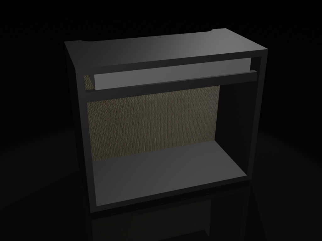

I finished up the pre-vis this morning. I added the front bezel so I could use a piece of grill cloth I have in hand...it's only 12" tall.
Now, I just have to build it. :shock:
[IMG:1024:768]http://www.crenshawweb.com/plexi50/cab3.jpg[/img]

Nice re-purposing going on here. I'm confused by the markings on the OT saying that the primaries are 22k? That doesn't make sense. The donor amp had what kind of tubes? The load should be ~4k for a pair of 6L6.
