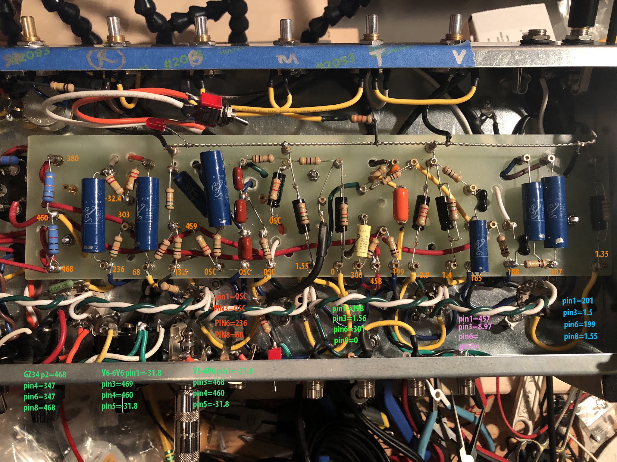

I am a firm believer in the K.I.S.S. rule, although you'd have no reason to believe it. Poking the PT plate is a Pandora's box? No problem. But now this thing will shut off in the middle of playing. I cobbled together some voltage readings with the 6V6 tubes out, foot switch and reverb tank removed:

Still cutting out. I put the tubes in to rule out my probe, this amp cuts out when I turn it up. In the middle of playing it cuts out, then it came back for a bit, then shut off again. :evil:

Those voltages would be a lot more meaningful and helpful if they were put on a SCHEMATIC and the output tubes were plugged in.

"Hey guys, what do you make of this Schemanicotti?" :mrgreen:
I will make more sense of all of that, good call. :D
