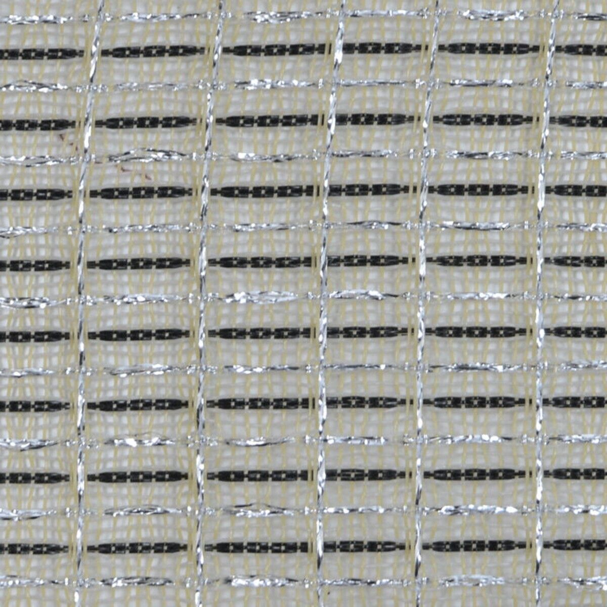

If you're thinking about grill cloth to make them all look nice and the same (Super Six doesn't really need it) Mojo has some inexpensive Fender blackface grille cloth on ebay. I've done a few amps and the imperfection doesn't bother me. Install it semi tight and then hit it lightly with a hair dryer. Voila!
https://www.ebay.com/itm/165688662214
