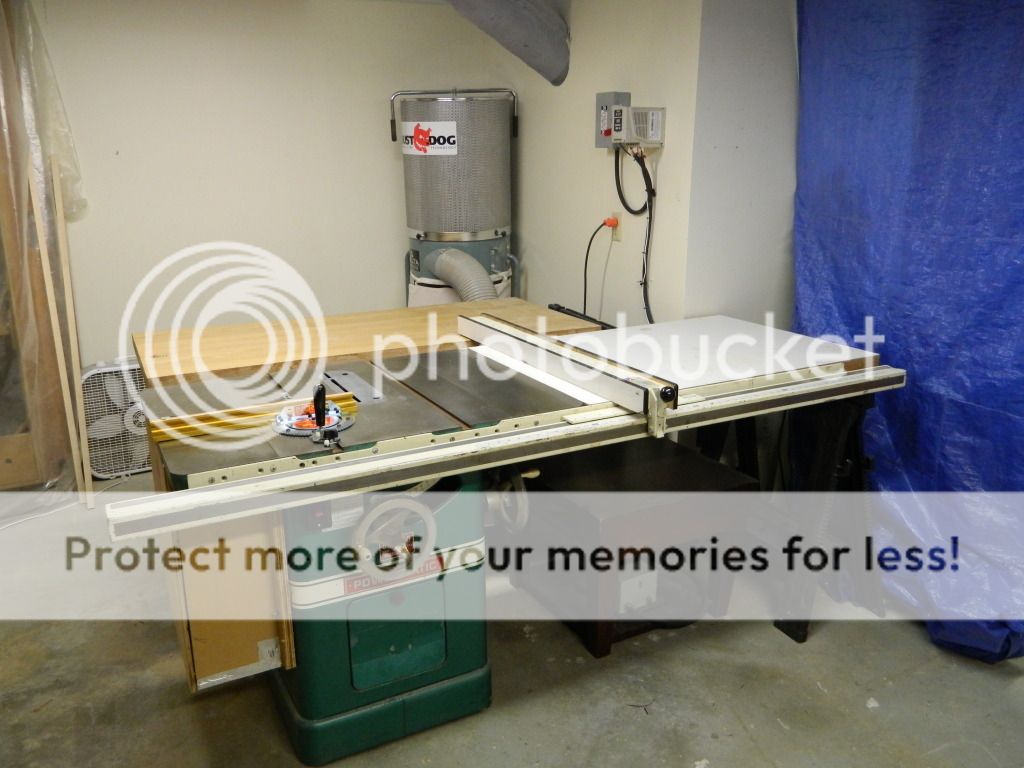

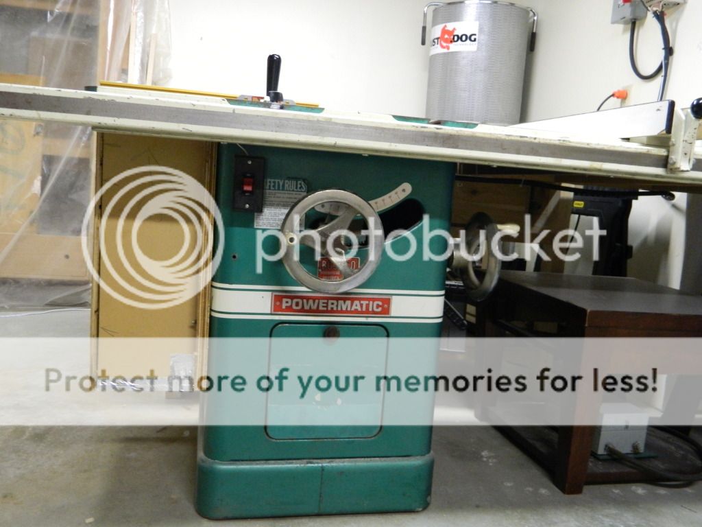

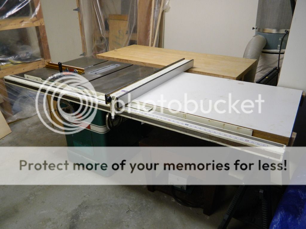

I just added a shop photo of the new saw...thought the camera was out of batteries...the saw still needs some paint, but I was out of commission for about a week and I needed to get back to work!
Thanks guys - I have to keep things neat or it gets impossible to work in that space. Wood chips and tolex are a BAD combination, like really bad.
The saw has the original 3hp 3 phase motor in it. I bought a variable frequency drive that produces the third phase and restored an old Marshall cabinet for a master electrician to wire 220v to a fused disconnect right by the saw and a "new outlet in the kitchen" so I could slide it by the boss.
The drive can be controlled by a SPST switch I installed on the saw, and is programmable for a soft start and 3 second stop.
I never knew much about this type of power, but it was really interesting to learn and definitely ups my man status having industrial power in the basement.

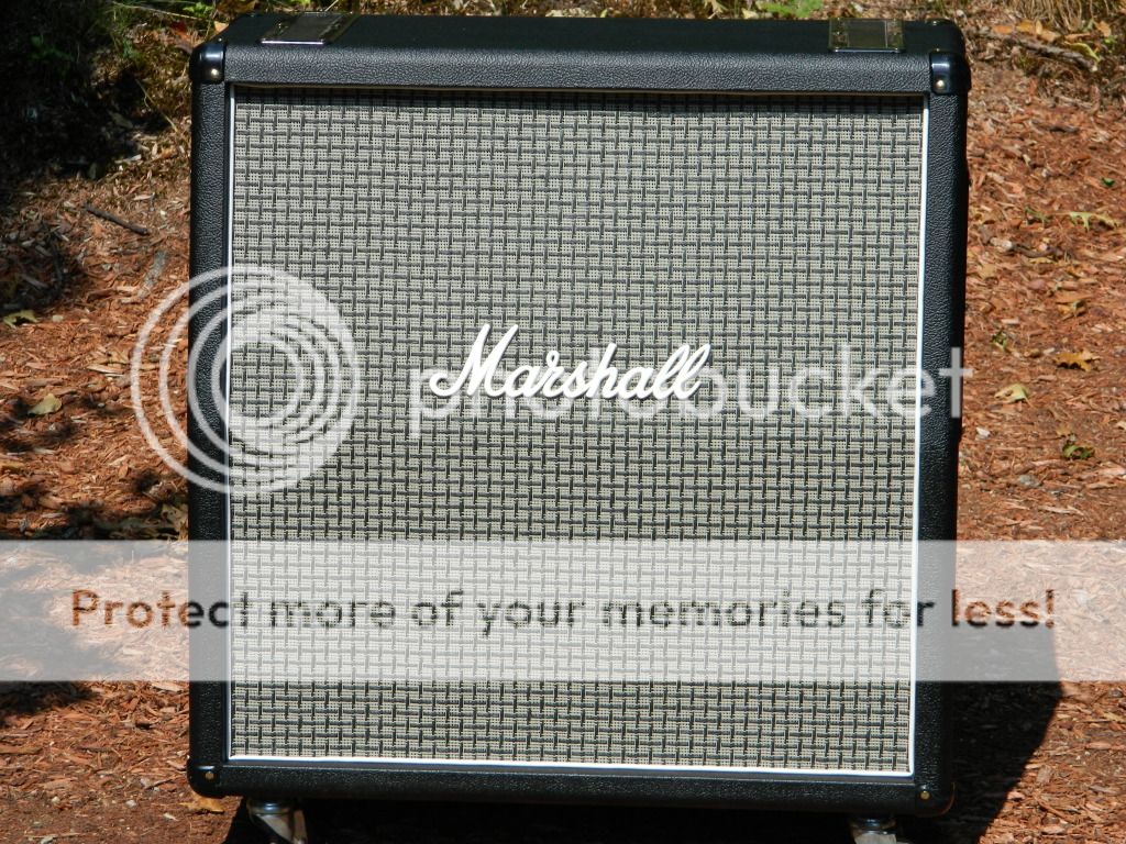

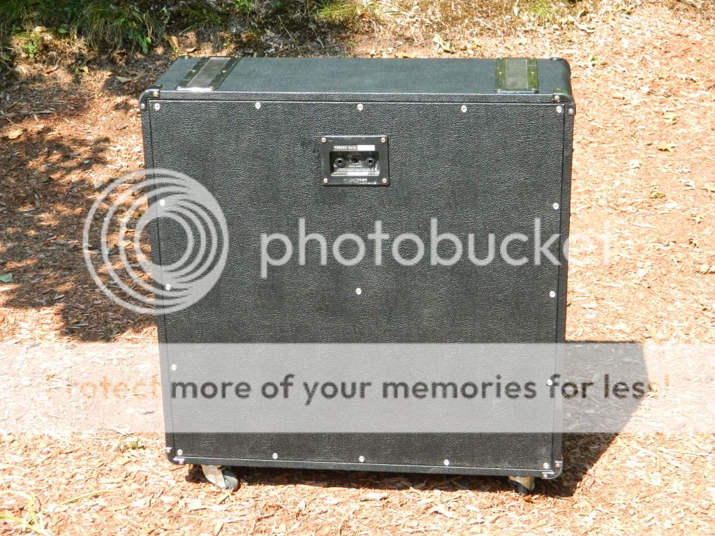

Here's a before and after of the Marshall cab. I don't usually do 412's anymore, but I made an exception. Swapped out the cloth, recovered to black levant, and replaced the rivets from silver to gold.
Those mighty fine examples of Taylor's work are heading my way! ...just a shame I'll be lacquering them, adding an amp and speaker, and sending them along to another
That's a real nice table saw setup, Incra Miter gauges are great! - they sure do make life a little easier in the woodshop.

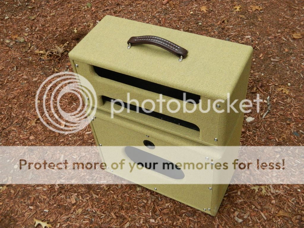

A few weeks back you told me to contour the metal corner covers with a rubber mallet. I just finished a Blonde Bassman Cabinet for a friend and, just like you instructed, the procedure worked nicely. Thank you again for the tip!
alvarezh wrote:Congratulation on your progress Taylor, if you have grown during these hard times imagine what is coming your way once the economy gets better!
All the best.
Horacio,
Great to hear about the corners! That makes all the difference, also the countersinks!
Make sure to file off the heads of those oval head screws, they can get really sharp if the drill puts any burrs in the slots.
