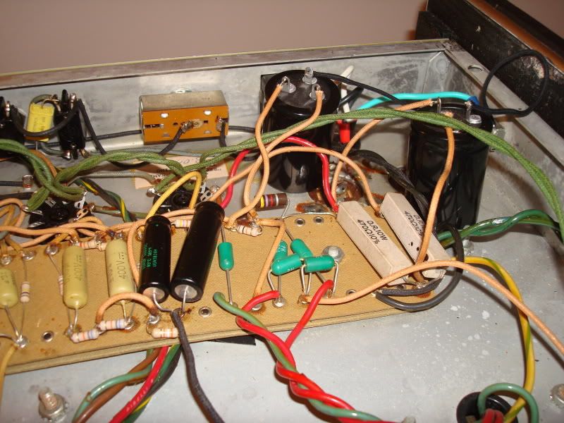

I just got a hold of a Traynor Yba-1. When I got it last week it crackled really loud so I didn't really play it much.
Today I replaced:
Two can caps rated 40 uF @ 450 V for two JJ can caps rated 50 @ 500V
One 8 uF rated @ 250 V for a Sprague 8 uF @ 450 v
A 68 uF rated @ 63 V for a 100 uF @ 100 V.
The amp now is blowing the internal breaker. It plays for a few minutes then it breaks it. If I reset it (There's a reset switch at the back) then it goes for a bit again.
Two things I need to mention tho' (Don't know if they could also have to do with the issue)
The cab I use is rated for 4 ohms and the OT on the amp is 8 ohms. When I got it last week the cab was wired for 16 ohms.
I believe the power tubes are almost done.
Could the last two things I mentioned have anything to do with it?
PS:
I will move the can caps to where the old ones were I just don't have a high power iron yet. I got a 150 V soldering iron today from a buddy but it wasn't enough to melt the solder on the tabs on the old cap cans. (All 4 tabs are soldered per can cap AND with lots of solder on top)
Thanks.

Bad power tubes could certainly cause the fuse to blow (circuit breaker to trip) in an amp. And since they are easily replaced, that would be a great first step in determining your problems.
I doubt that the impedence mismatch would cause this.

Nigel Tufnel wrote:Swap the tubes for sure. As far as melting that solder holding the can caps in.........good luck. They must have used blow torches at the Traynor factory back in the day. :wink: I ended up taking a dremel tool to the ones in mine. I mounted some clamps and stuck f&t's in it. Those are some excellent amps if you massage the circuit a bit. I tweaked one for a guy last week that turned out killer, he's liking it more than his vintage Marshall and Hiwatt. Altering the B+ rail to make it more guitar friendly will make a world of difference for the better. Whoa!!! I just looked at your pic again and it looks like your bias supply caps (the sprague atoms) are backwards. You need to flip the polarity on those, connect the positive end to ground in the bias supply.
The caps are backwards?? No wonder the fuse is resetting itself. I would have thought they would've blown up when I turned it on.
The old caps had the plus printed over on that end but I guess they both have a circle thingy to indicate polarity. That could have been bad. :shock:
I try to be really careful about polarity but I guess I wasn't careful enough today. I hope the bias supply caps are alright. hopefully the breaker saved them.
I think I might have to go with a dremmel to remove the old caps as well. Somebody is selling a 240 weller soldering gun, but I don't know if that might be enough to melt the solder on top of the tabs on the old cap cans.
Re: Recapping an old Traynor
Heheheh, when I was a kid, me and my buddy used to hook up old electrolytics to a power cord and knife switch.
When you hit the switch and sent 120vac to the caps they exploded like firecrackers.
Yes, you are lucky they didn't blow up.
Hopefully they aren't damaged.
The easiest way to know which end is which, is the negative end will always be the can of the cap. The lead is welded right to the can so you see a shiny metal end there.
The other end, the positive end always has a rubber type, usually black plug that the lead passes through.
No offense but you really need to bone up on electronics, component familiarization and schematic reading.
This stuff can bite you badly if you don't fully understand what you are doing inside the amp.

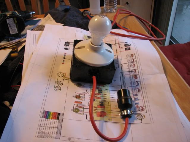

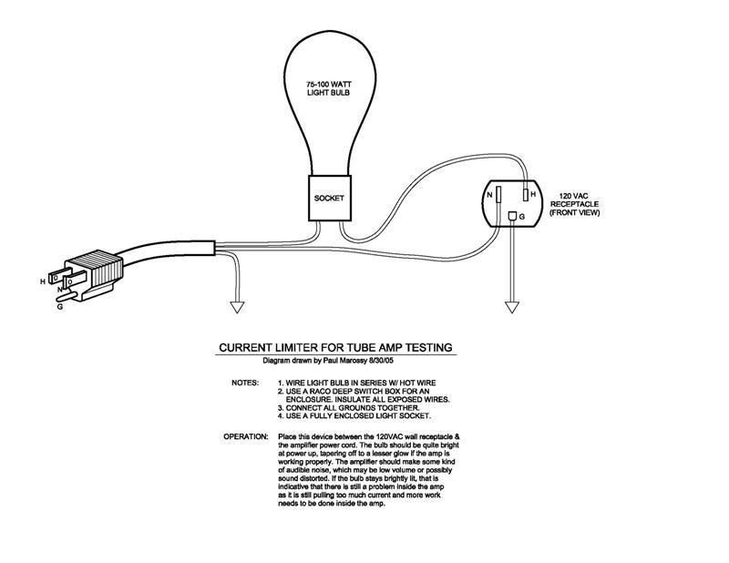

Plug the amp into a 50 ft extension cord, go to the other end of the house and plug it in! :lol:
Seriously, do you know what a light bulb current limiter is?
It is a good way to power up an amp for the first time or after a repair.
This is a handy device to have around and also is a good way to charge up new filter caps with less current.
[IMG:800:618]http://i23.photobucket.com/albums/b392/ ... iter-1.jpg[/img]
I built mine into a square metal junction box. Used an old extension cord for the plug and socket. I painted the box black.
[IMG:640:480]http://i23.photobucket.com/albums/b392/ ... G_0114.jpg[/img]
When you first switch the standby to play, the light bulb will flash because the filter caps act sort of like a short circuit right at first, but then as they charge the bulb grows dim.
Depending on what wattage the light bulb is, determines how much current the amp draws.
If it stays bright, you have a short somewhere that is drawing excessive current.
Turn the amp to standby while watching the lamp. The lamp should flash and then glow an amount that reflects the "idling" drain of the amplifier. For the 25W lamp, this may be fairly fully on. For higher wattage bulbs, this will be dimmer.
To use the tester, plug the amp under test into the outlet, and choose a bulb. If you've had shorted-AC or fuse-blowing problems, you may want to use a 25W lamp, as this will limit the AC current to a bit under 1/4 ampere. This should allow you to verify that you've fixed the problem without losing any more fuses! If you're debugging a runaway problem where normal operation starts OK but then things get hot, you can use a larger wattage bulb to allow semi-normal operation of the amp but to choke off the AC as the runaway starts. The lamp will glow more brightly as the amp tries to draw more current.

I inverted the bias caps to where they should have been and wired the cap cans again to test it.
When I turned it on the second time tho' the breaker blew right away and the cap cans bubbled up. (They each got a bubble on top)
Could this be caused by the fact that I might have messed the bias caps yesterday?
I think I defintily need to build a current limiter.
