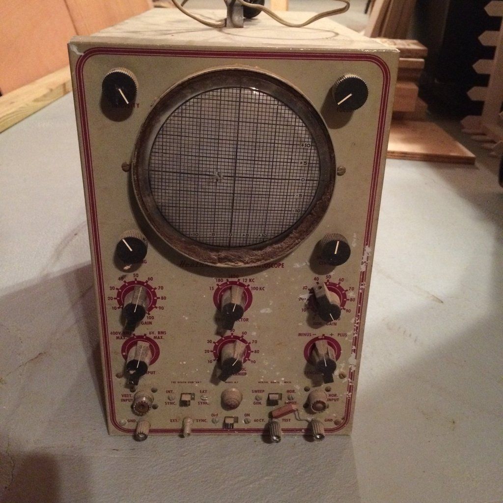

I dropped a bill on a new oscilloscope.
New to me.
And a $20 bill.
[img:1024:1024]http://i234.photobucket.com/albums/ee25 ... j3xiez.jpg[/img]
It's a 1951 Heathkit O-7 Oscilloscope. The guy who sold it had previously fired it up and got a horizontal line - I declined to try, didn't want an electrolytic shorting out and nuking the rectifier tubes. Opened it up, the 12AT7 vertical amplifier is cracked. Plus, a ton of bubbly wax and paper condensers, and 64 year old electrolytics.
I'll replace all the caps and the drifty carbon comp resistors. Might install modern BNC connectors for the probes as well, or maybe a pair of binding posts/banana jacks if the existing holes are spaced right.
Anyhow check out these little coil things in the upper right - I'm assuming these are old-school wirewound power resistors and not inductors?. The schematic just has caps & resistors there. The white thing is probably a resistor as well?

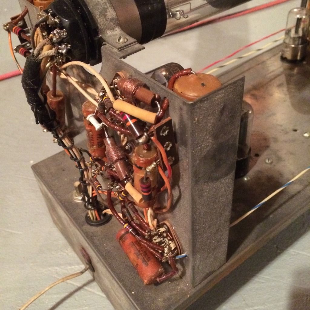

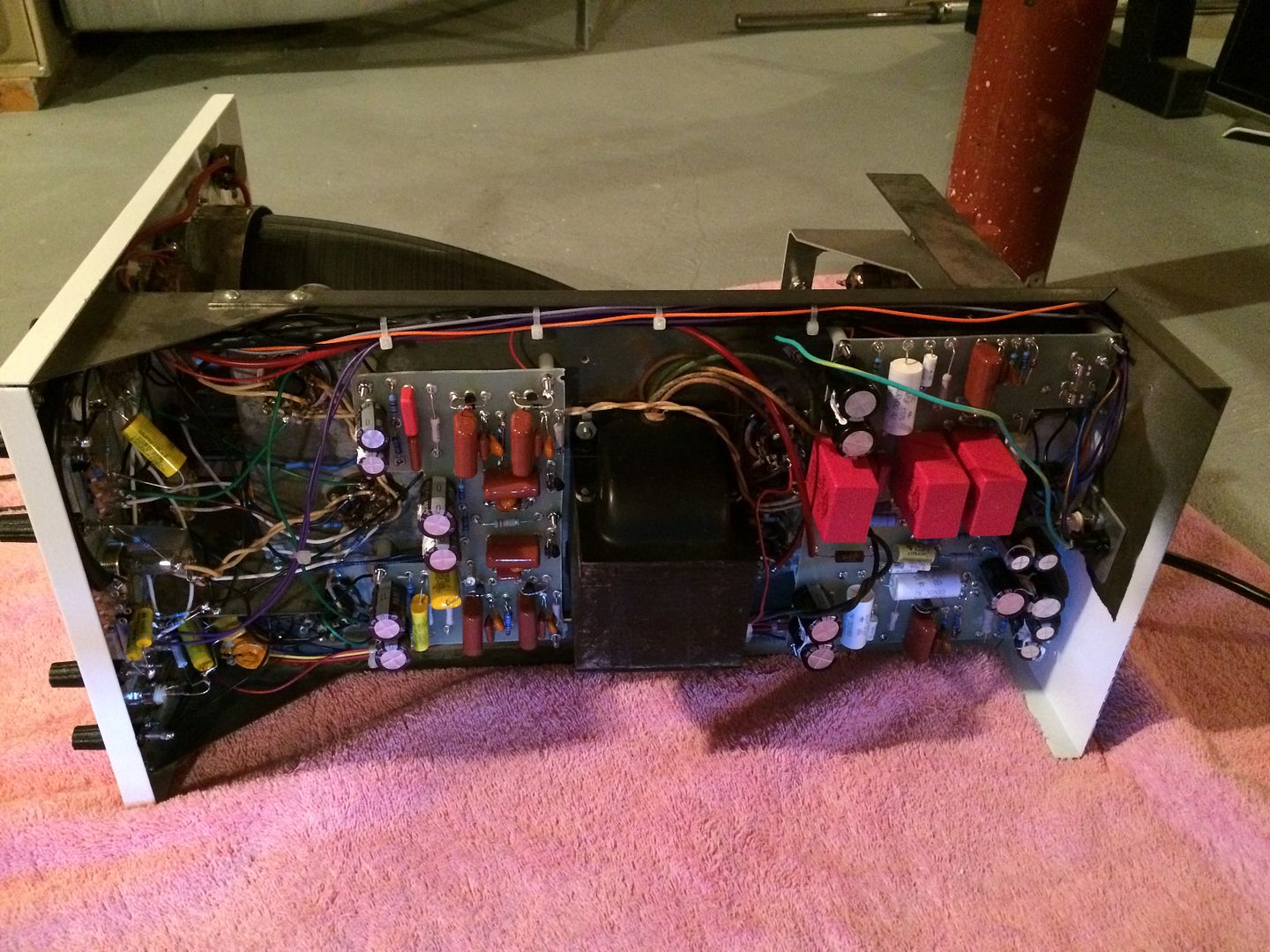

Anyhow here's some gut shots. I added a lot more filtering to the power supply and a bunch of capacitor multipliers to kill any ripple.
[img:1024:768]http://i234.photobucket.com/albums/ee25 ... p6fsqg.jpg[/img]

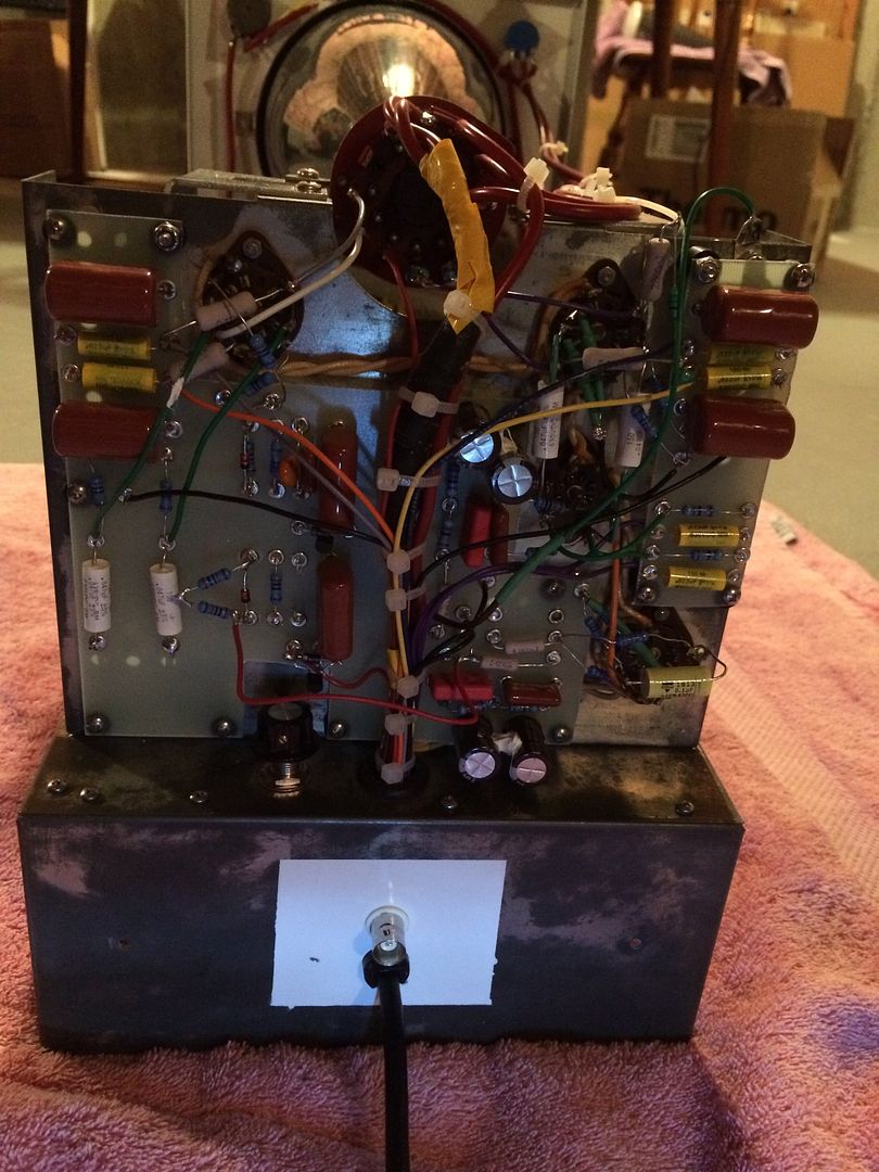

In the photo below you can see a red jumper wire. I was getting ripple that I just couldn't make go away on the first vertical amplifier. When I jumpered over the capacitor multiplier, it went away, so I cut the multiplier out of the circuit entirely. Nope, ripple came back. Replaced everything, ripple still there. I must have done something stupid under the board - but no way I wanted to disconnect everything to lift the board, so I just permanently installed the jumper. Anyhow that's why that section of the circuit board looks terrible.

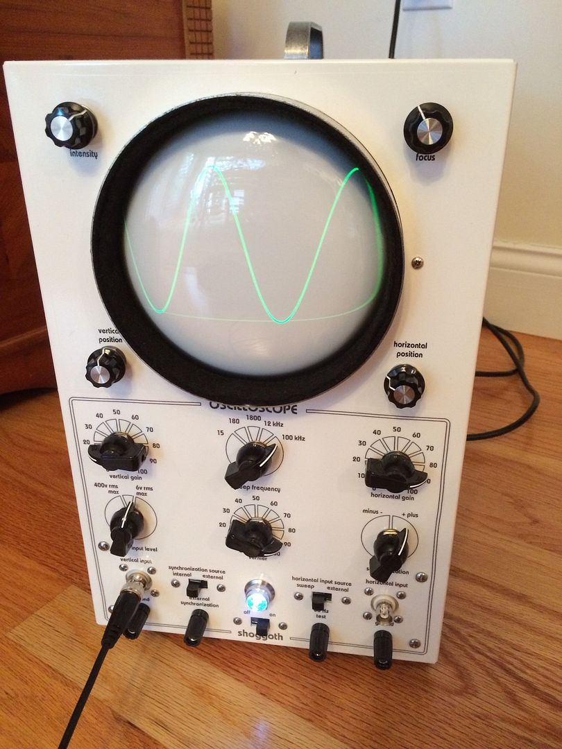

Here is a 1 kHz sine wave

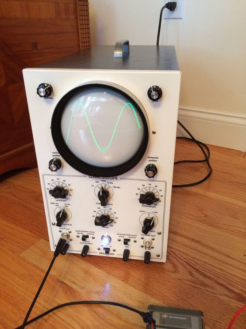

And a 150 kHz sine wave - you can see the sweep trace from right to left, this oscilloscope doesn't have any blanking:
[img:768:1024]http://i234.photobucket.com/albums/ee25 ... hhdhqs.jpg[/img]
