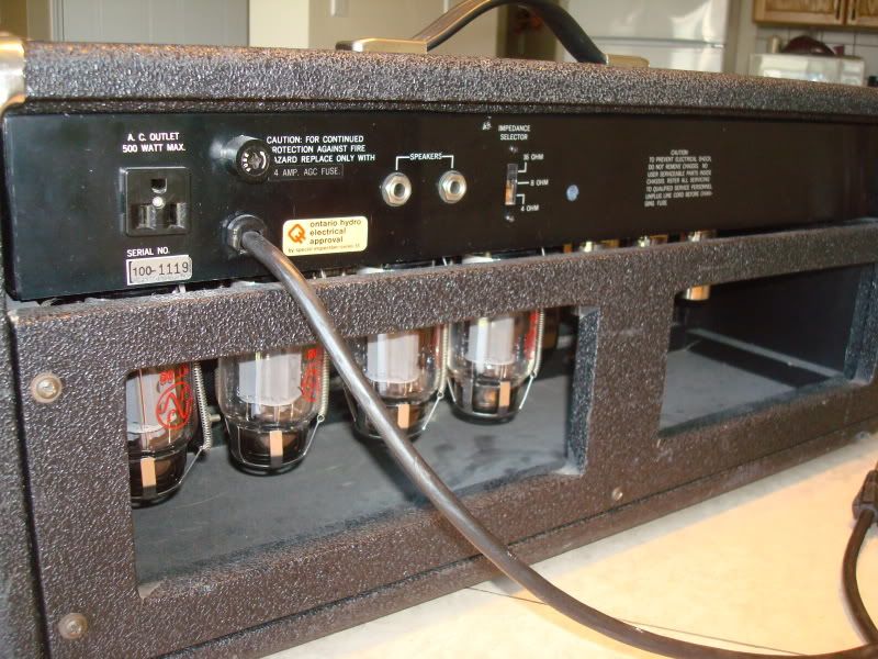

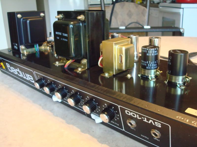

So i got this Ampeg SVT-100 as a trade. The last owner took out the 6550's and replaced with kt88's but did nothing else to the amp.
Actually I haven't even opened up the amp as I literally just got it. Don't even know if there is a bias pot somewhere in there. I guess I can find out if I can locate the schematic...
In the meantime...Am I ok running it like that before I have a chance to open it up?

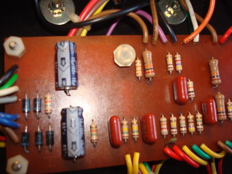

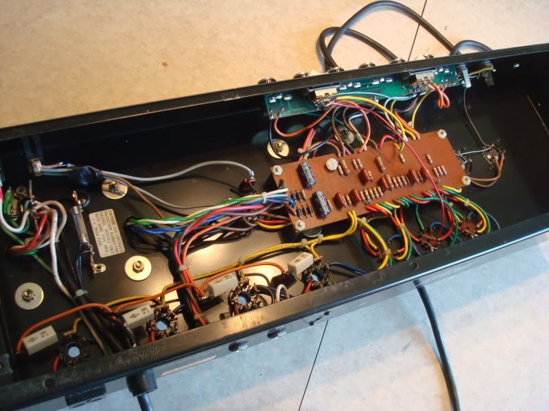

no bias pot. it's a fixed resistor.

Actually it does have a bias pot. You might be able to see it on this pic. I actually haven't taken any measurements yet but Im going to bias it for the kt88's.
is it a bias or a hum pot? I'll admit the information I was able to find was very little. Ampeg in the 80's was a disaster. The history of ampeg sort of skips over the 80's... 1978... 1990. I'm really glad they turned it around in the 90's but they are starting to have issues again.
