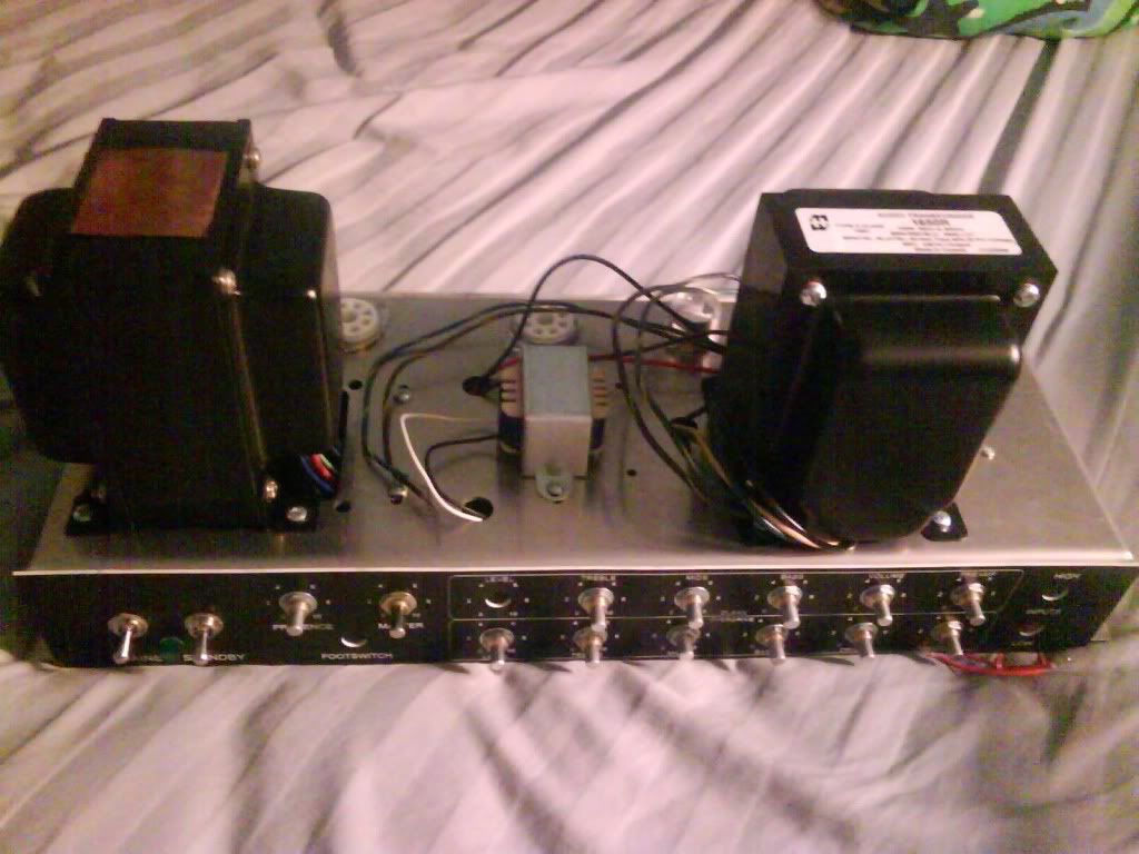

savage enough for you guys?
768]http://i89.photobucket.com/albums/k201/ ... 01-1-1.jpg[/img]
I actually swapped the choke to a larger better quality one.
I want the power amp to pretty much have as much clean room as possible since this will be an ODS type amp and i use the preamp OD
This was originally going to be a KT88/90 build but tose KT120's interest me too much to pass by

Better put wheels on that thing.JD0x0 wrote:savage enough for you guys?
