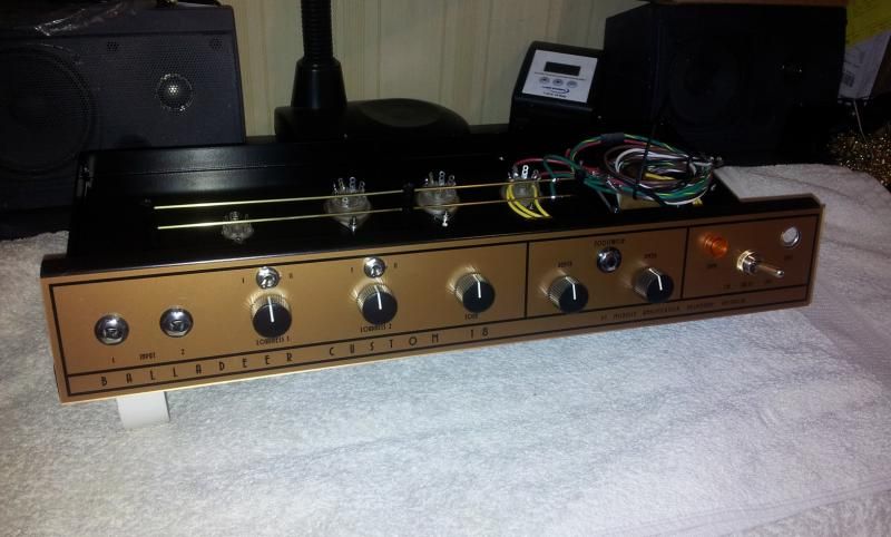

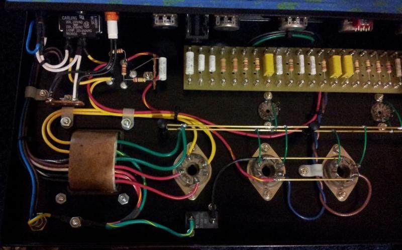

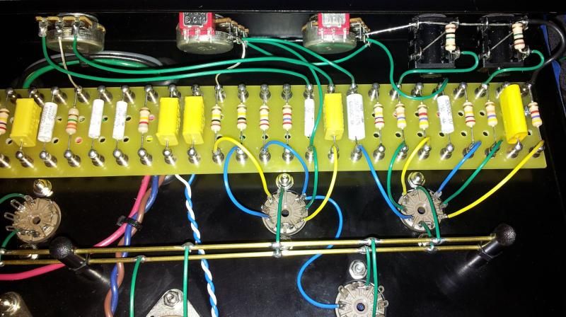

Im in the process of building a 214 for a customer at the moment.
Its an AMAZING circuit. Sounds stellar.....even if it did cost me $100 for a pair of Varistors.
[IMG:800:482]http://img.photobucket.com/albums/v87/x ... 006bd8.jpg[/img]
[IMG:800:448]http://img.photobucket.com/albums/v87/x ... cb0284.jpg[/img]
[IMG:800:498]http://img.photobucket.com/albums/v87/x ... 26b17b.jpg[/img]
Couldn't quite bring myself to point to point this as my OCD just wouldn't allow it.

Spectacular. More info more picts. Where are the varistors? Did you get old ones off ebay or actually were able to buy the new ones? Looks pretty easy when built on a board compared to the orig mess. I think you deserve your own sub-forum.
The filaments are terrific, brilliant implementation. I thought of trying it too ala Soldano, but yours is a much better. For myself I'd be really worried I'd accidentally short out the heaters when probing around and loose the PT in flash. I need to think about it, I really hate doing heater wiring but this looks like big fun. A rip-off might be coming up, that's what you get for posting on the internets.
Re: Magnatone is back
You could slip teflon tube over those exposed runs.
Even now, you can split it and click it on.
rp
Posts: 2528
Location: Italy
Post by rp »
Cantplay wrote:You could slip teflon tube over those exposed runs.
I thought of that too, but it wouldn't look so slick. I use a lot of clear teflon tubing in ptp amps. it sucks up flux by capillary action and looks like poo. not sure splitting it would look spiffy either. maybe if I could find black tubing. Best and it would keep the clean industrial vibe would be clear corona dope applied after all is finished and working and no need to resolder anything.
