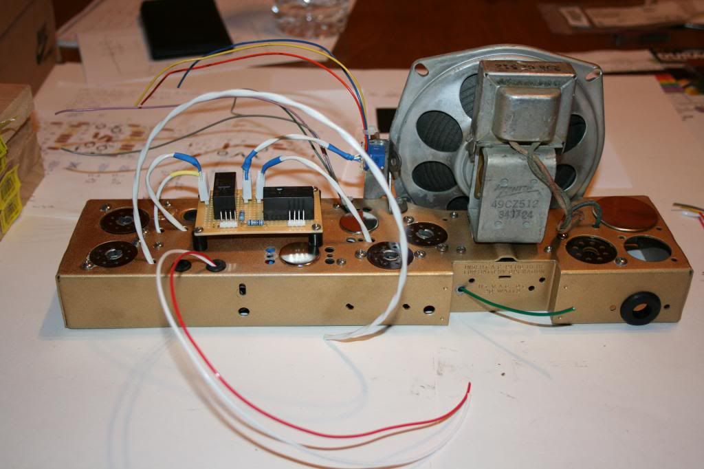

Here's the radio chassis with the relay board and volume controls wired up (except for relay power). Wish there was room inside for the relays, this is a very silly way to wire up the amp. The volume control is mounted where the tuning capacitor knob used to be.
[img:1024:682]http://i234.photobucket.com/albums/ee25 ... b047d0.jpg[/img]

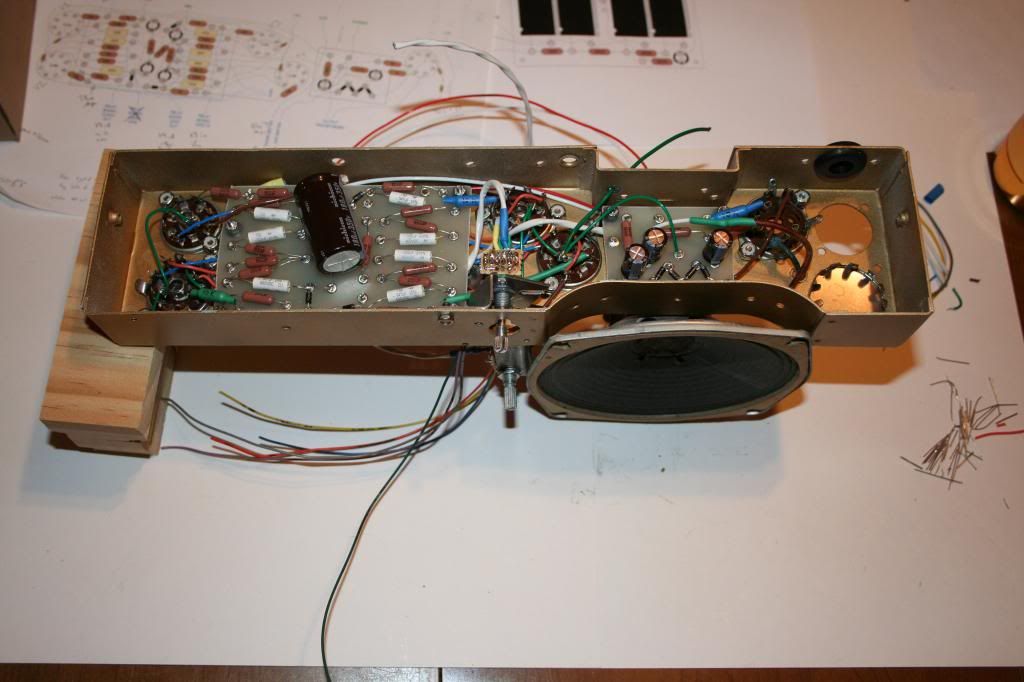

Here's the preamp and power amp. It's cramped in there, and the tube sockets are in totally inconvenient places. The heaters are DC and signal wires are mostly shielded, so hopefully it's not too noisy. I still need to run the heater power wires.
[img:1024:682]http://i234.photobucket.com/albums/ee25 ... 7ff11d.jpg[/img]

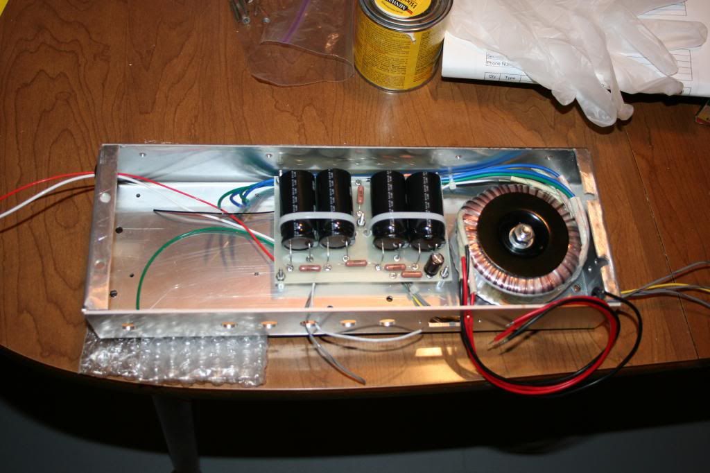

Here's the power chassis, with the transformer and 90v power supply. The preamp is at 90v and the power amp at 75v, so there's a lot of filtering going on in here before it even hits the preamp. I still need to put the regulated 7.5v supply together for the heaters, relays, and volume/gain displays.
[img:1024:682]http://i234.photobucket.com/albums/ee25 ... 55d99b.jpg[/img]
