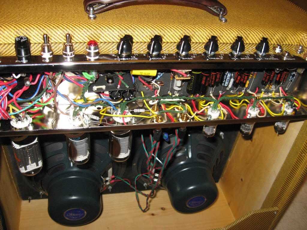

The Neutrik jacks that Weber provides are fine quality, no need to improve. I've built a 5F6A, a 5E8A, and a Tore-Vibe from Weber kits, and I haven't had any problems with noise or the jacks. I've also ordered plenty of extra Neutrik jacks for other builds.
Here's my 5F6A:
[IMG:1024:768]http://i268.photobucket.com/albums/jj29 ... G_0344.jpg[/img]
