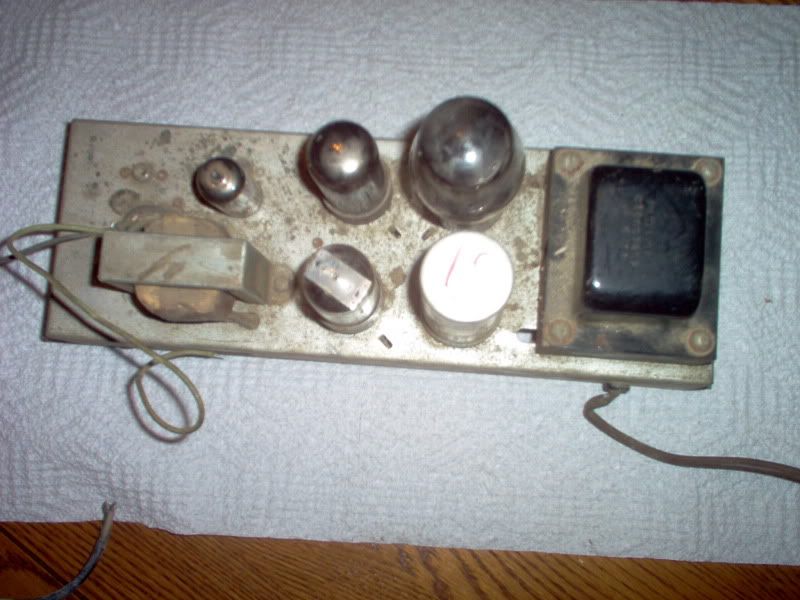

That amp looks taylor made for this amp I got in a box of tubes . Thought about converting to a 5E3 but could use what's there already , One 12AX7 26V6's and a 5Y3GT . Thanks for the plans
[IMG:800:600]http://img.photobucket.com/albums/v602/ ... sistop.jpg[/img]
