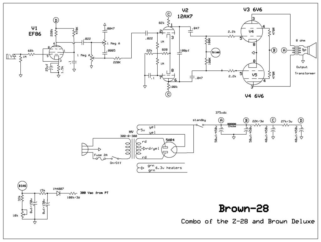

For what it is worth, here is a schematic of an amp I'm working on. It started life as a Z-28 clone but now it is starting to morph into a brown deluxe of sorts.
[IMG:1024:773]http://i211.photobucket.com/albums/bb13 ... own-28.jpg[/img]

jaydawg wrote:For what it is worth, here is a schematic of an amp I'm working on. It started life as a Z-28 clone but now it is starting to morph into a brown deluxe of sorts.
Funnily enough (apart from the fixed bias) this is almost exactly what I had originally in my 5E3 chassis. Hope you find a non-micro EF86 - I gave up in the end :roll: :? Besides the microphonics it sounded really nice.

Very interesting...my amp is more of a Brown Deluxe 12AX7 normal channel and PI circuit, but with a 6SN7 channel as well as a 5E3 power section.
I'm curious to hear how yours turns out, jaydawg...
