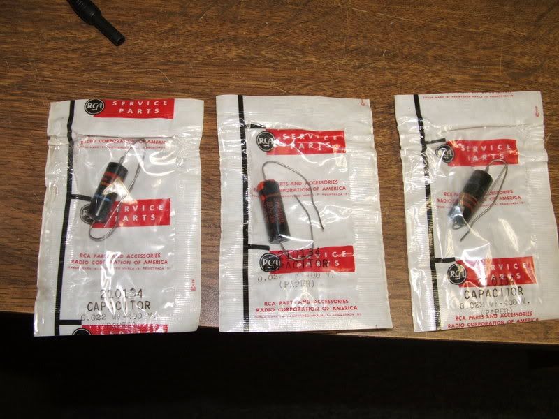

These are the caps I have currently.
[IMG:800:600]http://i14.photobucket.com/albums/a330/ ... ISC036.jpg[/img]
[IMG:800:600]http://i14.photobucket.com/albums/a330/ ... ISC034.jpg[/img]
These are what i got from lastwinj for my 53 conversion. I got the bees a couple of years ago and only just got the Black Beauties above.

Good ones! How much ?HeeBGB wrote:These are the caps I have currently.

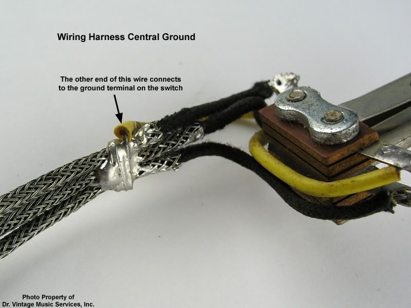

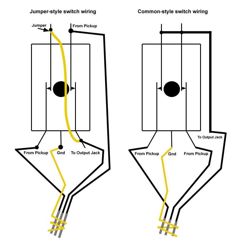

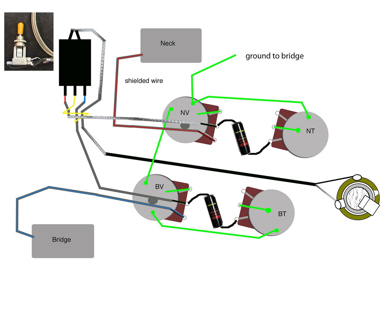

circuit check
Just checking to see if I have this correct. As i understand it there were at last two primary methods to wire the 3 way toggle, the simple way and the
more complex way. In either instance the shielded wire is used to carry the ground signal. Does this look ok.
A
I could not quite tell from the pic if the left hand method is as I have drawn it.
