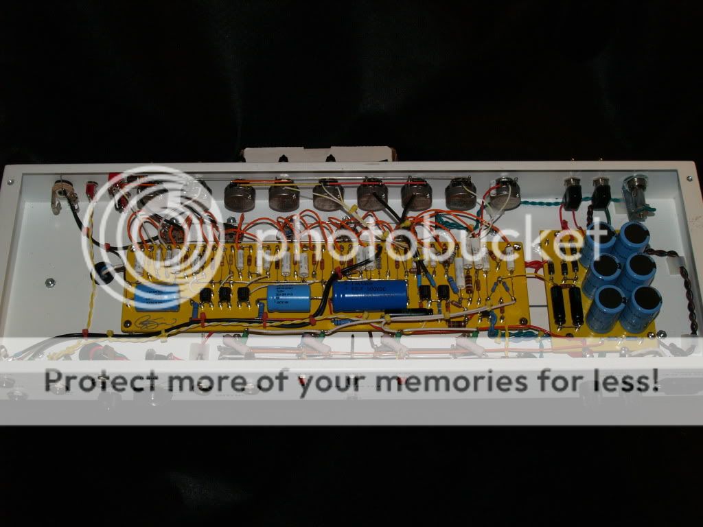

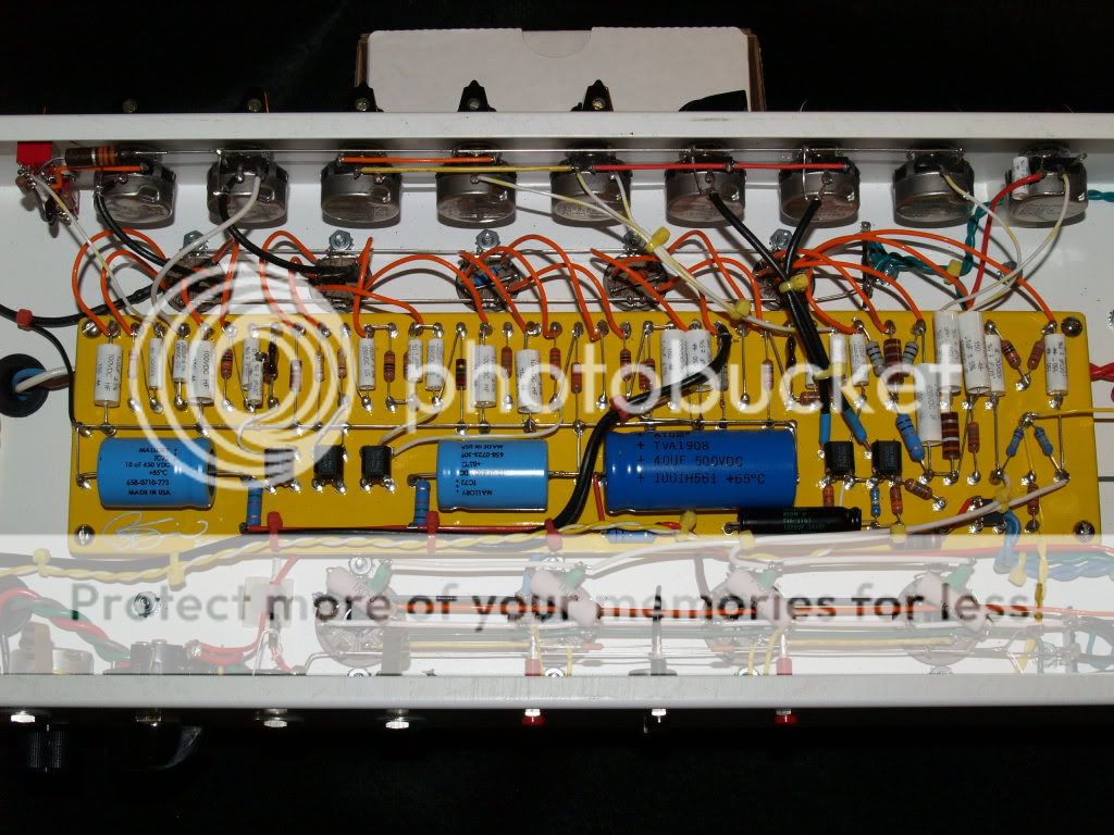

I built A SloClone and found a few Errors on the Turret Layout . I designed my own PS board so i'm no use there . However, one thing I remember running into was I placed one of the B+ wires on the wrong Turret. This was Under the board so it took me a while to find it. I will look at everything tomorrow and see what I wrote down ..
Here are a couple shots of my build for now . It may or may not help .
768]http://i734.photobucket.com/albums/ww34 ... 045030.jpg[/img]
768]http://i734.photobucket.com/albums/ww34 ... 045029.jpg[/img]
