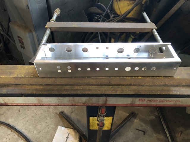

Here’s the completed chassis and the faceplate. It’s sitting on top of my cardboard chassis layout.
I braze the corners with a torch and alumiweld brazing rods.
Someone asked how I bend up the chassis. Here’s a picture of another build with the electromagnetic box and pan brake at my wife’s shop that I use.
It’s a cool device but it will squish a finger if you’re not careful!
Matt

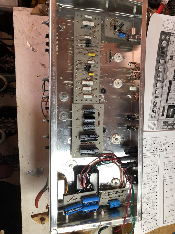

Time for the fun part to start. Populating the boards with components. Caps first.
It looks like folks here like orange drops, but I’m a Mallory 150 guy. No shade on the orange - I’ve used them and they’re great. I just bought 150’s in bulk years ago and I’m still working off my inventory. They have been dependable and sound good to me.
Loading up the rest of the boards. I have Koa Speer 1/2w carbon film resistors by the bunch load. I’ve always bought 100 of what ever value I needed and built up a good supply. This amp made me buy a bunch of values I’ve never used before. Pretty funny after building a lot of amps. 2.2k, 180k, 22k, 3.3k, 3.3m, 51k, 1.2m, 56. No worries, I have a lifetime supply now.
The CDE 1000uf 80v caps I bought for the relay power board are giant. Took me a little finagling to get them to fit.

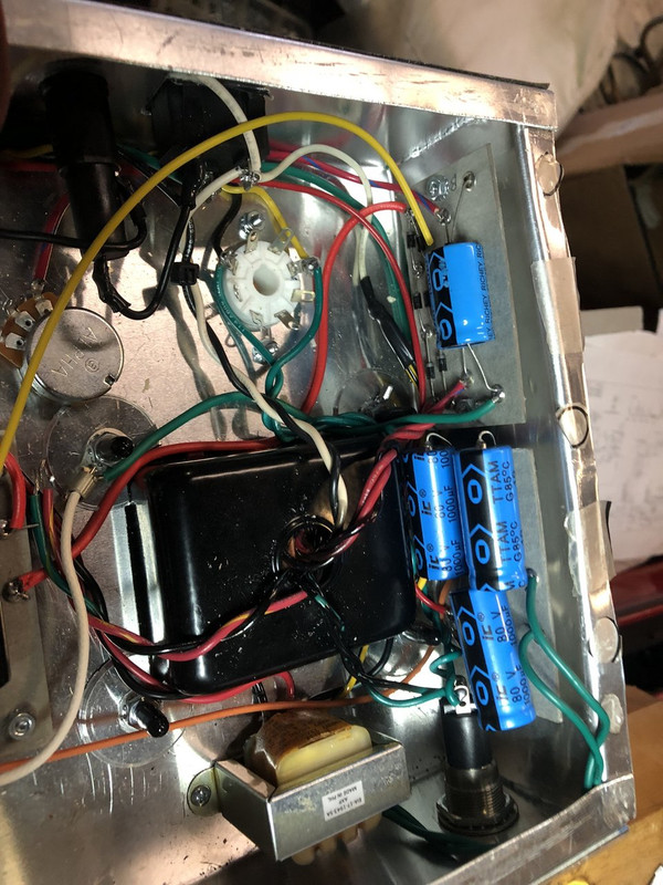

I like to wire my IEC with black hot covered with heat shrink to reduce the risk of “bites”. 120vac stings a bit. Ground (green) goes to a dedicated lug on the chassis.
It always looks like mayhem when you throw the wired boards into the chassis. Time to make some sense of this chaos.

The front panel wiring is really something. That’s a multi hour adventure!
Chances of me getting that 100% right? Slim.
Bias/rectifier board and relay power supply.
