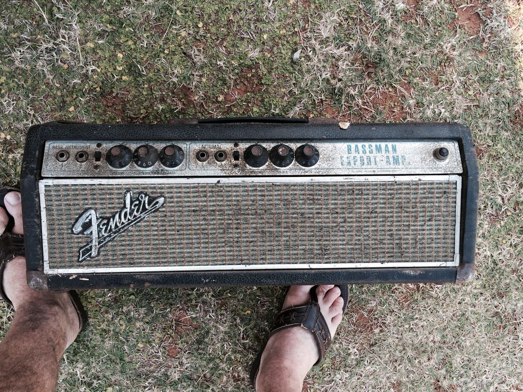

I have decided to attempt a Dumble build in a Bassman 50 head chassis. From what you guys have said, the iron was used by Mr Dumble himself. So that is one part sorted. Hererwith are pics of the donor chassis.
[IMG:1024:768]http://i48.photobucket.com/albums/f214/ ... hojrog.jpg[/img]
Out of cab. Sorry about bad pics.

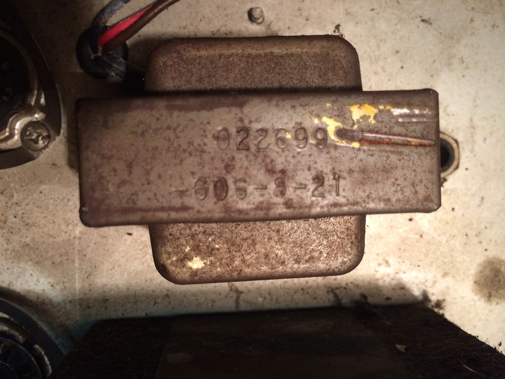

Codes on iron Mains PT (a bit blured and upside down)
[IMG:1024:768]http://i48.photobucket.com/albums/f214/ ... rhuyr6.jpg[/img]

May somebody can help with dating. Looks to be 69?

Looks like it has some mods already... :) ...The year, looks like a 68 bassman to me ...I don't think it's a Bassman 50...

Has to be a 50w bassman! 2 x 6L6!! I believe it was "black faced"! :shock:

Actually, all the Bassman heads have 2 x 6L6's (or 5881's). If it's a Bassman 50, it should have 50 watts printed under the output jacks. If it doesn't have it, it' most likely a 40 watt amp.
Your amp has both 1968 and 1969 transformers and if I remember correctly, the Bassman 50 didn't come out until around 1972.
Also, it's interesting that your amp has "Bassman Export-Amp" on the faceplate, something I've never seen here in the U.S.
Based on the pictures, it looks to me like much more was done to the amp besides just "Black- Facing" it.
In my opinion, you have the best vintage iron for a 2 x 6L6 Dumble style amp and it's going to sound great!
Good luck with the project,
LDC

The export logo was a multi-tapped PT (110-240v) version.

Yes, every "Export Model" made by Fender for the overseas market has a multi-tapped power transformer. But, every "Export Model" I've ever owned (or even seen) has a standard Bassman-Amp faceplate, just like the domestic amps. Your amp has a "Bassman Export-Amp" faceplate and that's what I find so intriguing...

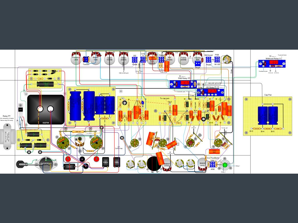

Found this on page 3 of Dumble Files. What do you guys think about this layout? Done in a bassman chassis!
[IMG:1024:768]http://i48.photobucket.com/albums/f214/ ... kfrypy.jpg[/img]
Built in dumblelator?

andresound wrote:Found this on page 3 of Dumble Files. What do you guys think about this layout? Done in a bassman chassis!
You should have room since the electrolytic caps for the power supply will be underneath the chassis in the dog pan of the bassman.

Well, its confirmed, the amp is a 69!! :lol: PRIMO IRON!!!
I am told that the eyelet board in the above layout is the same as the bassman's. I will strip, clean and check boards for conductance and report back.
