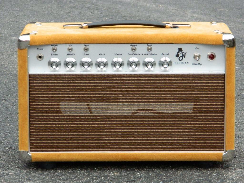

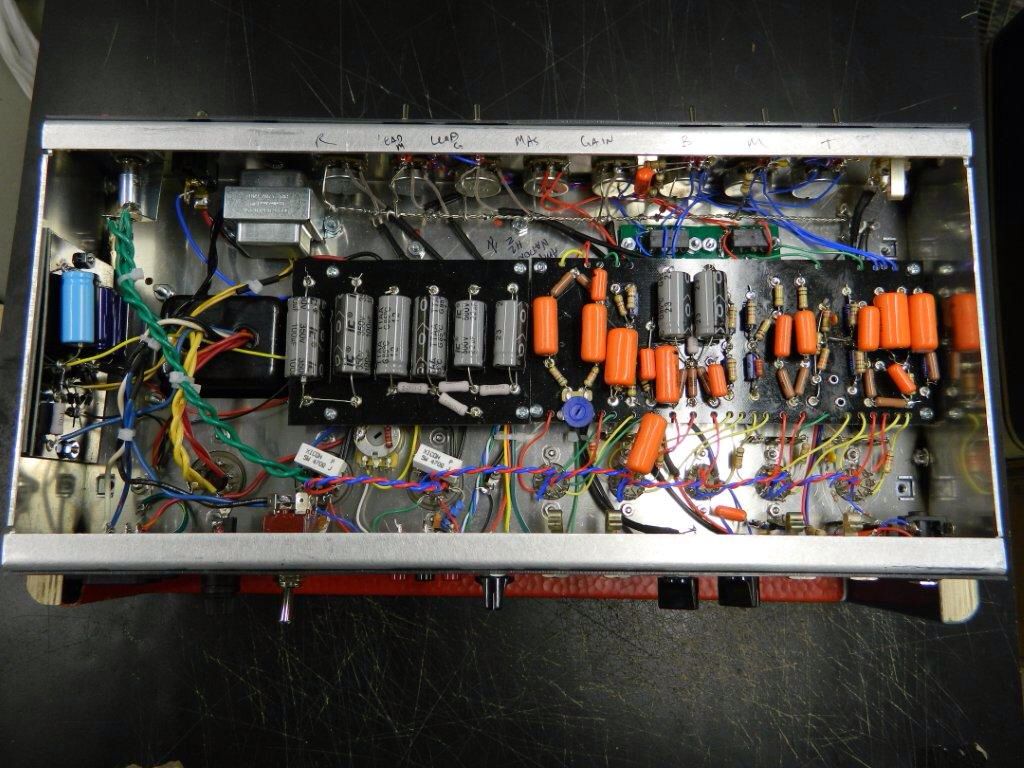

I finished this up today. 22w 2x6v6
JM sig clean channel into 2nd Gen OD, send/receive reverb, 1/2 d-lator. All stages 100k plates, I changed a few things on both layouts and kind of balanced out the designs on the different pot values and tone stack. 2nd Gen PI with 10k balance pot added

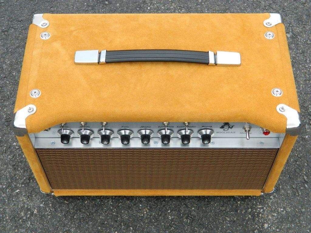

Chassis is 17", GZ34 rectified, Deluxe Reverb Hammond iron. 12v relay setup, two button footswitch. I set it up like a Two Rock, it was the only way to get it all in there. I had to put the contour on the back!
AN cab with buckskin suede, oxblood cloth, skirted knobs
Sounds killer!!! Not quite the headroom of the JM sig with the 6v6, but the tone is there and it's very strat friendly!
