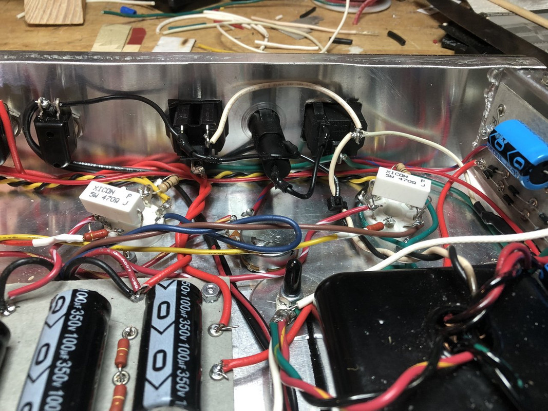

Here’s a closeup of the power tubes.
I took a few liberties here. I like to hang my cement blocks (Xicon 470/5w) on pins 4&6 and add some 1 ohm/2w resistors on 8&1 to ground so I can quickly check bias without plugging in a bias adapter.

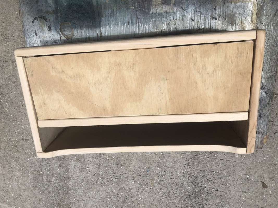

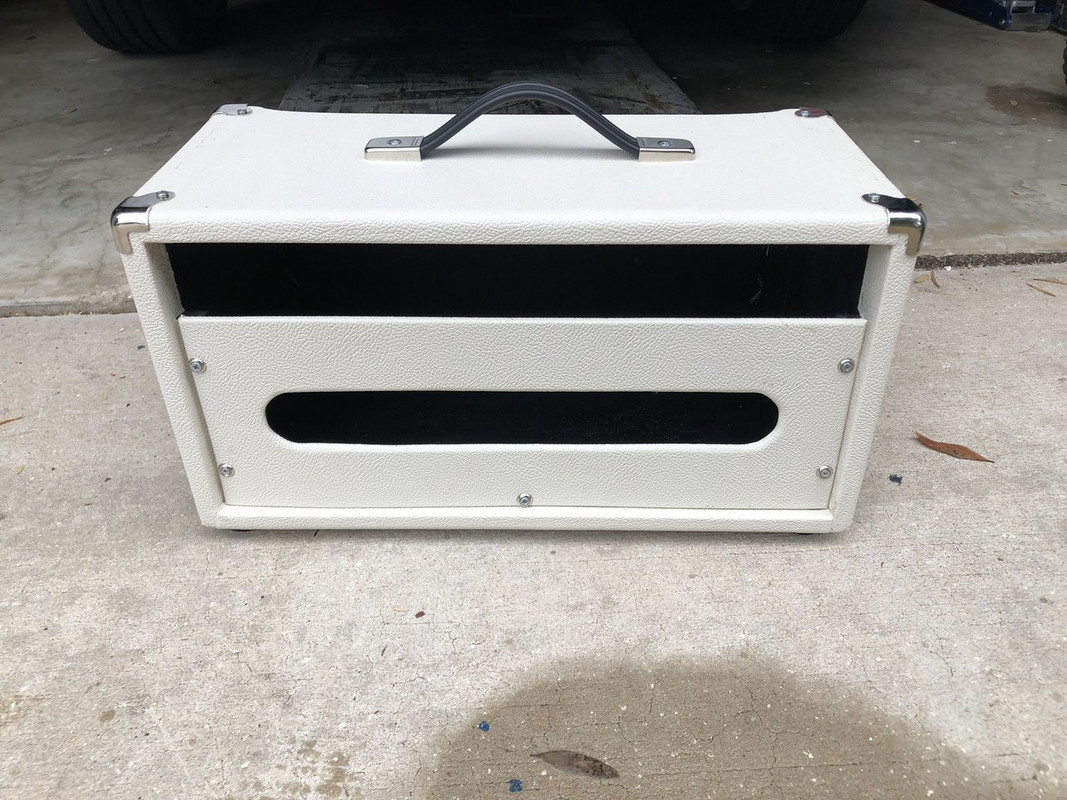

Cut out the front and back panels, the little shelf part and some internal mounting braces.
To try to make the hole in the back panel roughly symmetrical, I use a hole saw to cut each end and then connect the two holes together with a sabersaw. I made it 2” wide so my foot pedal would fit inside.
The front:
The back:
Oops, the pics are upside down. But you get the idea. I left some space for grill cloth and tolex. Next up - tolex time.

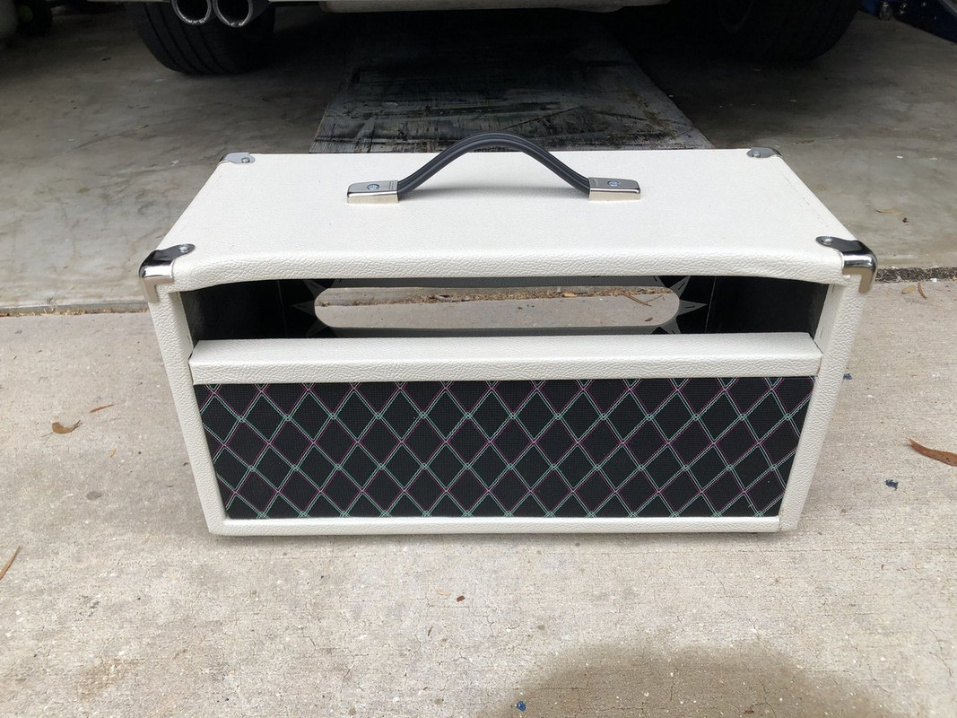

Finished up the head cab.
I’m pleased with how it turned out. I did buy white piping for around the grill cloth, but I don’t like how the bright white piping looks with the cream colored tolex I used.

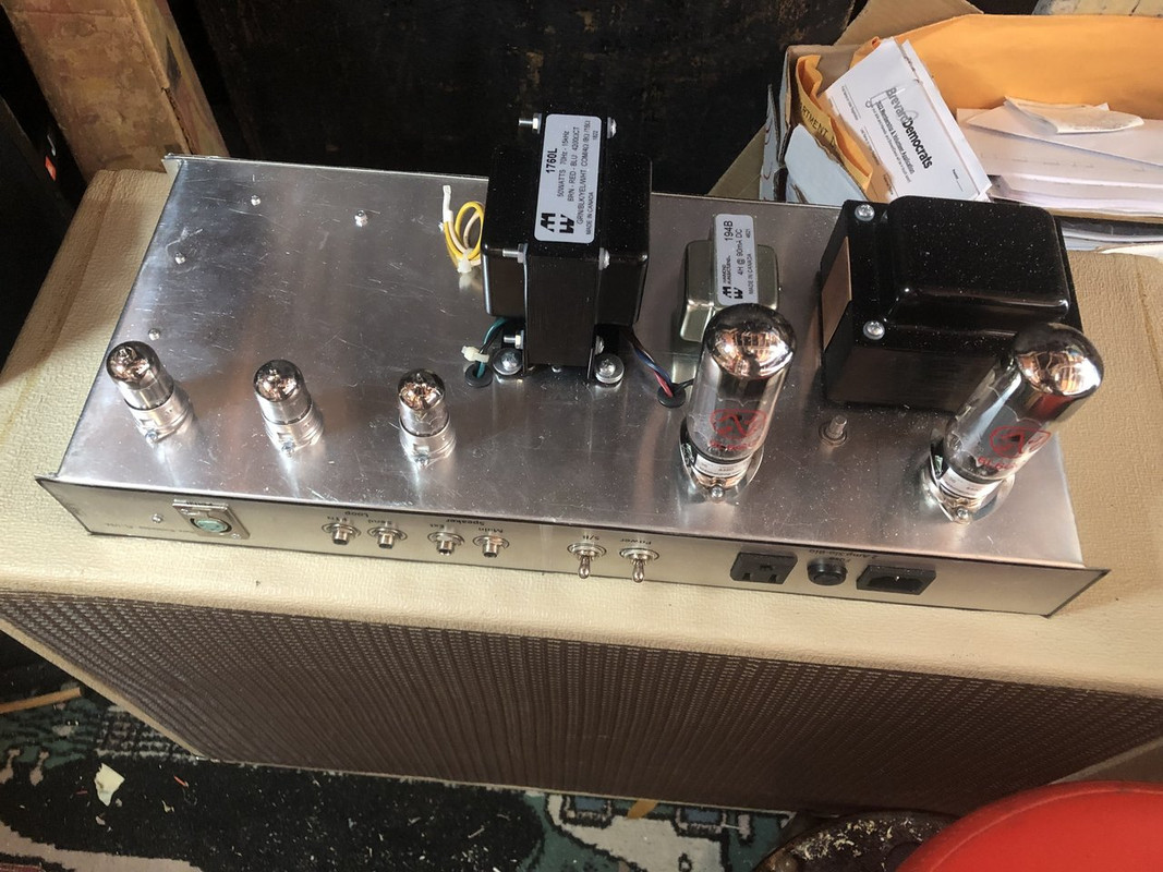

I’ve made some final (hah!) decisions on the electronics. I’ve decided to add a second relay for PAB. While the baseline second gen I’ve mostly used didn’t have one, the wiring seems simple enough.
This also forces me to finalize my foot switch decision. Because I’m using a 3 pin XLR, I’m going with a 2 button foot switch with no leds for status. I did run the led power line over to the switch but just capped it off (heat shrink) in case I change my mind in the future. I made a quick custom cord with an XLR on one end and a TRS 1/4” on the other.
The final overlook of the chassis is pretty messy looking, but the amp is dead quiet. No noticeable hum and only a bit of hiss in overdrive mode with the levels way up. I was expecting to have to move wires around like I did on my ‘Wreck builds. Sometimes it’s better to be lucky than good. If it ain’t broke…
I started the amp up with a set of psvane 12ax7’s, but I’m sure I won’t stay that way, especially for V1. I setup the FET somewhat unbalanced so there’s a bit of grit to it. I set the level so that single coils approximate the level of humbuckers in the normal channel.
