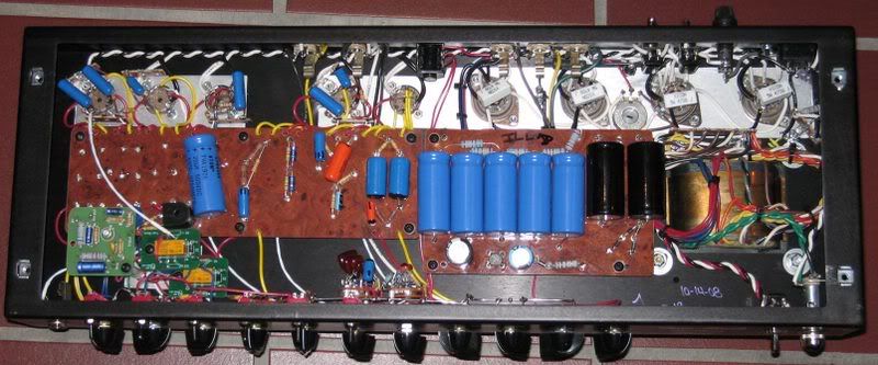

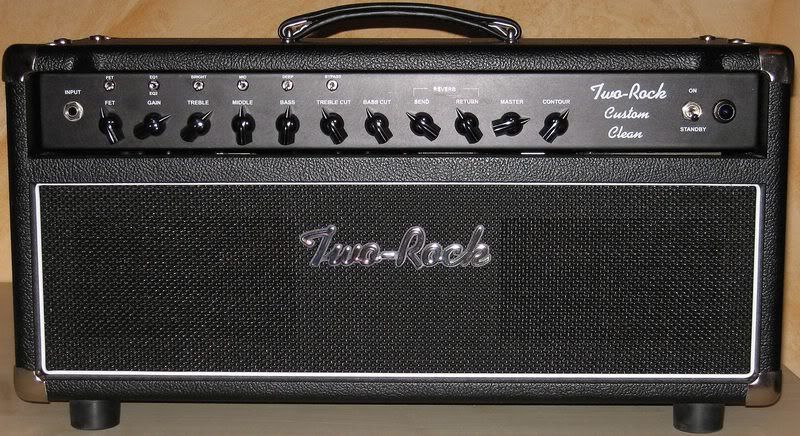

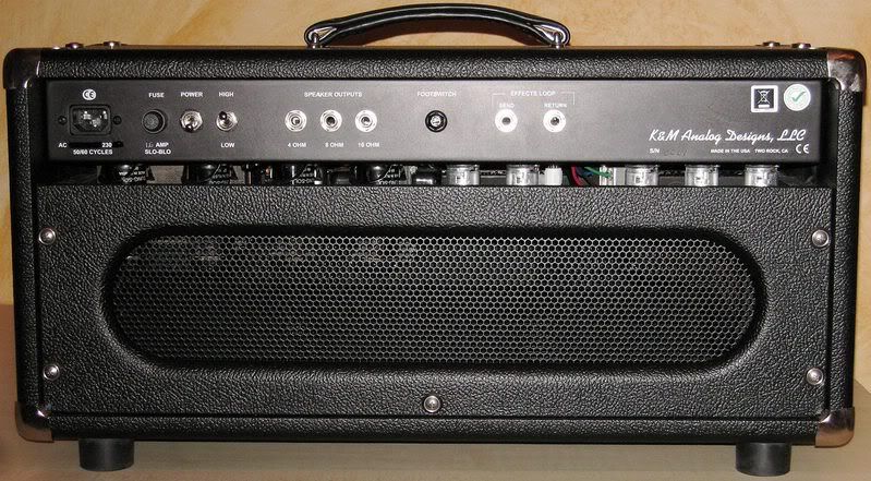

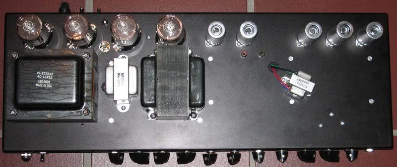

two rock's take on the sss, the custom clean... 100w
[IMG:800:436]http://i30.photobucket.com/albums/c301/ ... C100-1.jpg[/img]
[IMG:799:441]http://i30.photobucket.com/albums/c301/ ... 00Back.jpg[/img]
[IMG:800:333]http://i30.photobucket.com/albums/c301/ ... 0Innen.jpg[/img]
[IMG:800:338]http://i30.photobucket.com/albums/c301/ ... 00Oben.jpg[/img]

Thanks for those pics...kinda hard to see much of it because they mounted lots of stuff underneath the board...but better than nothing for sure.
What are those 'plates' underneath the tube sockets? The purpose?
