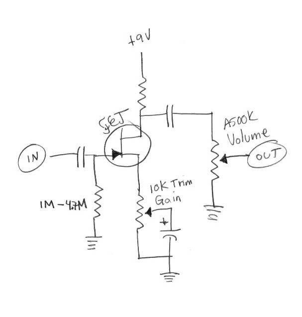

Instead of being a passive volume control, Dumble probably modded it to be an active volume control to avoid tone loss. The large input impedance on the active Sho-Bud vs. the passive one would in all likelihood contribute to the brighter sound. Technically it’s not a buffer stage since it does offer gain and I would have to guess it’s either a FET or a MOSFET stage because they’re simple to set up and offer high input impedances.
Here’s a simple sketch:
[IMG:607:637]http://i205.photobucket.com/albums/bb17 ... TStage.jpg[/img]
Yeah, I know I'm preaching to the choir!
*****Just noticed it says, "new FET installed on the back"*****
Re: Larry carlton's show-Bud volume pedal
Thank you!
I bought a sho-bud pedal.
I'll try it next week end.
