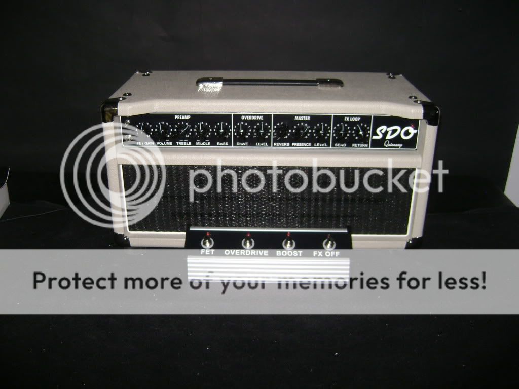

Y not add both?
768]http://i444.photobucket.com/albums/qq16 ... Ofront.jpg[/img]
768]http://i444.photobucket.com/albums/qq16 ... DOBack.jpg[/img]
Regardless, yes most guys add the D-lator to just put reverb/delay (or other time based effects) in the loop. If you're not really someone that uses anything other than Reverb, then just add the Verb and do a passive loop before the Verb for use with an external Dumbleator if you ever want to use anything else.

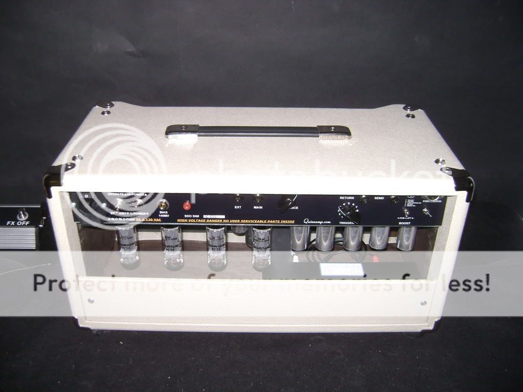

My Quinn actually has 6 preamp tubes, (one is between the Pwr tubes).
Has a Mercury Mag Fender Twin Reverb Pwr Trafo with extra Relay tap, and AFAIK a Heyboer Plexi style OT (4/8/16 ohms).
V1 Clean
V2 OD
V3 D-lator
V4 Verb Driver (12at7)
V5 Verb recover (12ax7)
V6 Phase Inverter
You can kind of see where the tube is below:
V1 Clean
V2 OD
V3 D-lator
V6 Phase Inverter
