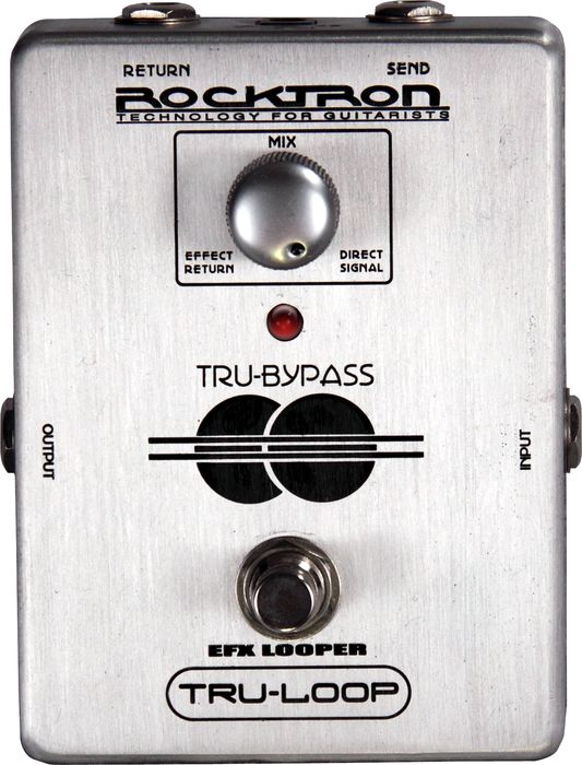

bfmb - isn't the buffering on this Rocktron unit just at it's send and return? Got it used and it sounds uncolored to me on the through....
Anyway - I am hoping your 25k linear solution will eliminate these extra boxes for me. I will know soon.
