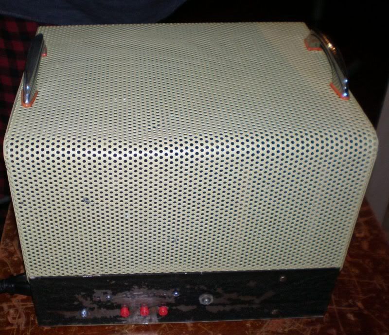

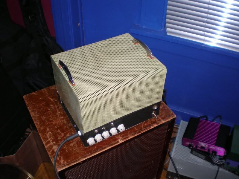

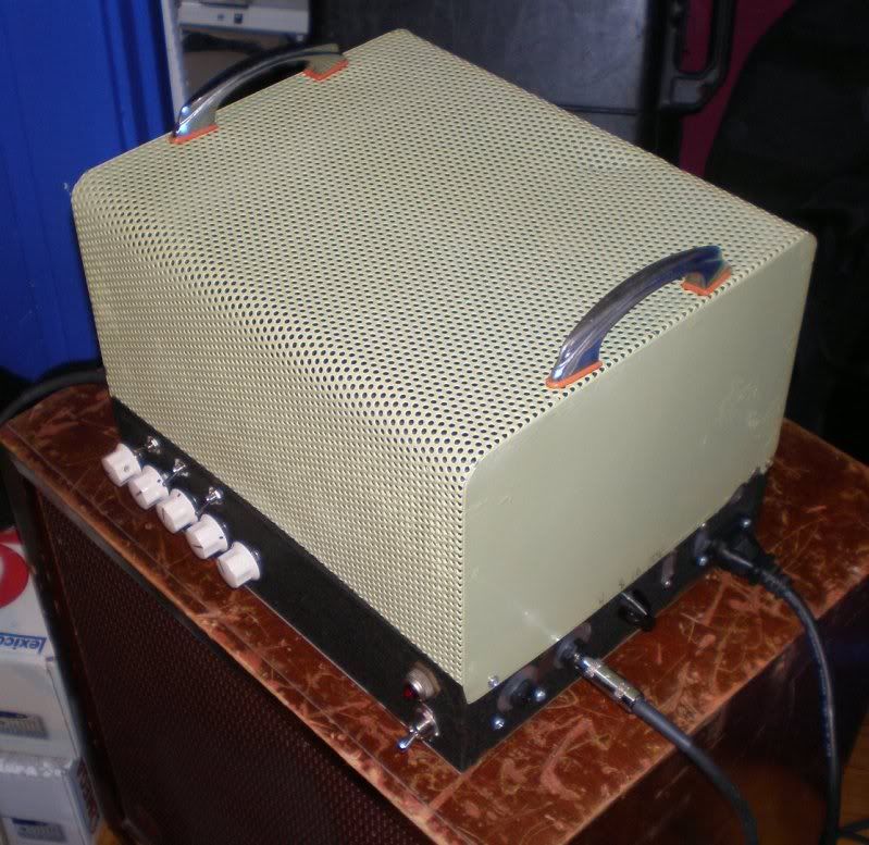

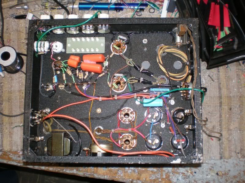

So, the wrong fuse was the problem upon turn on.
I have got the amp up and running, though I probably have a little tweaking to do. This chassis is not exactly conducive to doing exactly what I want and I ended up removing the presence control and putting ing a master volume instead. I wired up a resistor and cap as if the presence was all the way up, which is how it sounded best. This tells me I may need to increase the resistor coming from the 16 ohm tap.
Even though the amp does not produce any major distortion when using the master volume, the amp is more manageable with it. Before, it seemed to go from a whisper to thundering very quickly.
I put in the mid-boost, bright and deep switches. I don't know that this amp would benefit from a pab.
It sounds very good and once I am done messing with it, I will record some clips.
pics and schems(the gut shot is from early on and a lot changed since then):
