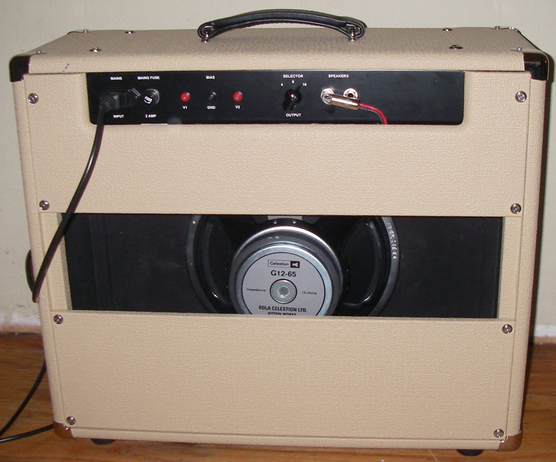

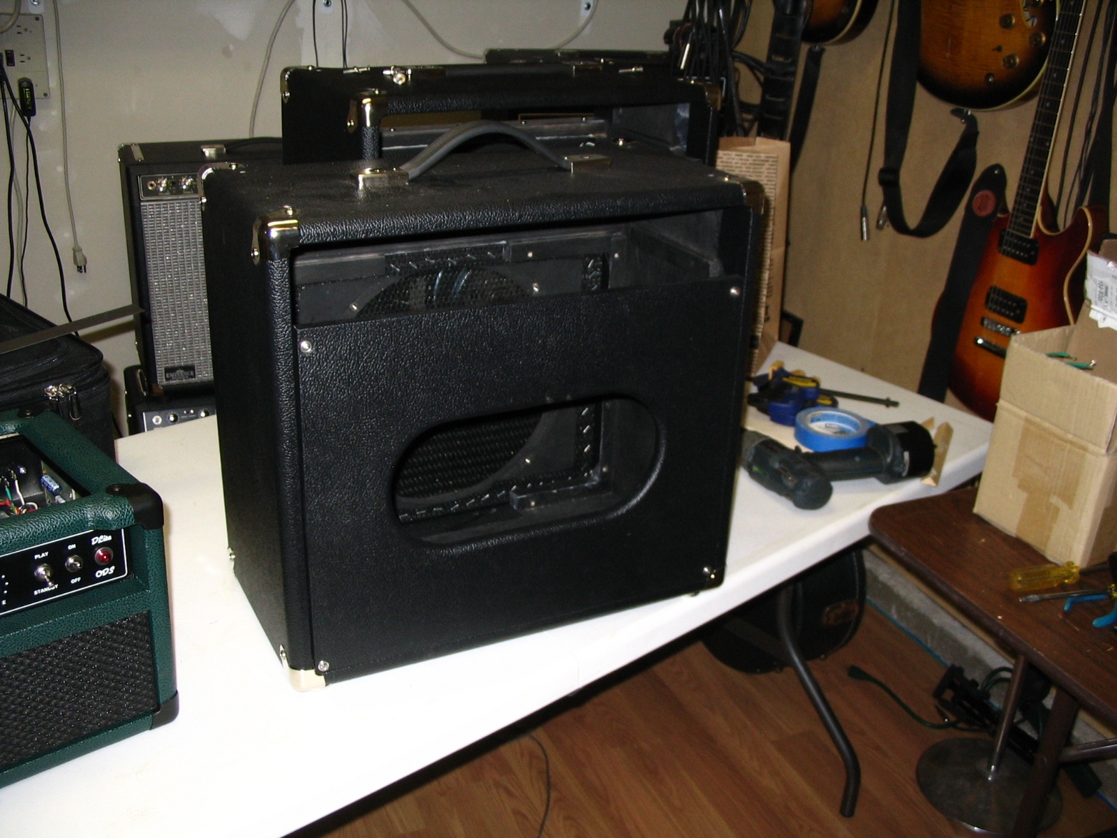

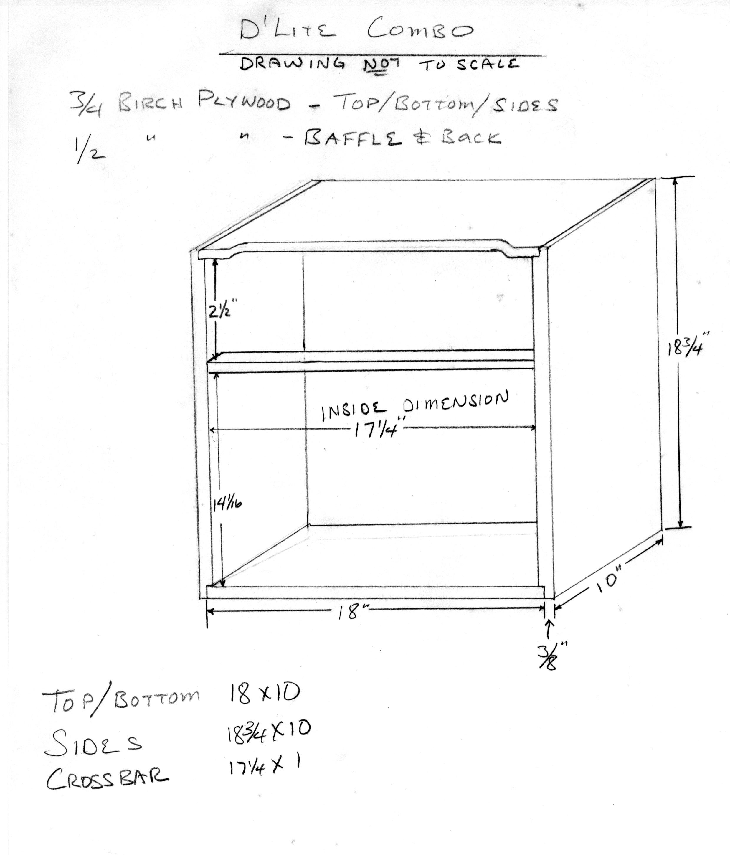

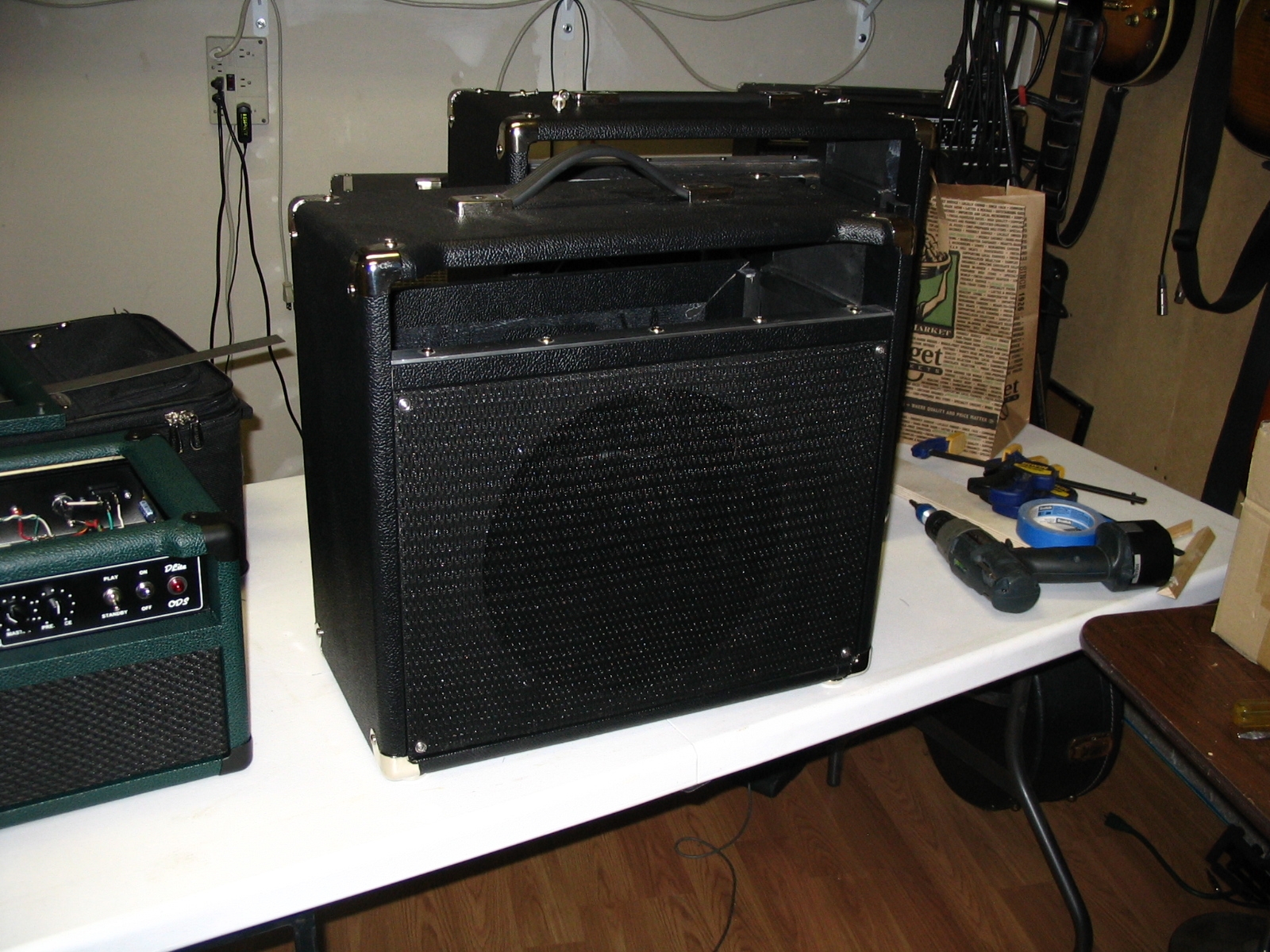

Found this stuff going through an old hard drive. It's from back in the early days of the Brown Note era; I can't vouch for its accuracy. One drawing, two photos of a cab; I also saved some text, which I think went with the two photos: "This 1X12 cab is made for the D'Lite 22. It measures 17-1/2" hi; 18-3/4" wide; 10" deep. It's shell is 3/4" baltic birch. The speaker baffle is 1/2" birch. It has Fender-style pebble grain tolex, nickel-plated corners held on by nickel-plated trusshead screws. The rear baffle is 1/2" birch and has an 11" x 5" oval opening. Cover is included."

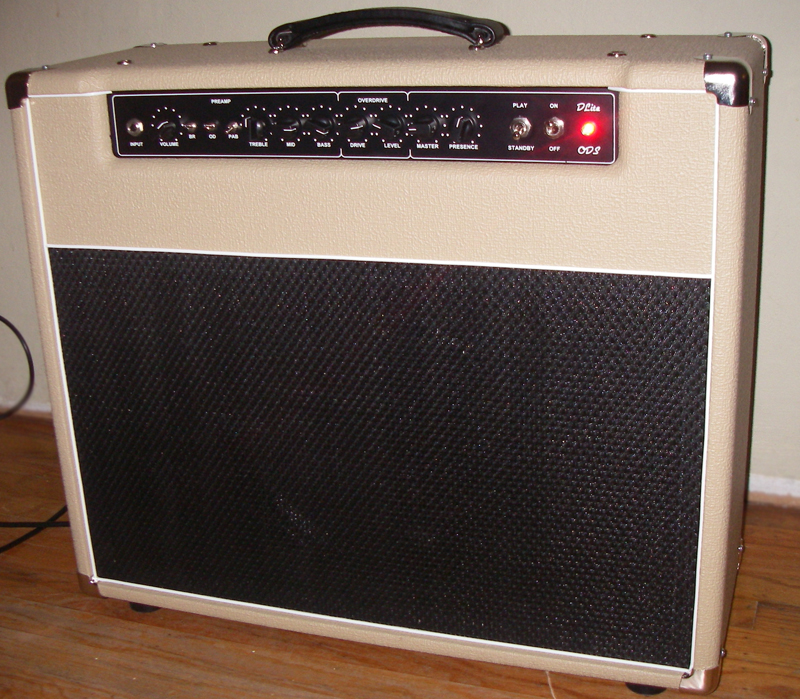

There was also a widebody version: "widebody Cabinet Dims. Are: 24" WIDE x 20" TALL x 9.5" DEEP"
