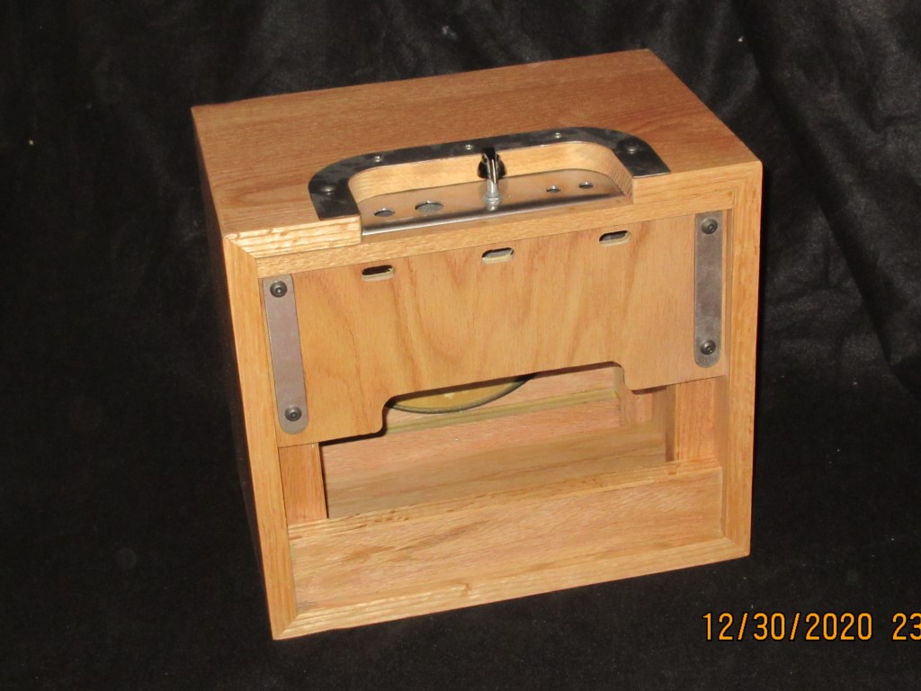

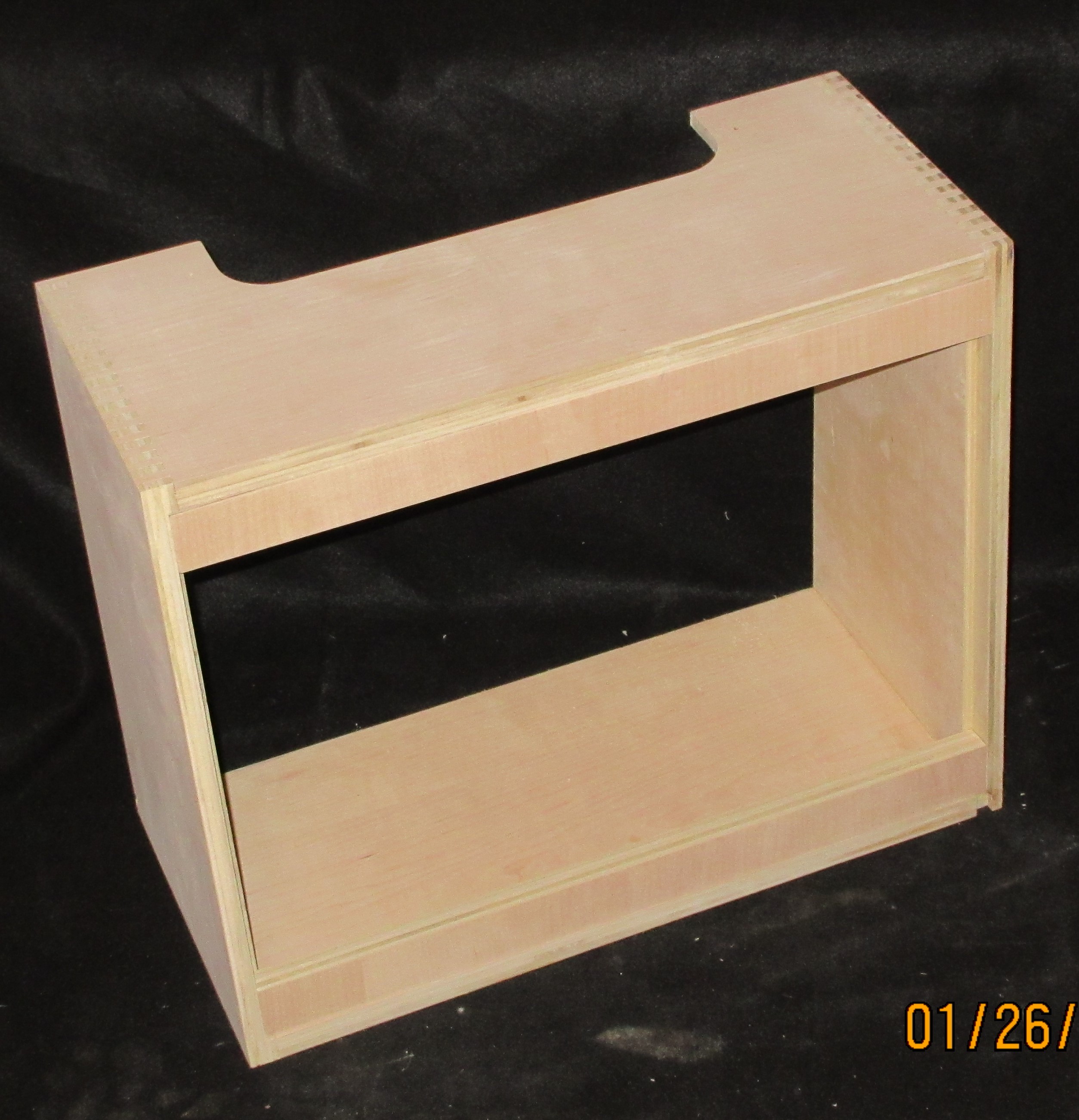

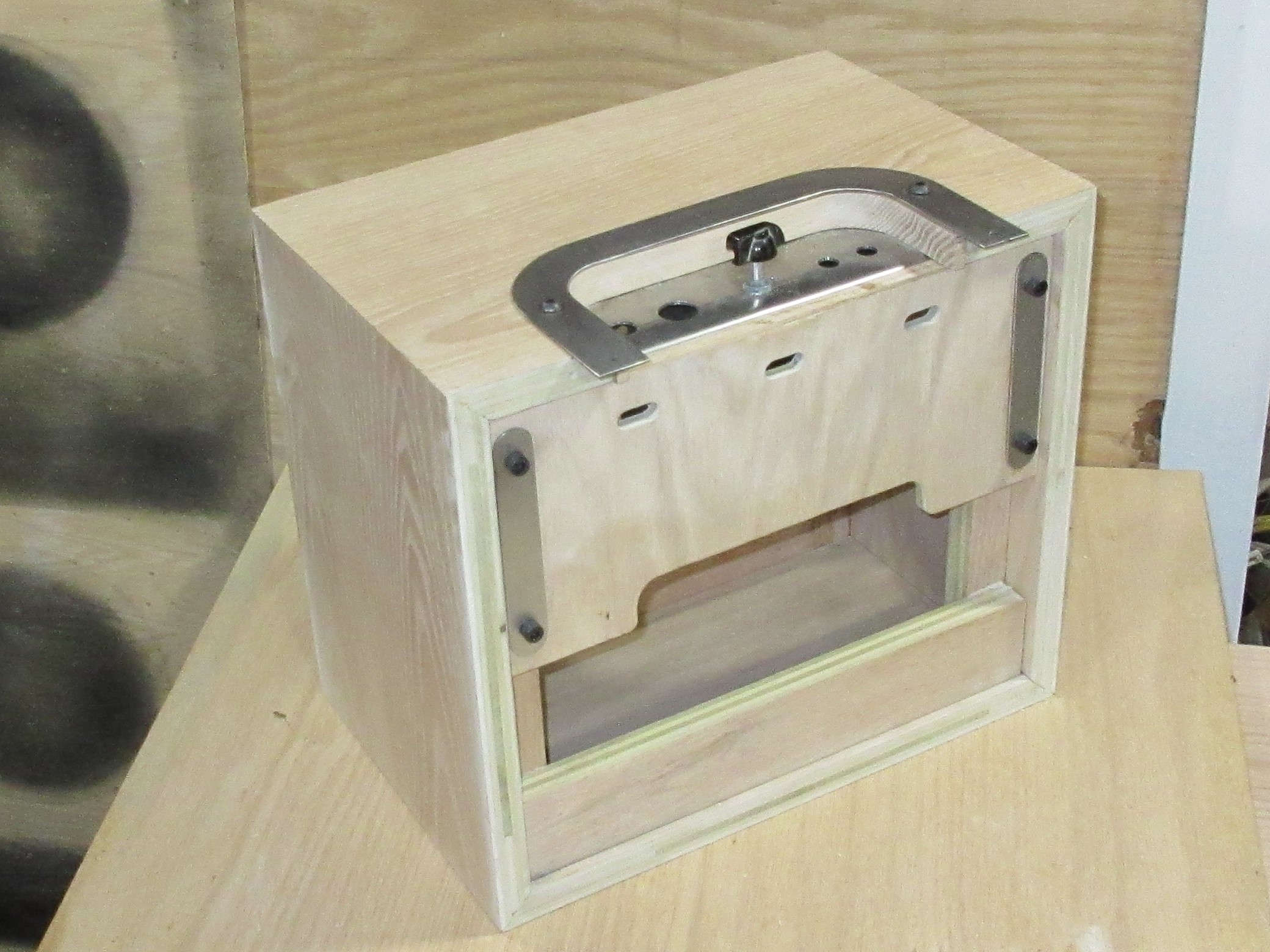

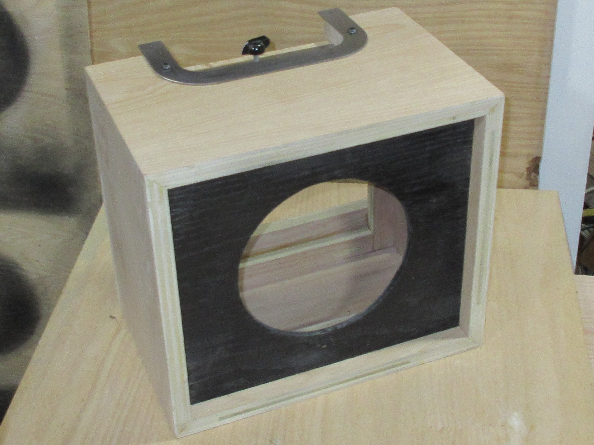

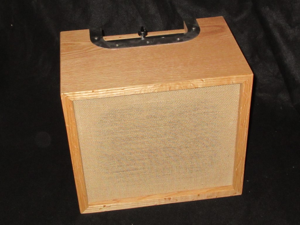

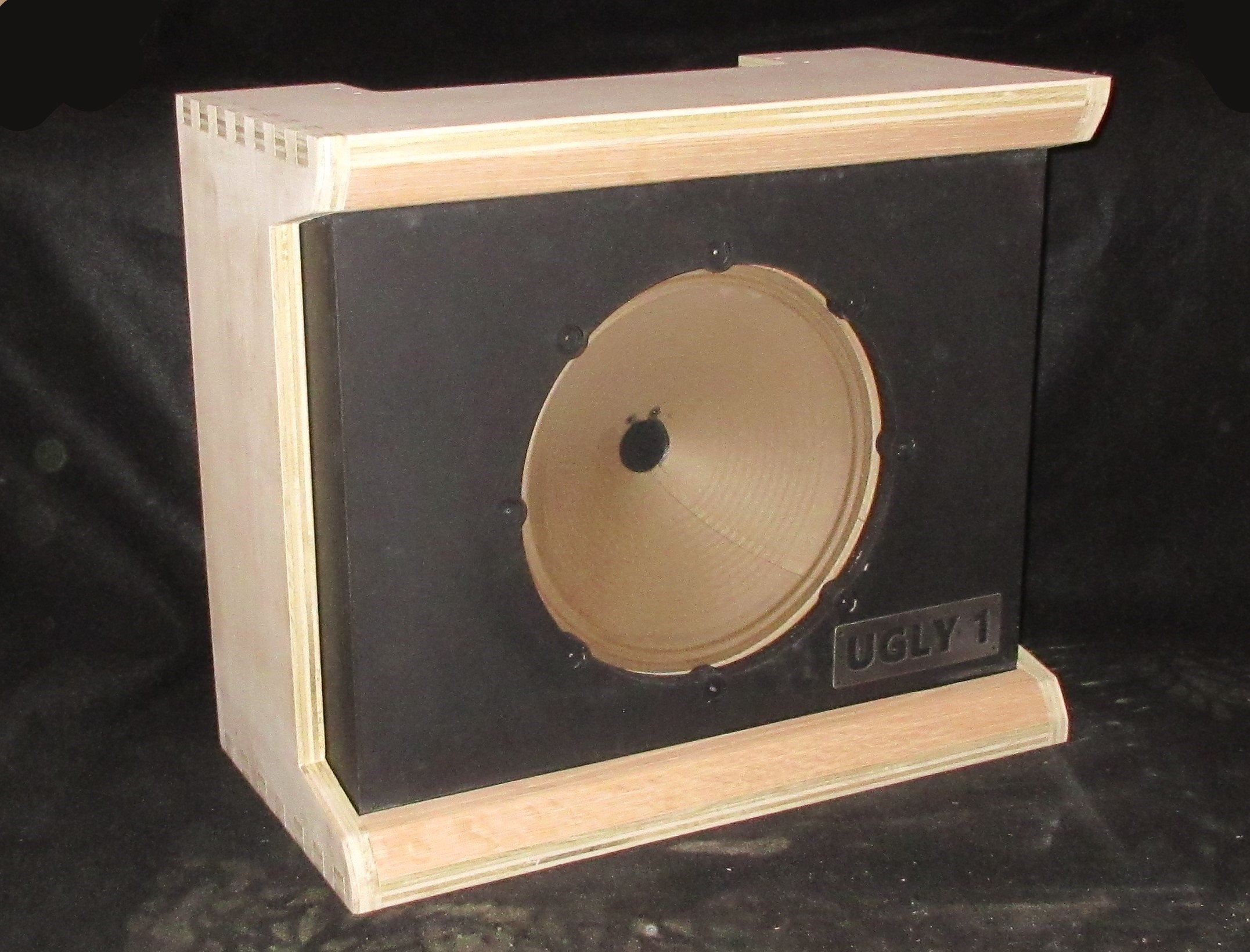

Fender Champ-like build around a NOS 1976 Jensen 8" speaker and tubes from a collection purchased at a local estate sale. Cut from on CNC router and plasma table. Purebond 0.75 in. oak plywood, oak, and stainless steel.

I'm still waiting for someone to model a true Tweed Deluxe narrow panel cab but that looks cool...

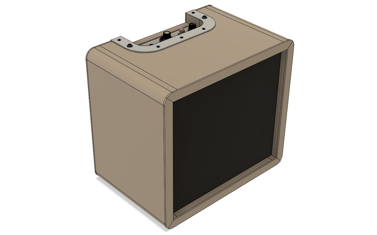

Your cab seems well worth a rounding edge job, also.

Point to drawing for a Tweed Deluxe narrow panel cabinet. Doesn't take much effort to get something into CAD.
Can't round edges without previously having added blocks to joints as outer panel verniers are thin. And I'm not wood/metal worker - if components don't come off CNC router, mill, lathe, or plasma it isn't going to happen.
Champ-like not a clone. Not into Fender's (or anyone else's) Early American Salvation Army style cabinets.
This is test bed for DSP that will toggle in and out in place of initial pre-amp. Picked Champ schematic due to lack of tone circuitry and having all the parts except PT. Neighbor's kid will get plain amp when I'm done with it.

I'm not really something of an old fashion guy but I love the object "5E3 cab".
I used to do some modelling in the early 2k years but CAD software have evolved into something even more complex and I find it more usefull to use my router than using my time to learn CAD programs...
(to build 2 cabs per decade)
To each one his own bias...
If you master CAD, of course...

Did version of same box with rounded corner inserts I mentioned with slightly different rear panel for a local but haven't cut yet. Someone else wants the square box but for 12" speaker and longer/wider chassis.

Don't really know which cabinets are which. I'm preparing to do batch of 5E3-like cabinets for a local. Will be 0.75 in. but appearance from front will look like it is made from 0.50 in. material (which I don't use). Working from someone else's copy/clone and varying dimensions found on the web. Steel chassis will differ due to tube set and iron. Limiting CNC to 3 axis single sided cuts and no tool changes so its easy for anyone to cut - otherwise design would differ.I'm still waiting for someone to model a true Tweed Deluxe narrow panel cab but that looks cool...
