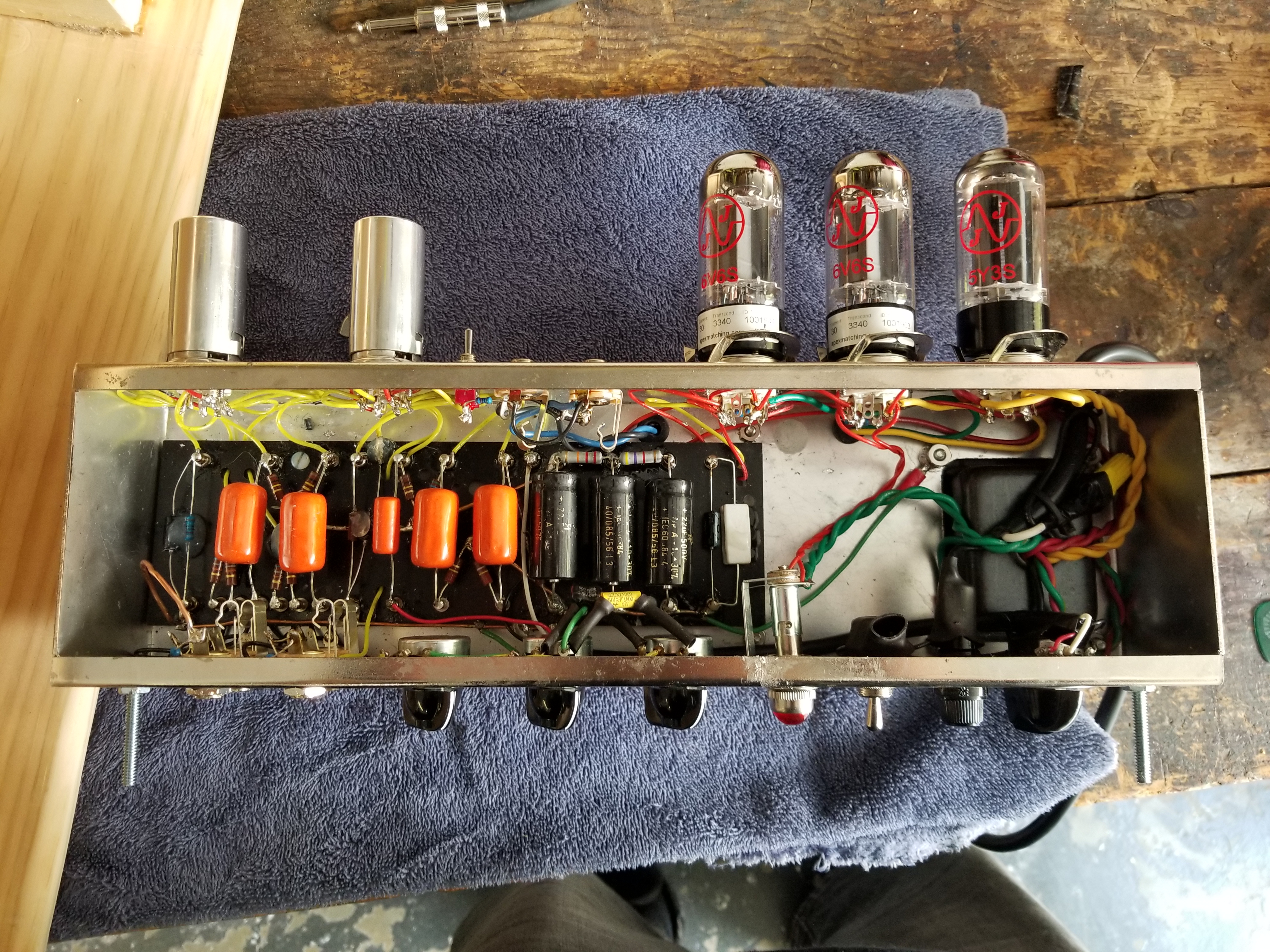

I built two 5E3 amps, one of which I proceeded to take apart and put back together four times so far adding/removing mods and the other I plan to keep vanilla (or close to it).

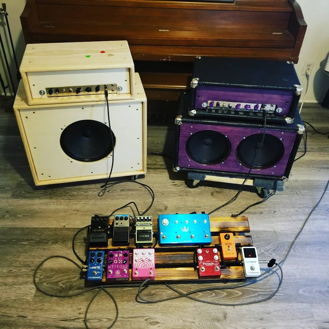

I wanted the cabinets to kind of match the attitude of each amp.

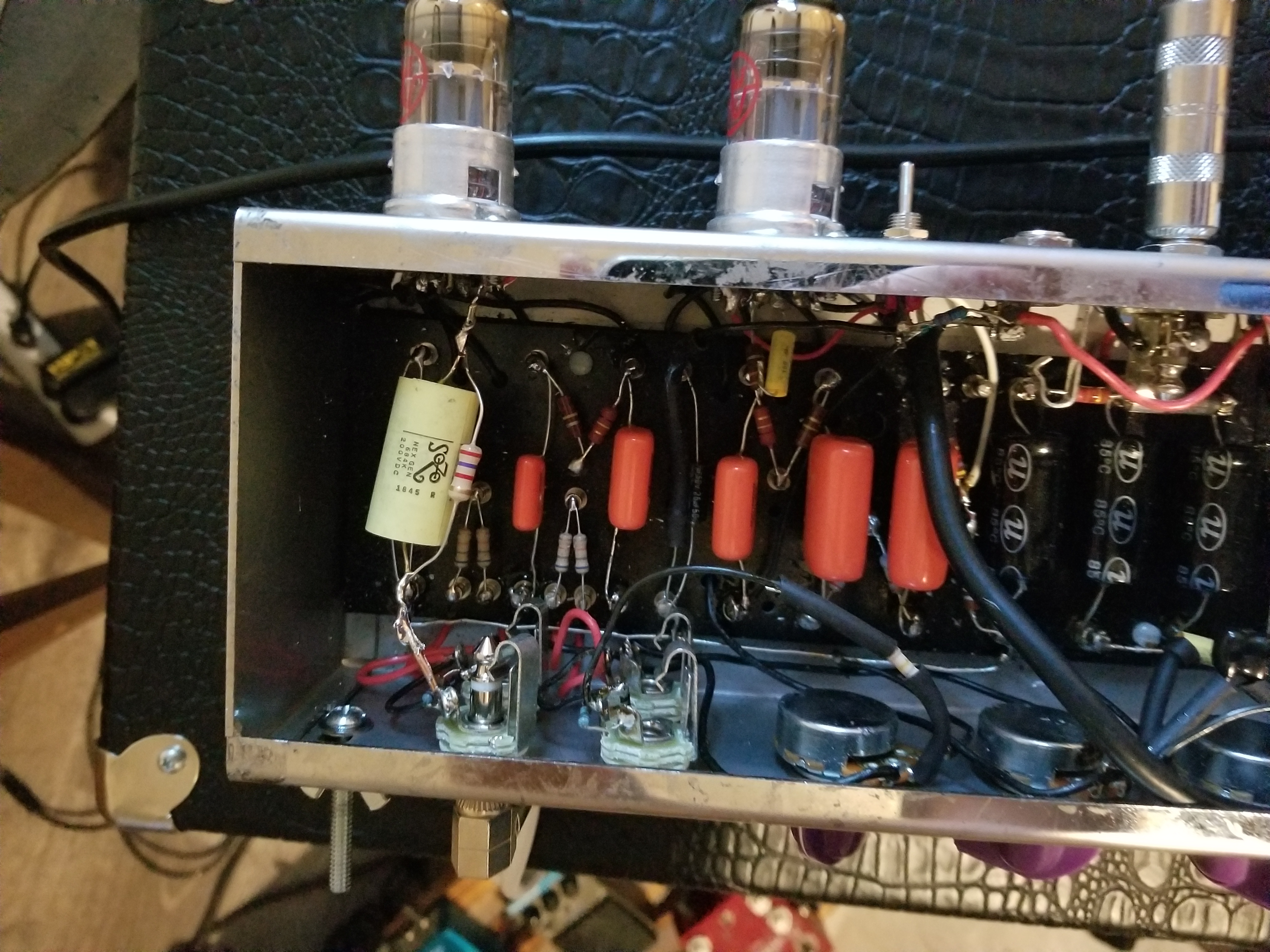

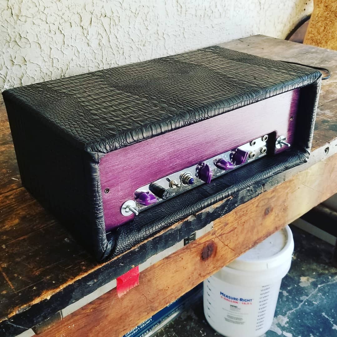

The purple one is a simplified Tweedle-Dee (layout from Rob Robinette's site) with a post-phase-inverter master volume, switched negative feedback, cascaded channels, and the normal channel has been converted to a high-gain lead channel. I covered it in vinyl gator skin I bought a Joann's. The cabinet houses 2 10" celestion creambacks.

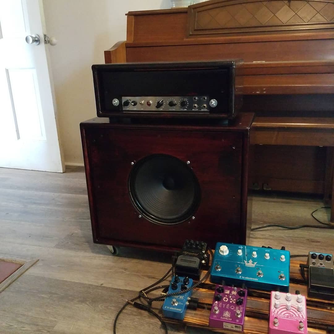

The vanilla one I made the mistake of trying Minwax PolyShades which I found very unruly and I hate the outcome. I will be painting it piano black. Ultimately what I was going for was a more "dignified" or "conservative" look to match it's more traditional tone. The circuit is a vanilla with an added switched negative feedback and post phase inverter master volume. The cabinet houses a celestion G12H anniversary.
For the heads, I had to figure something out to attach the chassis to the cabinet, so I attached a couple of bolts to the mounting holes and then used wingnuts to attach the chassis to the head face-plate. I think what I would rather do is weld a nut to the inside of the chassis so I can put a screw in from the front and not have those weird looking wingnuts there.

Hello Prof.
I’m a bit late to the party but I’ve only just joined this Forum.
Your wing nut problem could be solved by using “Captive nuts”. These are a square nut held in a cage. You file out the chassis holes to a square shape. The cage clips inside the hole. The nuts can move about a bit so accuracy to .001” is unnecessary.
