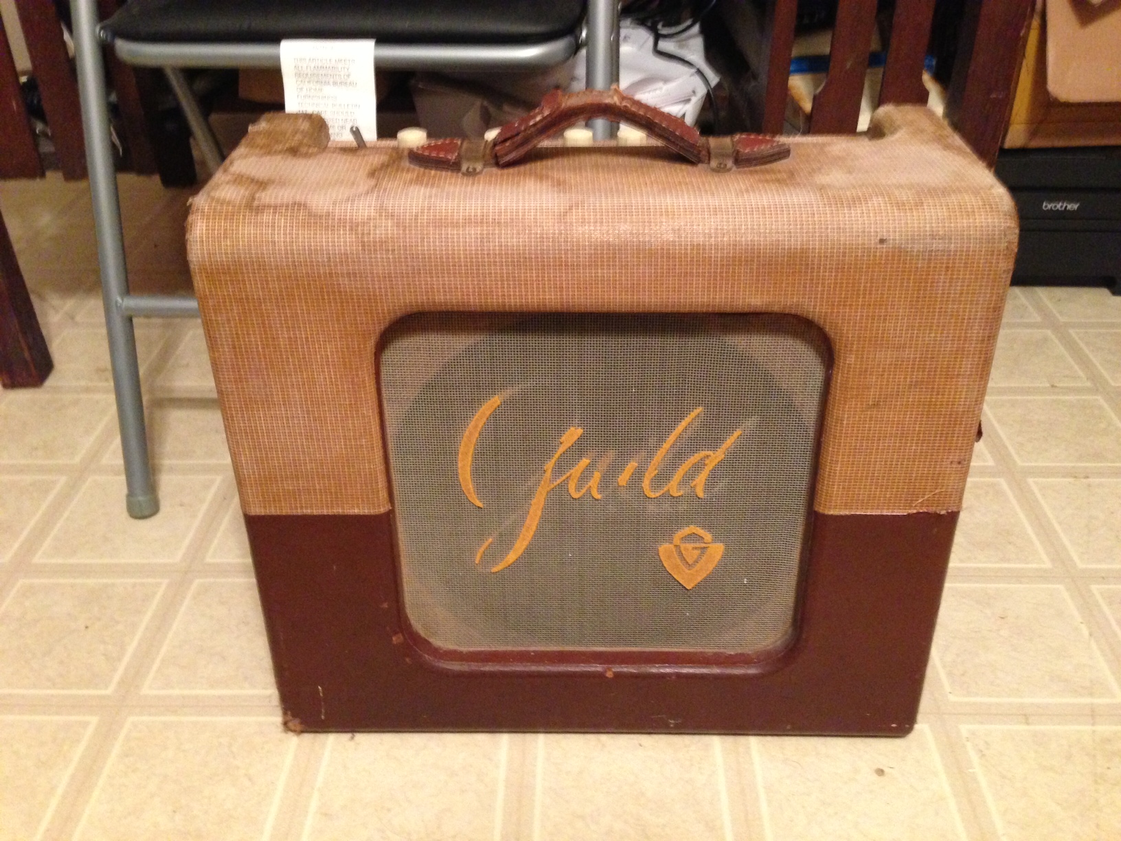

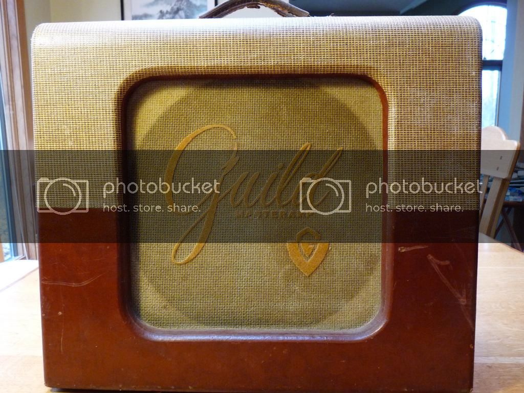

I have a '55 Guild Master amp that needs the grill cloth changed. It doesn't have the original. I was thinking, why not do it like the original.
Getting together a sort of mask should be easy enough, like a stencil. Just have to match the font and conjure up the pick shaped graphic.
Should I use 3M adhesive spray through the mask?
Here are a couple of examples of what I'm trying to accomplish:

That bottom amp is mine, btw. I have two of them and two of the 4X 6V6GT versions. Message me if you need good photos of the grillscreen.
