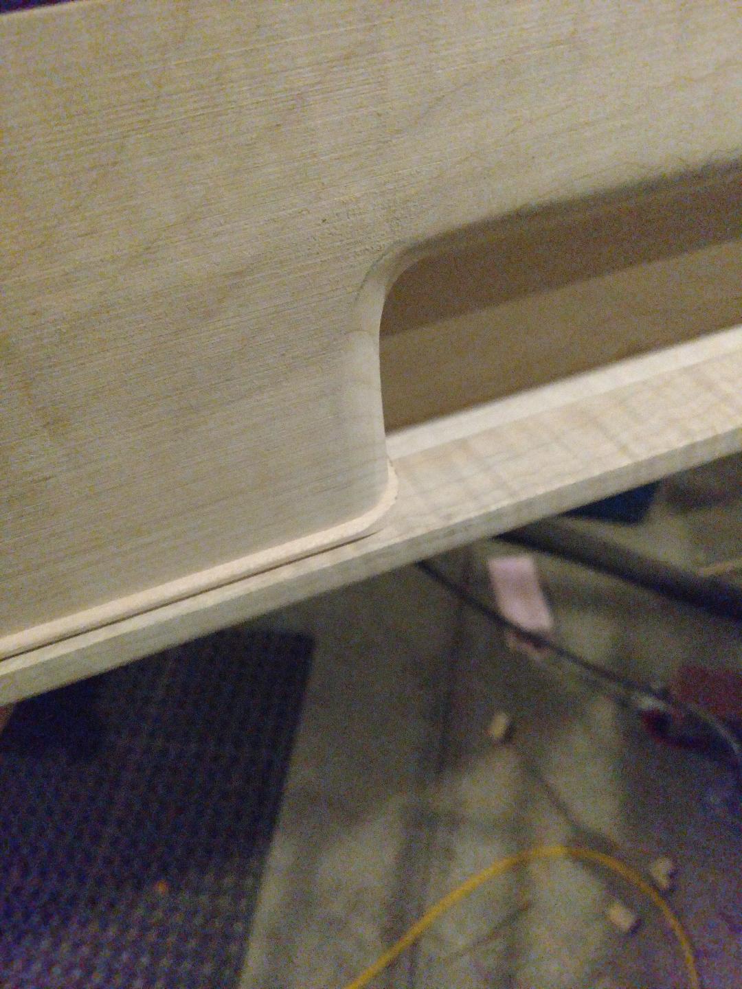

I use walnut blocks to simulate the plastic corner protectors. Also the bottom is BB ply with book matched maple caps and 'fake' fingers to cover the ends.
Sanded with the one inch edge round overs - I planed in a 1/2" 45° bevel and sand the rest in with 60 grit in an orbital sander. Takes a while but no tear out and more importantly no neighbors whining about the noise.

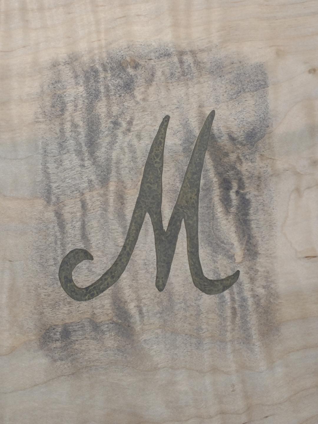

The logo will be filled with either gold or silver - I did a test with some 'brass' powder with epoxy and it didn't excite me. I've got the gold and silver with table grade vs. industrial grade epoxy coming later this week to experiment with.

I'm experimenting with what to fill the logo - this is brass powder. It looks better on lighter wood - a bit 'stealthy'.
Brass & epoxy filled, dyed black and sanded back

This looks fantastic; I love the color! Did you use a CNC to route the logo?
Re: Fiddleback Maple JMP 2203 headshell
Posted: Thu May 21, 2020 2:57 am
by Geeze
A dremel with a Stewmac plunge router base and a 1/32" tapered bit. Took about an hour.

Piping time for the 2203. It's been beveled, rounded, drilled and countersunk for screws.
Fitting the sides -
The top strip -
The bottom 'wraps' -
Glamour shot -
Now the piping will be bleached and set aside for assembly after the face plate is dyed and sealed. On to dyeing and sanding the case whilst I wait for the !!**##!&*&^!!!! epoxy and colors I ordered way too long ago - listen to the old guy's first world problems...
