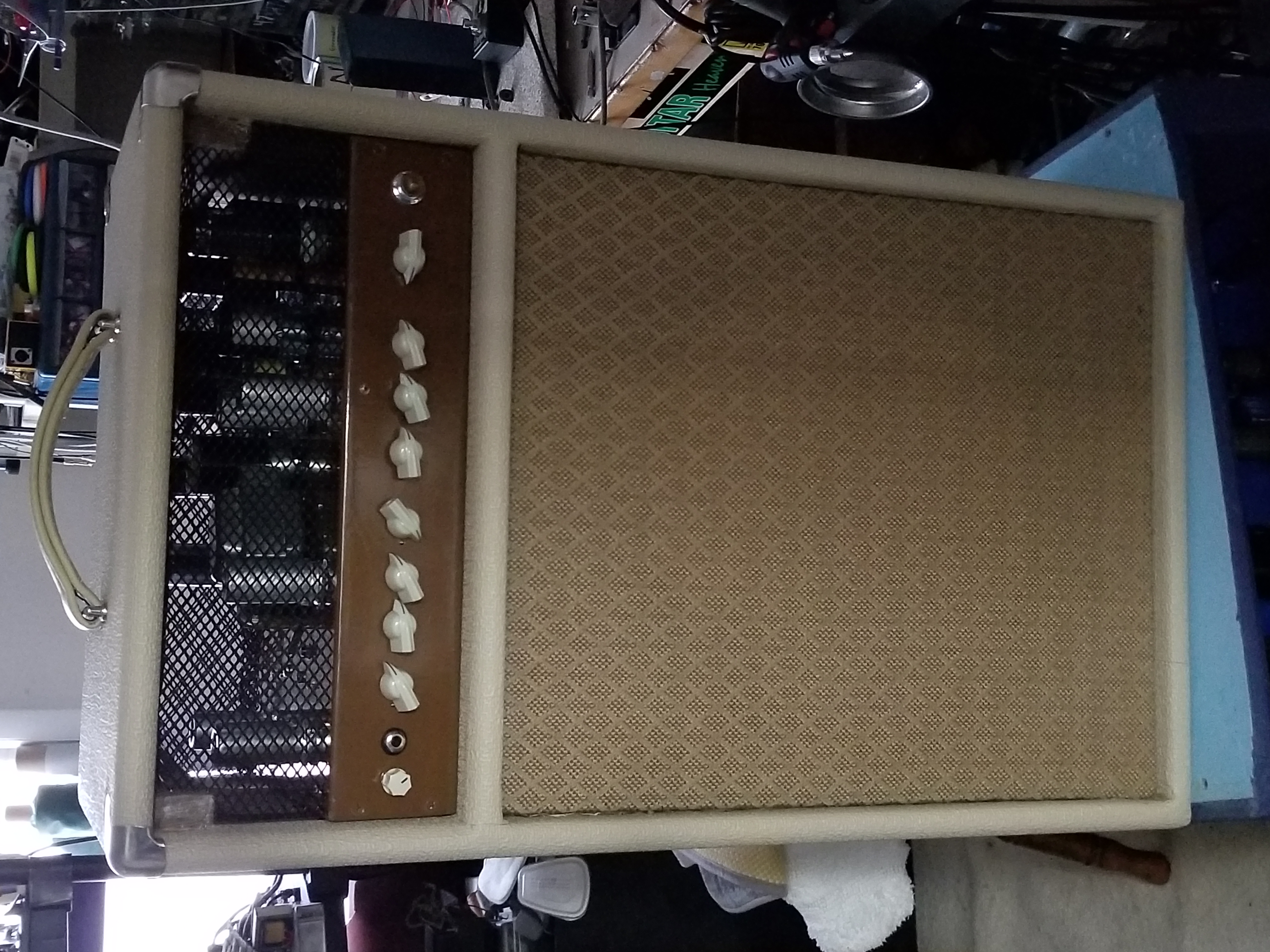

This was all with the floor glue I mentioned. $8/quart, no fumes, soap & water cleanup, good open time.ImageImageImageImageImageImageImageImage

Nice work on those cabs, jasonwhitecountry. Is there a specific brand of the stuff that you use?

drew wrote:Nice work on those cabs, jasonwhitecountry. Is there a specific brand of the stuff that you use?
Only one I've tried but I'm sold on it. From Lowe's.Image
