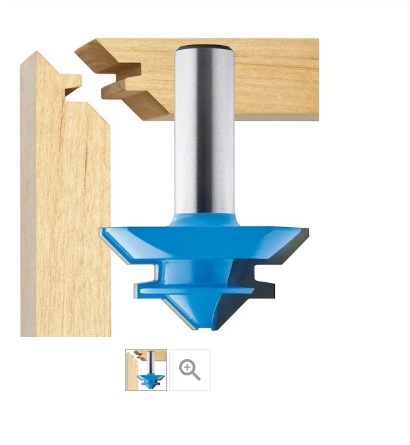

Has anyone tried this method?

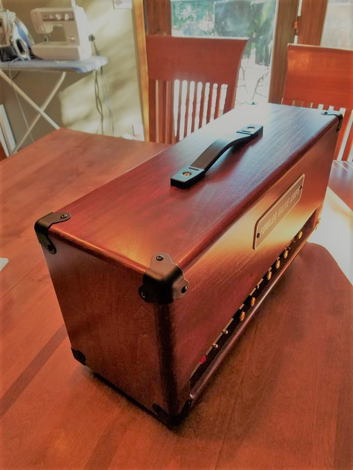

That's how my last cabinets were build by my friend.

I've been reading up on these miter joints and the consensus is they are really strong BUT they need to be properly set up. Some folks say it takes them about an hour to set the router depth and such. Once the joint it made, seems pretty easy to clamp. I'll likely go this route with the same locking miter bit. Hope that helps! Share your results!
