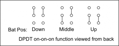

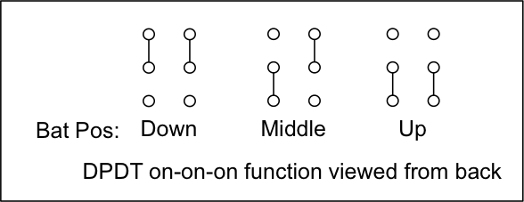

Can anyone here guide me to reference source material so I can see if/how a rocker can be used to switch between speakers, and to use for both? Or better yet, pamper me and show me a diagram that translates wiring from a 3 way toggle to a rocker or slider?

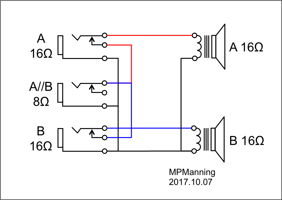

Here's an example of how I use the toggle for speaker switching - it's quite effective.
And here's a potential alternative, which would require some jack-play rather than flipping a switch. Unless I'm missing something, 16Ω speakers would double the values of everything printed on the plate - meaning 32Ω in mono. I don't know if they make a plate that considers 16Ω speakers...
