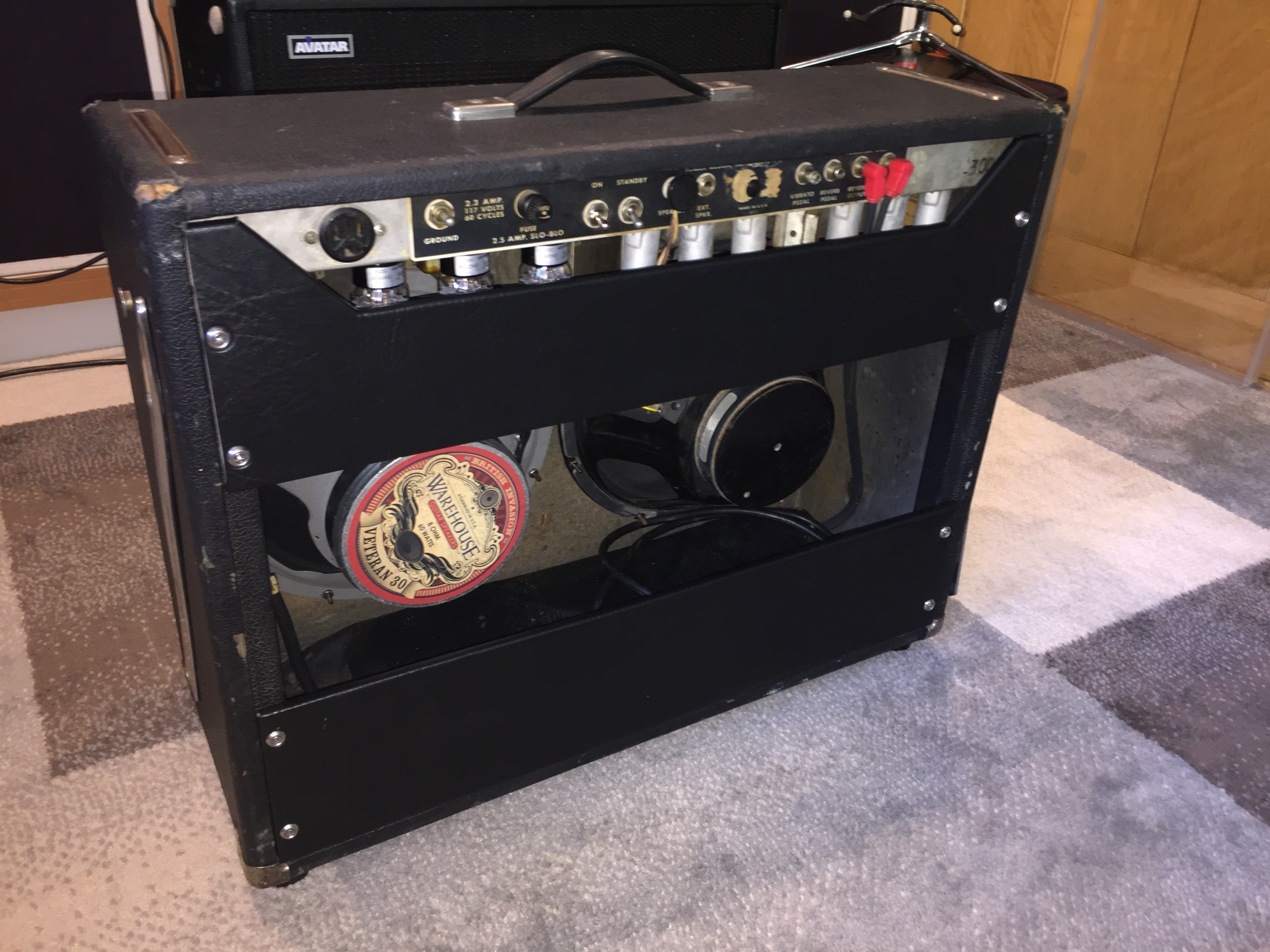

Re: Custom back panel idea for twin reverb.
I decided to keep my '71 Twin Reverb, so I made the missing back panels from 1/2" birch ply and vinyl.
Also spent some time with a toothbrush and 409 cleaner and removed the years of dirt. Shiny!
