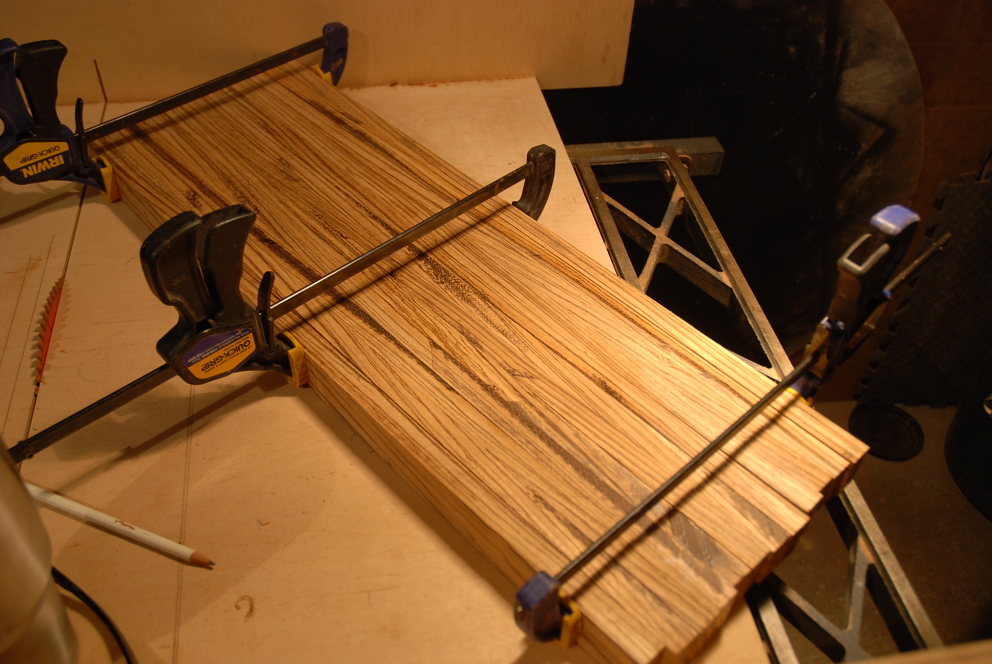

failed attempt to keep 'squirmy' wood straight.  Zebra wood is not a happy wood - it loves to warp and cup after cutting.
