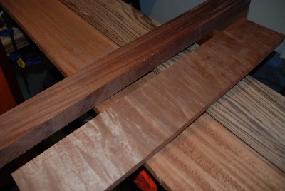

I cleaned my shop and the void spoke to me. Loudly and often. I have a 1960A built a couple of years ago and just had to have a B cab for the full stack appeal. This one has two types of African mahogany and zebra wood trim. I decided not to use the sapele as the cap.

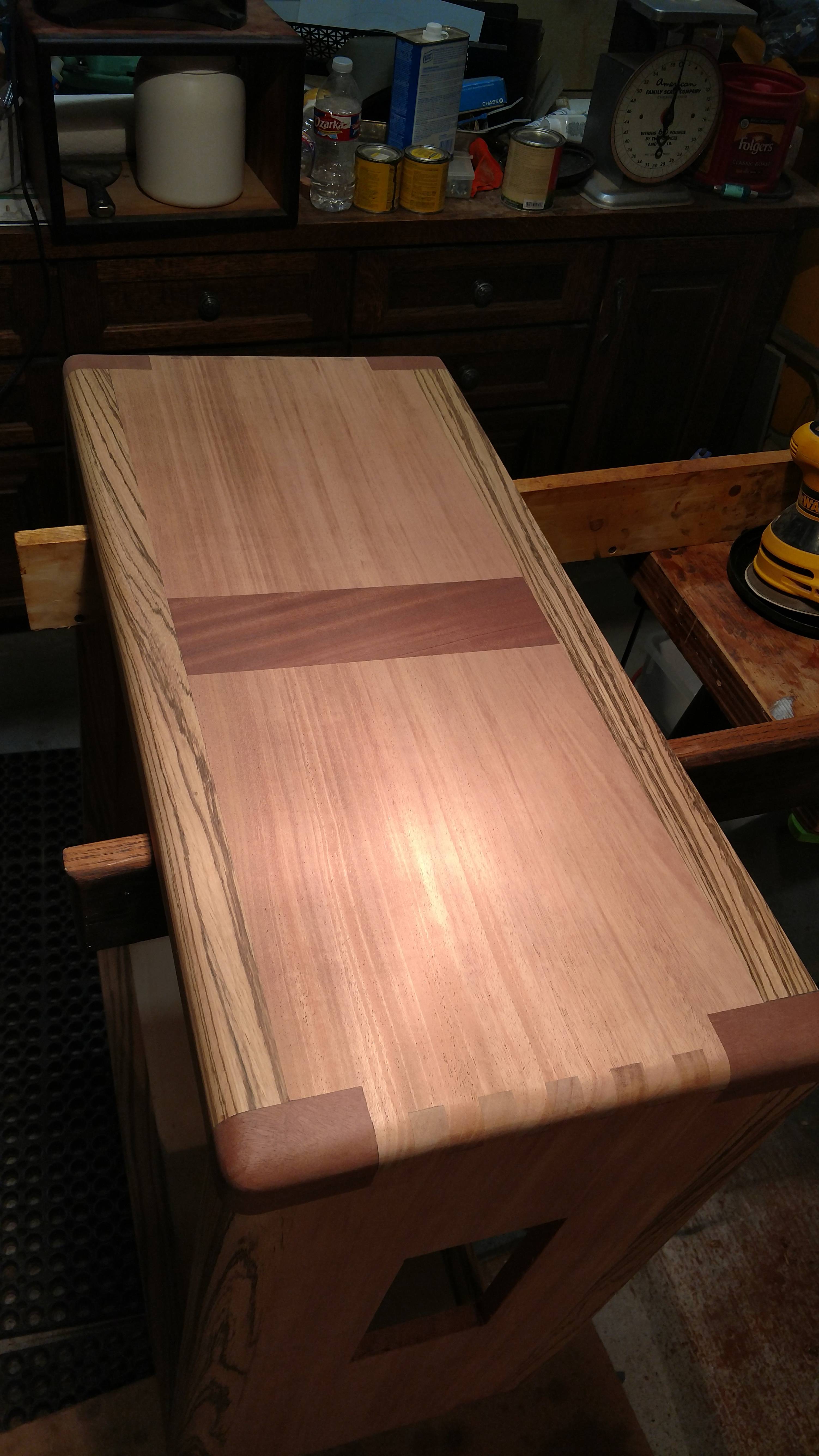

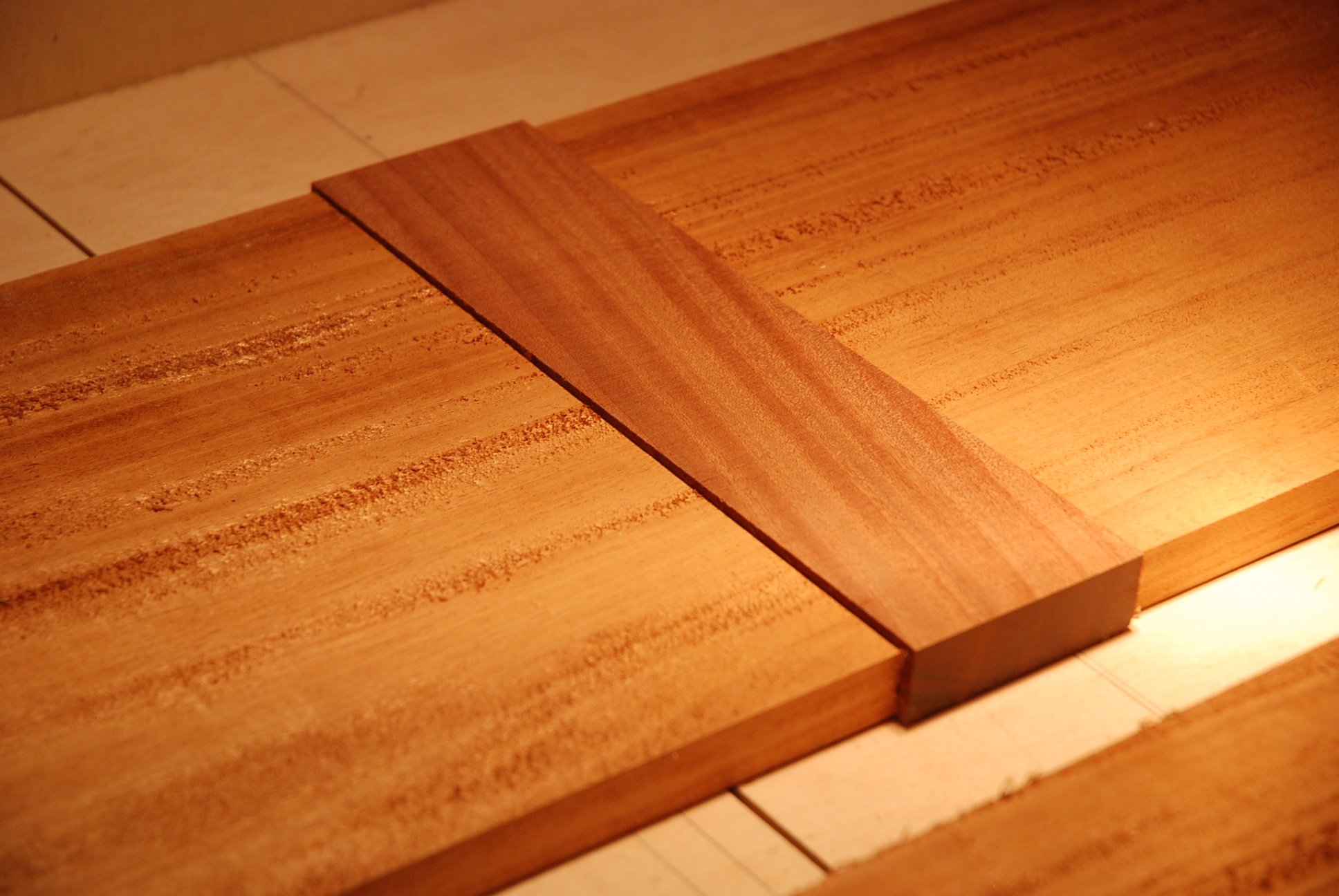

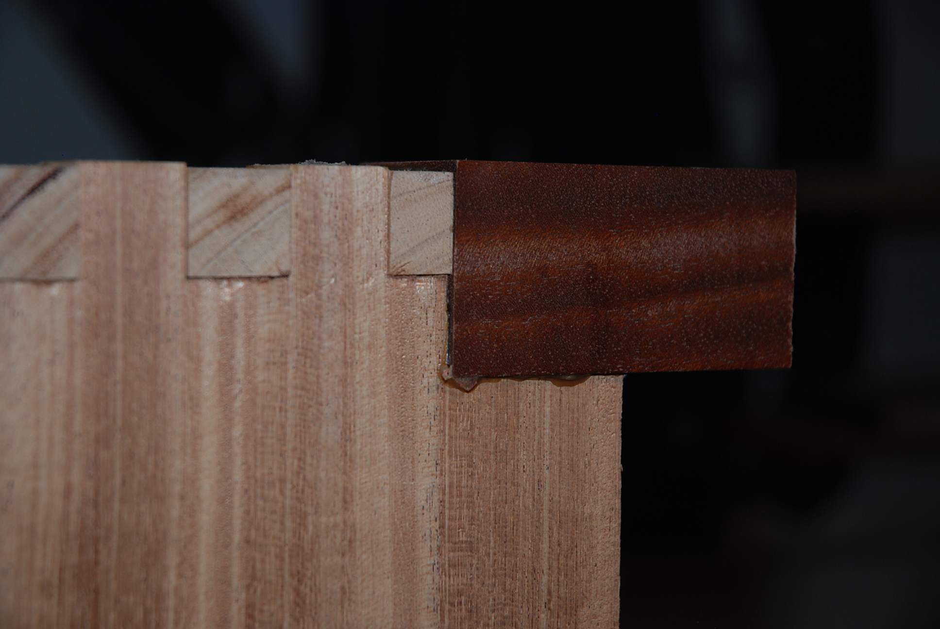

The main stick of AM wasn't long enough so I stuck in a cap of a contrasting AM.

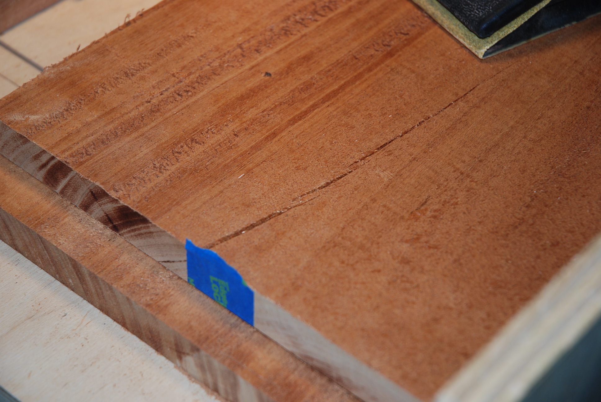

Splits on the end.

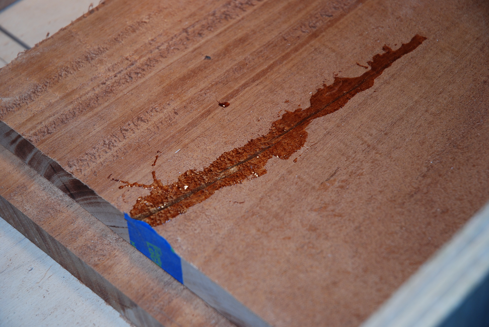

Epoxy to the rescue.

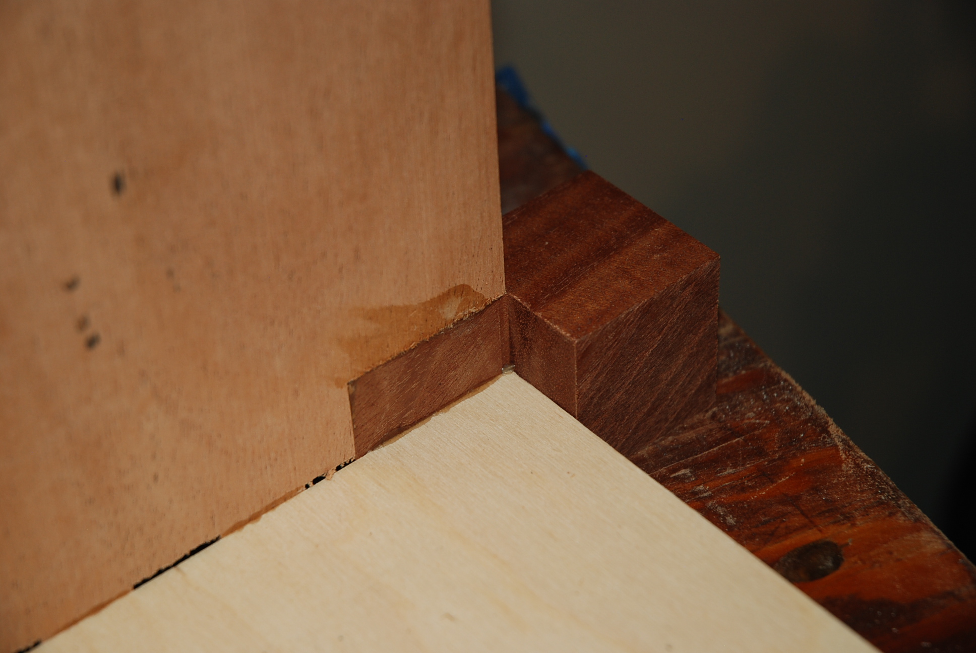

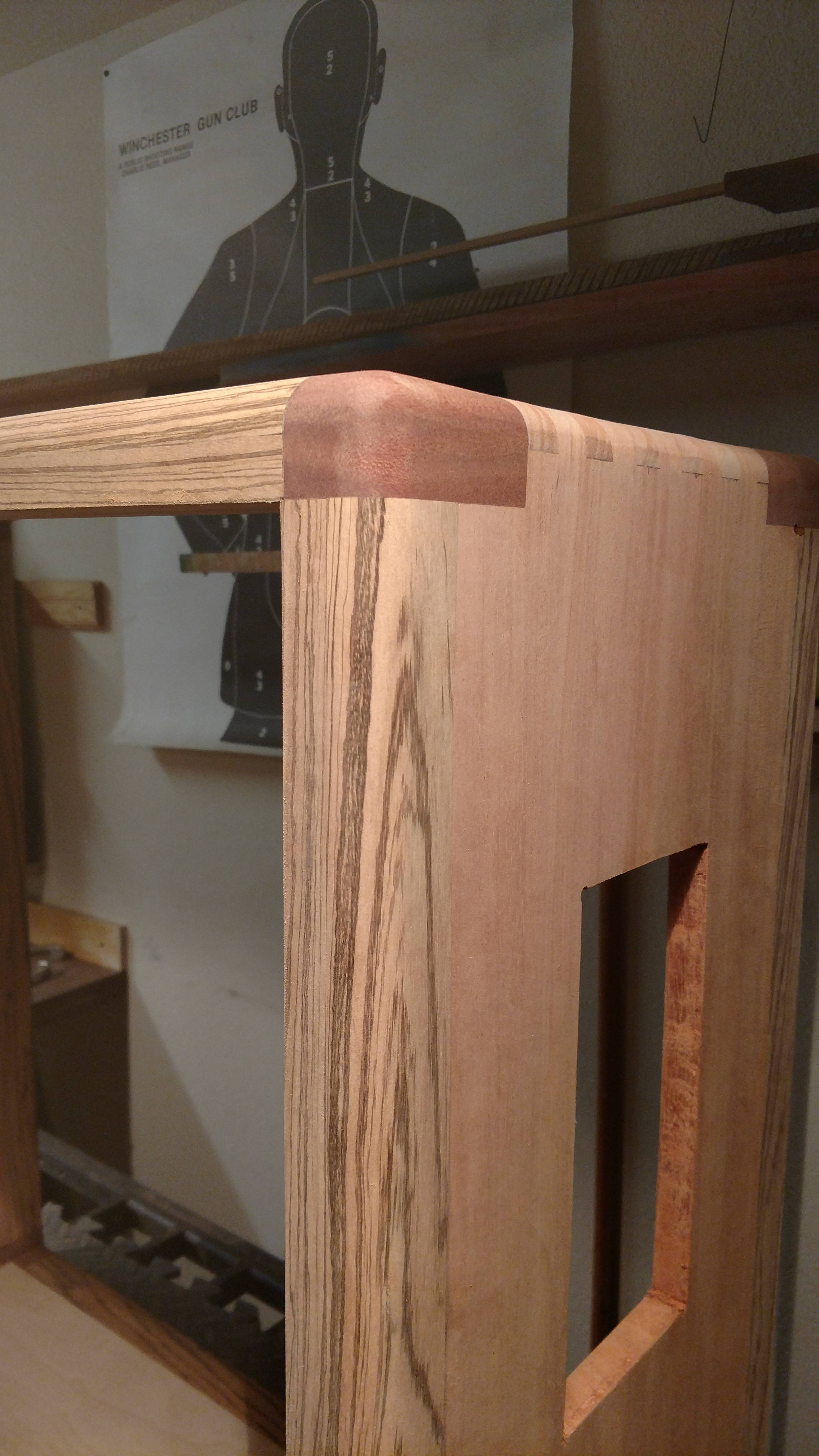

First major screw up - forgot about the ZW trim wood and foolishly [yet beautifully - gotta take solace where ever you can find it] notched the main carcass. Now a wider piece is used for the corner block.

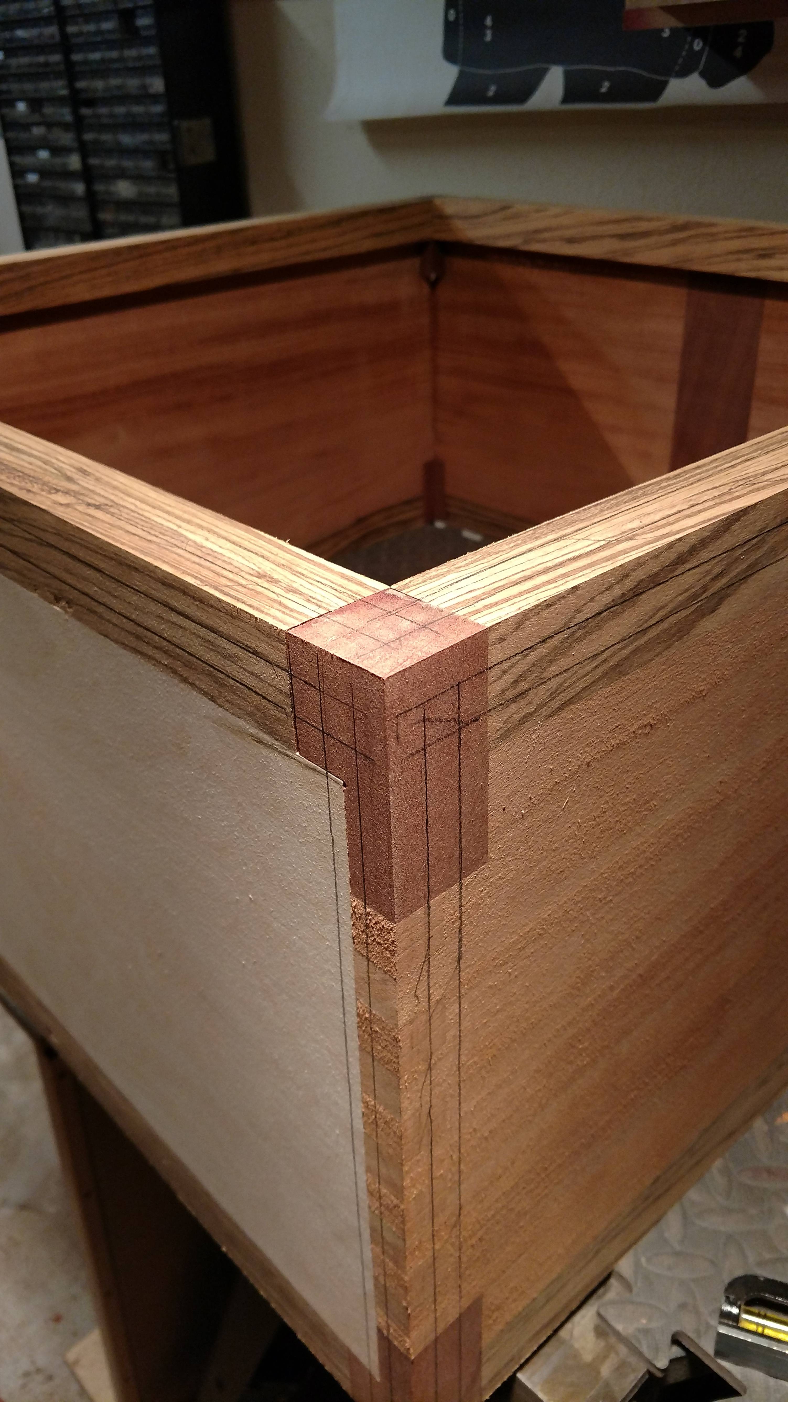

Corner block in place.

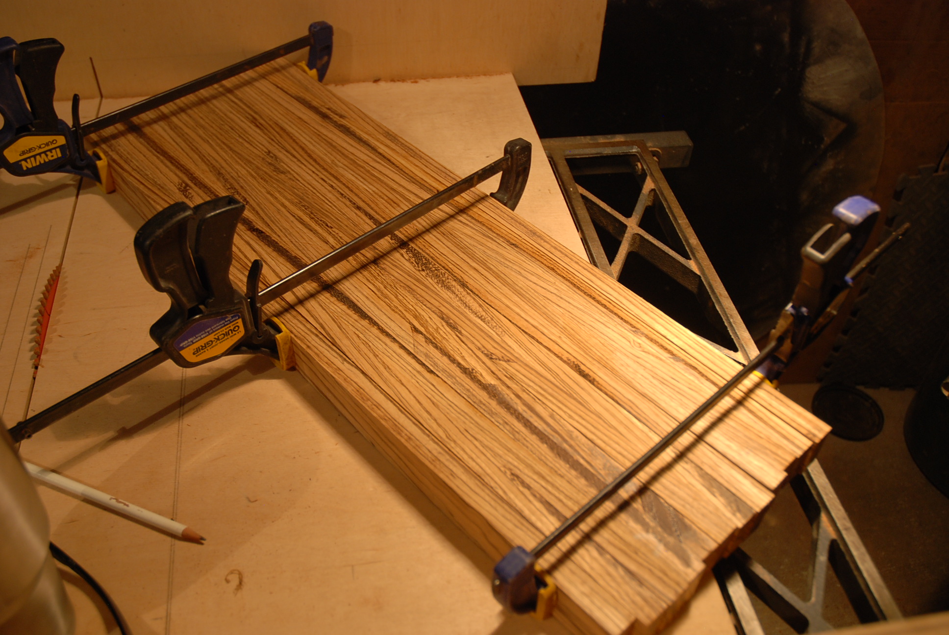

failed attempt to keep 'squirmy' wood straight. Zebra wood is not a happy wood - it loves to warp and cup after cutting.

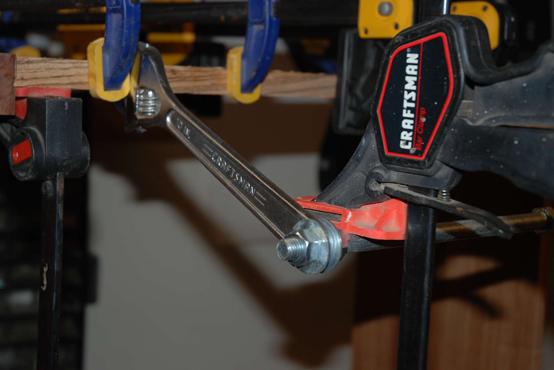

Needed to pull the front edge down and not move the back edge. Naturally this issue was determined AFTER the glue had been applied. Nothing like extra clamps and a crescent wrench to make wood behave.

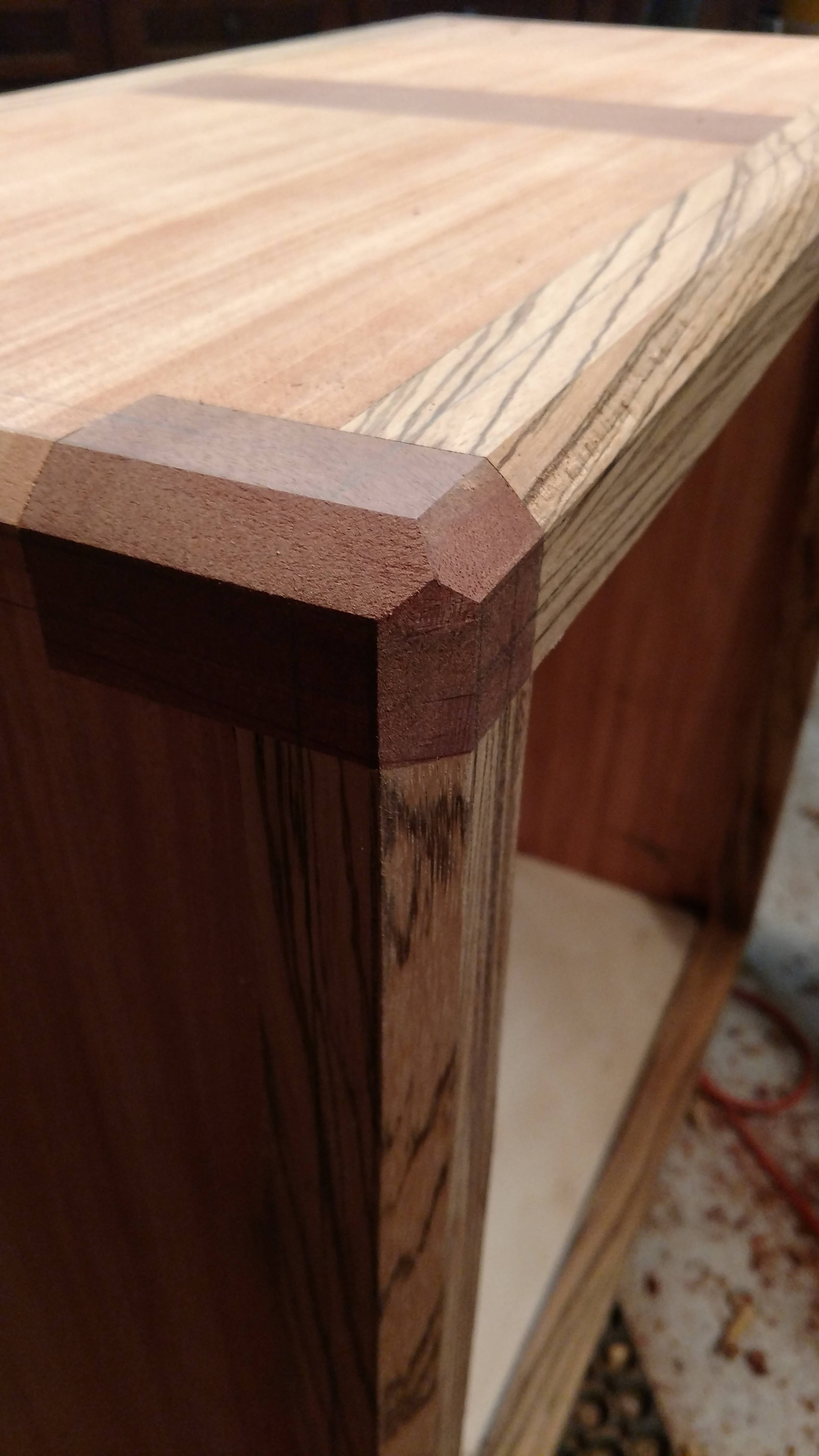

All trim and corner blocks glued. This one shows some of the bottom where I generally use plywood. No sense in wasting beauty. Witness lines drawn to begin the 1" round over with an orbital sander. I start with 40 grit then 60/80/150/220 for the whole case. All joint parts are cut .020" 'proud' then sanded flat.
Initial 1/2" 45° bevel sanded. This stick of zebra was challenging - even with the sanded round over I had tear out. A router would have been a cluster.
Then progressively angled toward the flat side. Then the round over is sanded in.
A view of the top.

I have a question about this picture, with the caption:
I'm not understanding the joint. Did you simply cut the block so it's proud of the two pieces being connected, or is there something fancier than a little glue and clamps? I've got a few shorts I'd like to do something with. Given my lack of experience, I hadn't considered that a reliable joint can be made so simply.
HI Phil,
Sorry for the delayed response. I cut / milled the block and then evenly shimmed the two sides up about a 1/16" so the block would be proud on all four sides. Then ran it through a drum sander to get it close and finished with an orbital. I edge glue all sorts of cabs and haven't had any issues even with handles and heavy trannies or speakers.
My wood building buddy told me that with modern glues - Titebond II & III - the joint is stronger than the wood surrounding it. I thought bullcrap until I glued in pine bracing to support a cherry slant cab baffle. The next day I noticed [insert naughty words] the bracing was at the wrong angle. I thought 'No big, I'll just bash them out.' Hah. 2lb hammer, blocks with an inspired and vigorous bit of bashing later [more naughty words] those damn braces just laughed at me. Thank god for a shoulder plane to correct the angle.
I used dado joints, biscuit joints and they don't do anything more than the edge glue. If you threw them off a building maybe but I'm not in that habit.

Phil_S wrote: Sat Aug 12, 2017 5:01 pm I have a question about this picture, with the caption:
HI Phil,
Hey Russ! I was in no hurry and I appreciate the reply. I hadn't considered it could be done so simply. As you know you can't do much with 12" so I got to overthinking how to join them and gave up on the idea until I saw you do this. It's a bit of good inspiration.
