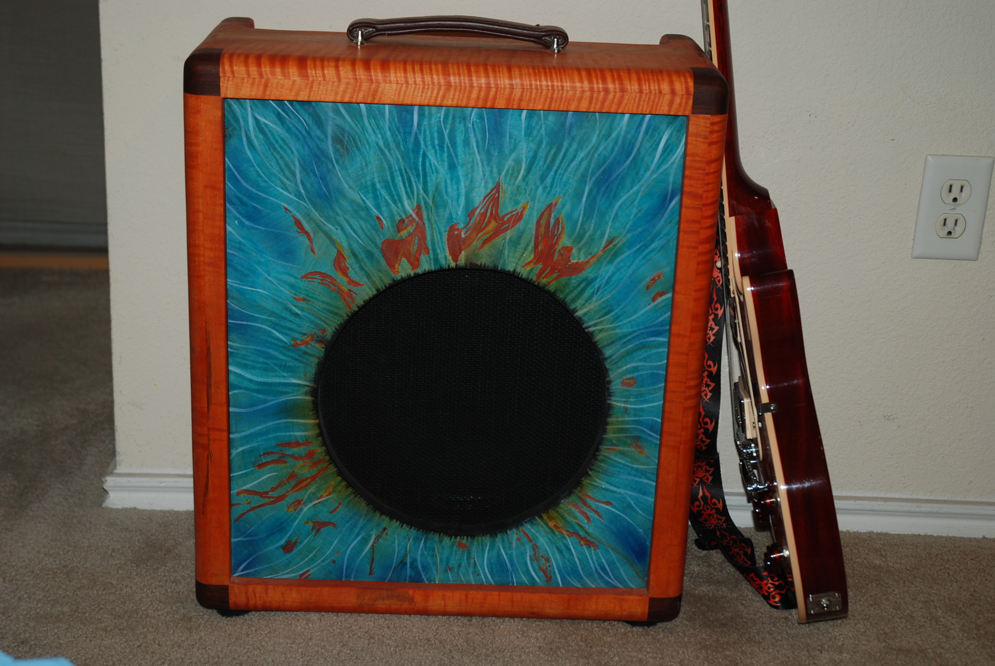

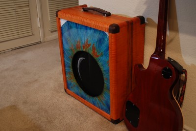

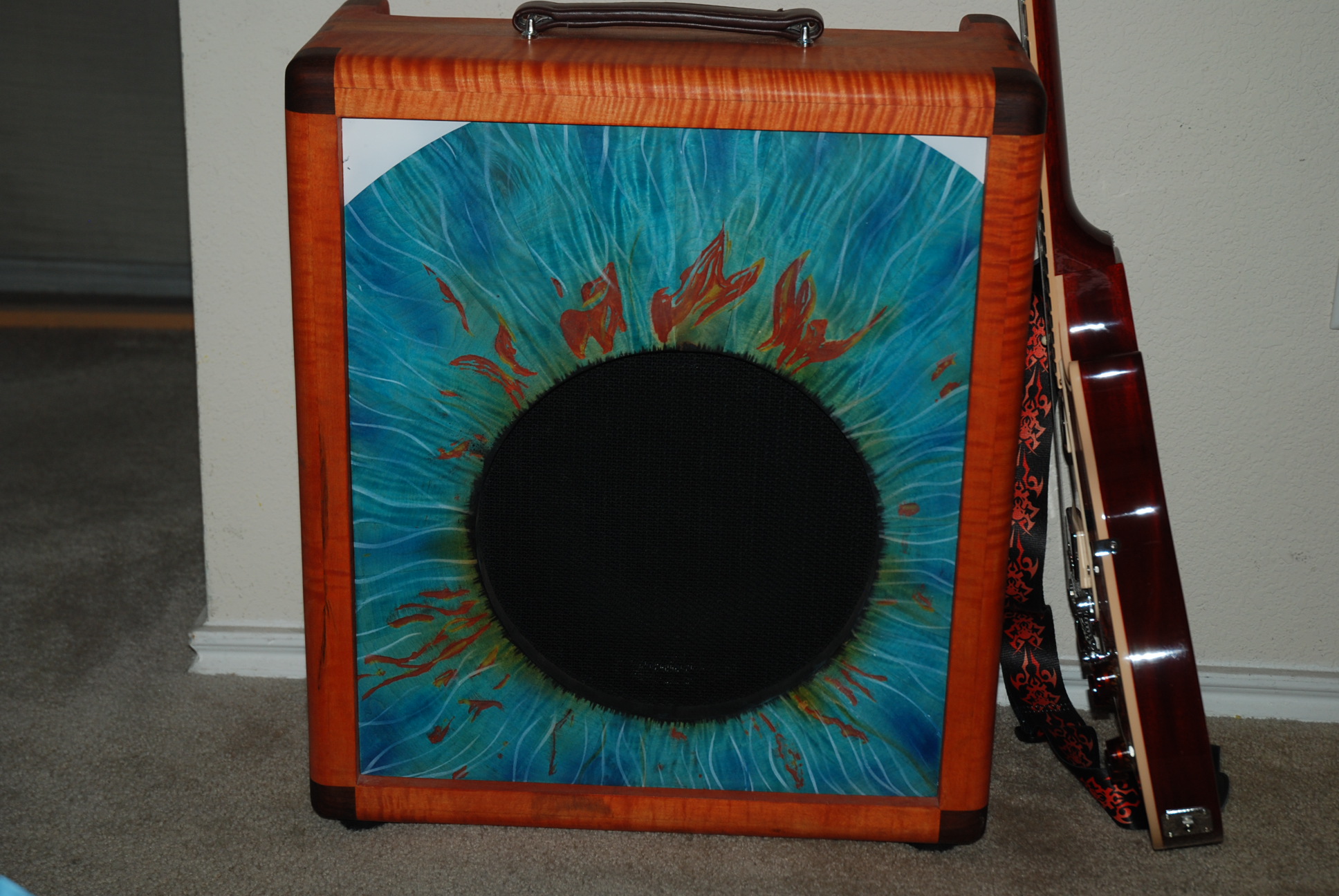

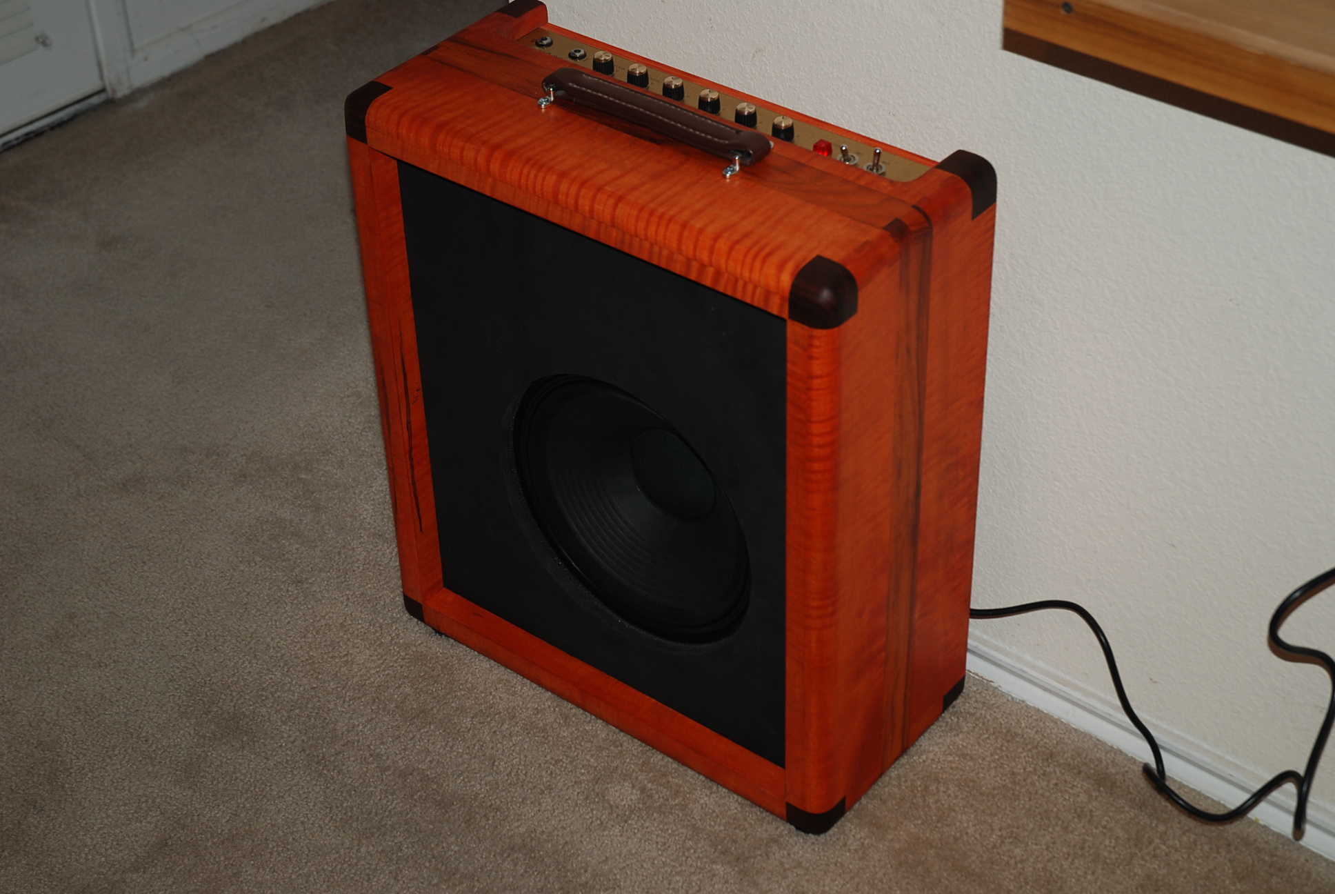

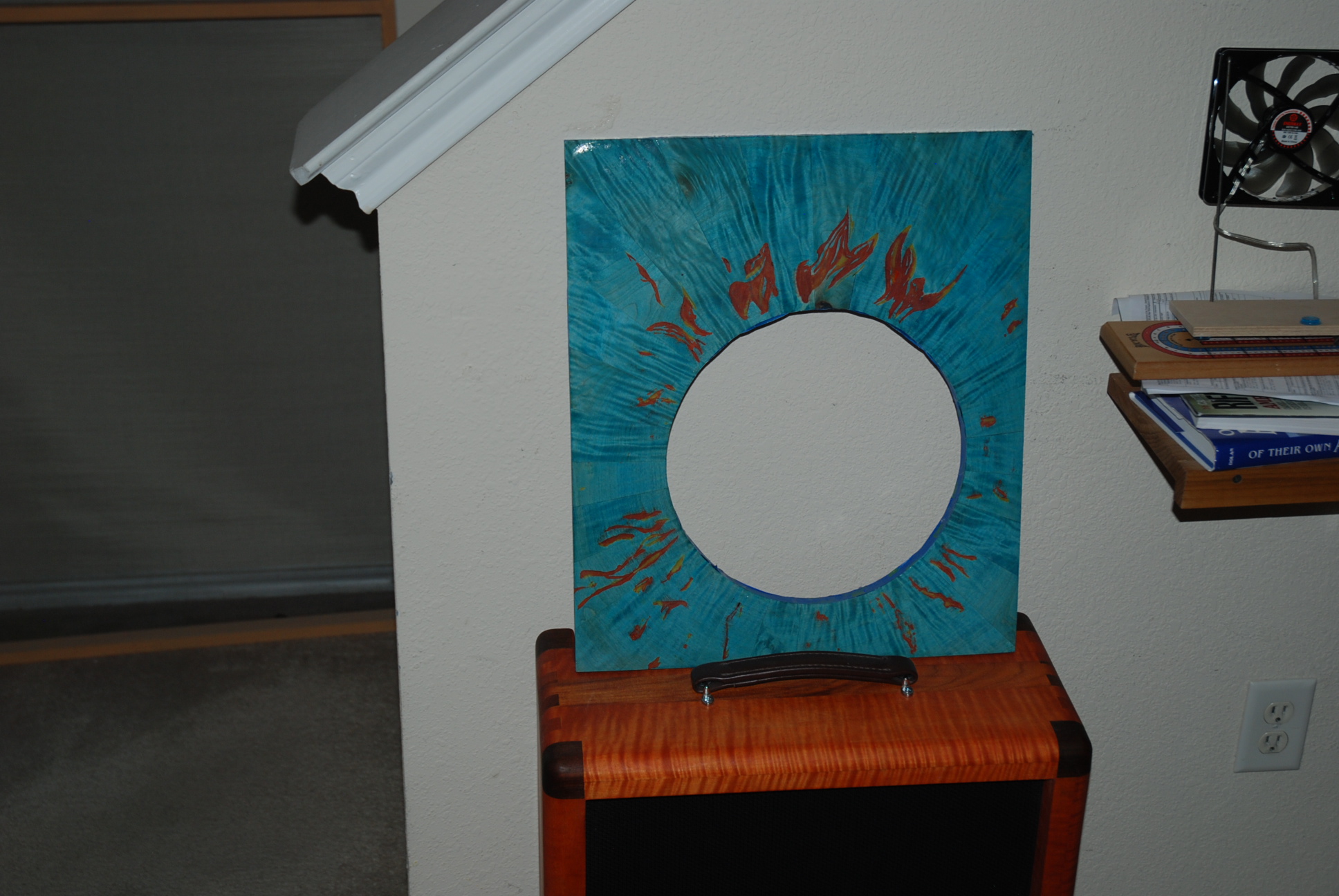

So I built this for the 2017 Dallas Guitar show as a booth amp 5/5-7/17. 1987 in a curly maple, canary and walnut finished with an orange water based stain and linseed oil / mineral spirits.
I plan to build a curly maple iris similar to the pic below. Surprising how much orange the blue human iris has.

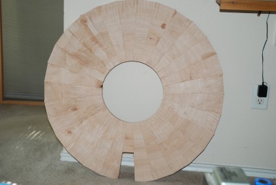

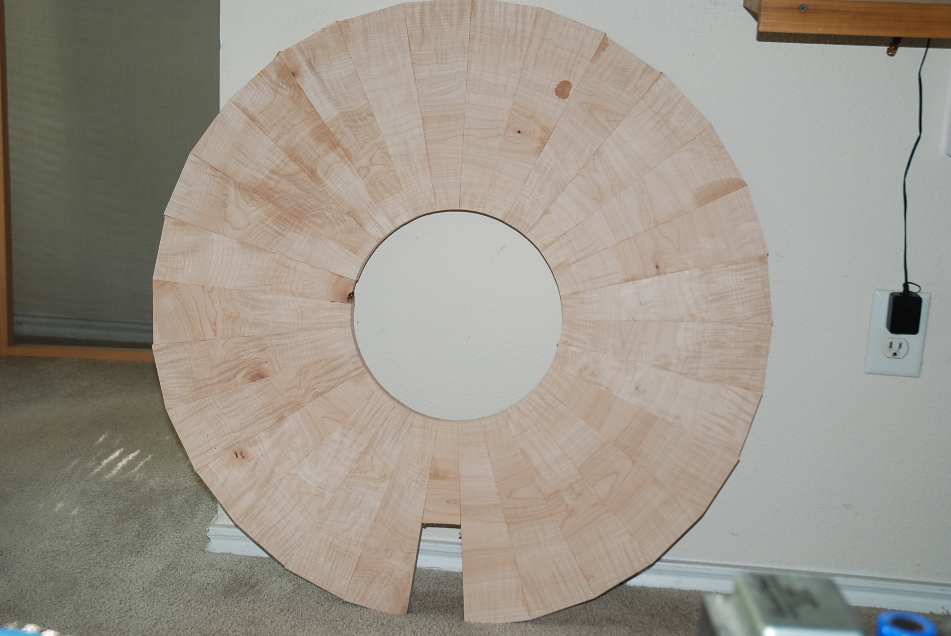

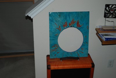

Found some curly maple with good figure that was wide enough to form the iris to fill the combo cab baffle.

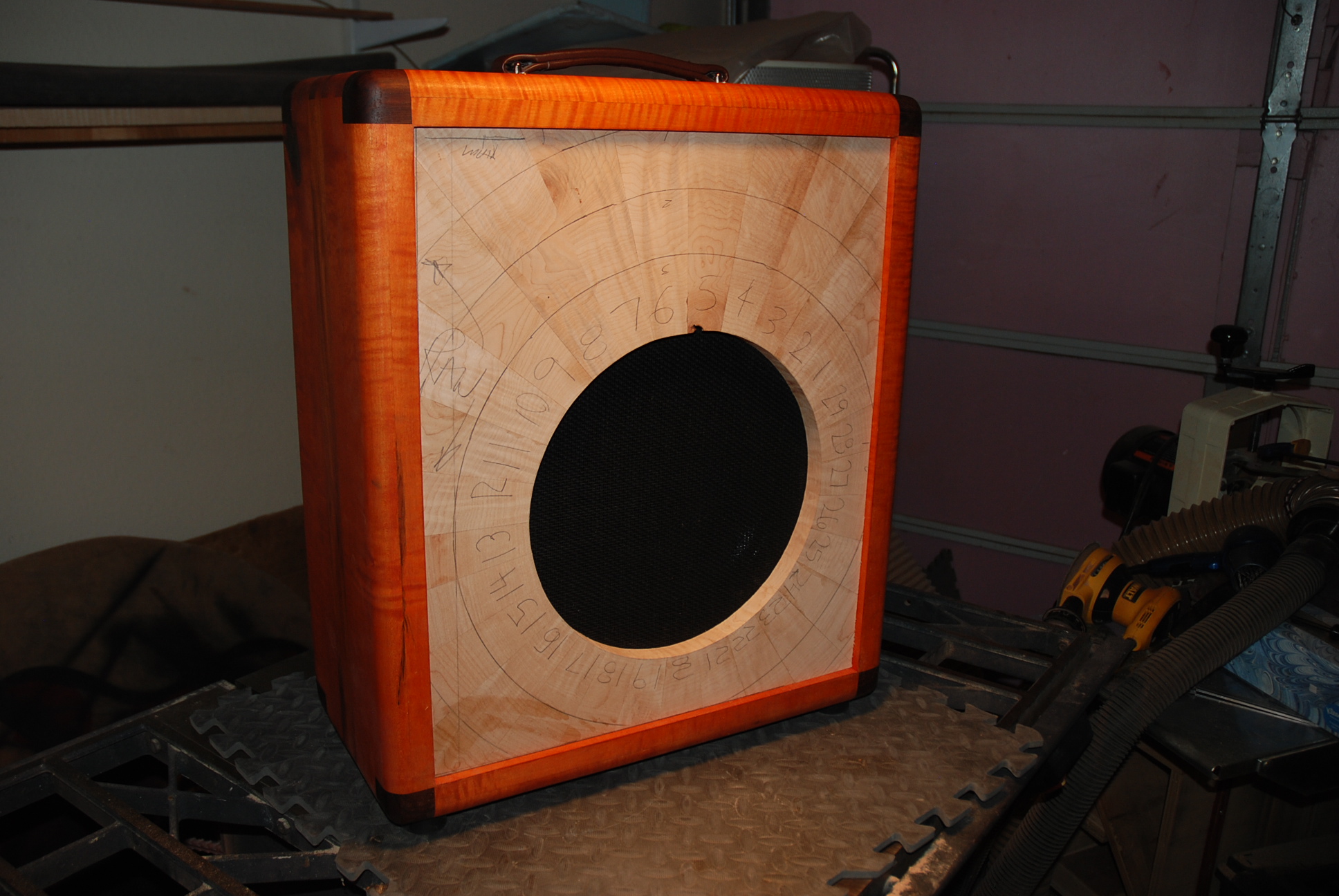

Then cut most of it away to fit. Always a nervous moment as I tend to be a 'Ready, Fire, Aim' guy.

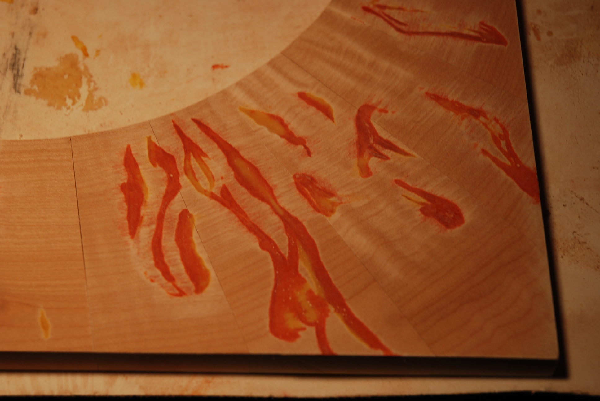

To put the orange in I carved the 'figure' in with a dremel then bleached the wood with a two part solution. Stained the wood with yellow and orange then filled it with epoxy. Sand flat.
Bleached again then rubbed in blue fabric dye, to be shown in the next post.

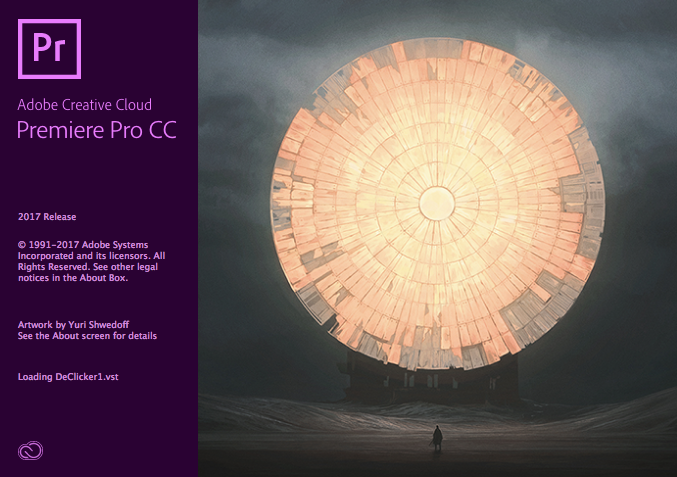

Whoa...Adobe is reading your mind...
pompeiisneaks
Site Admin
Posts: 4244
Re: Iris combo cab
Post by pompeiisneaks »
xtian wrote: Thu Apr 20, 2017 6:03 pm Whoa...Adobe is reading your mind...
LOL :D
I see that one a lot, I use adobe products all the time
Edit: specifically Premiere Pro to edit my Youtube vids

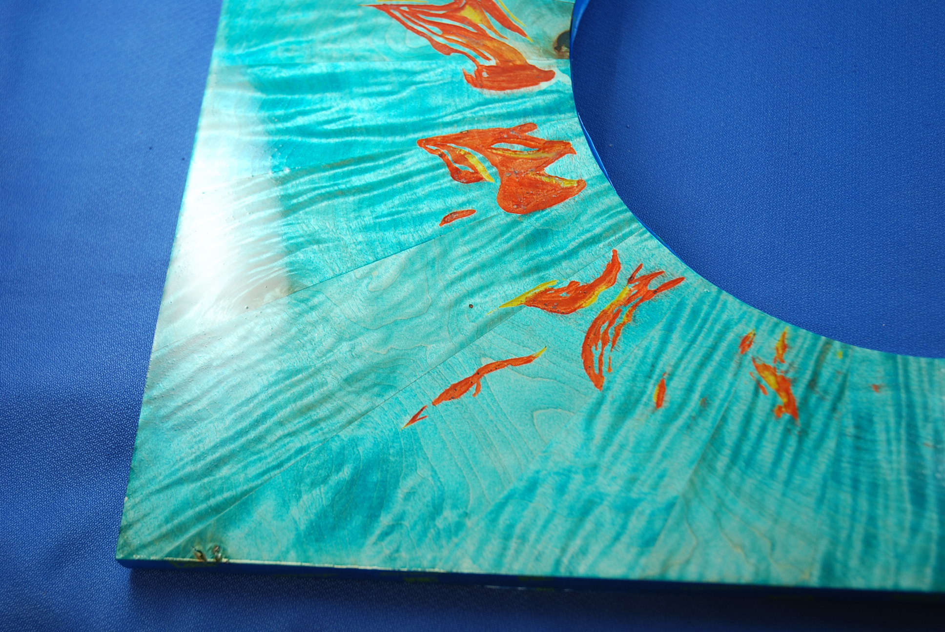

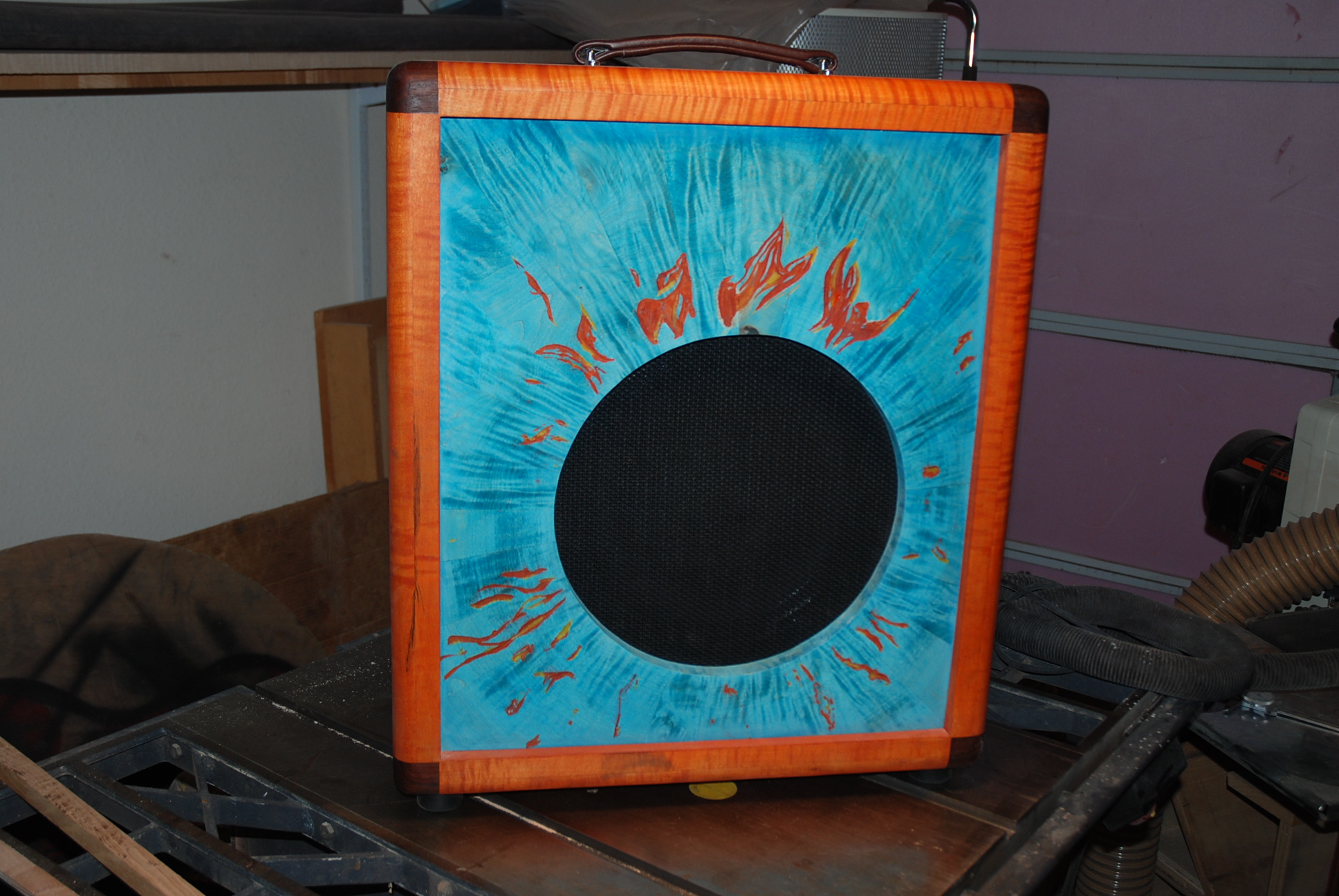

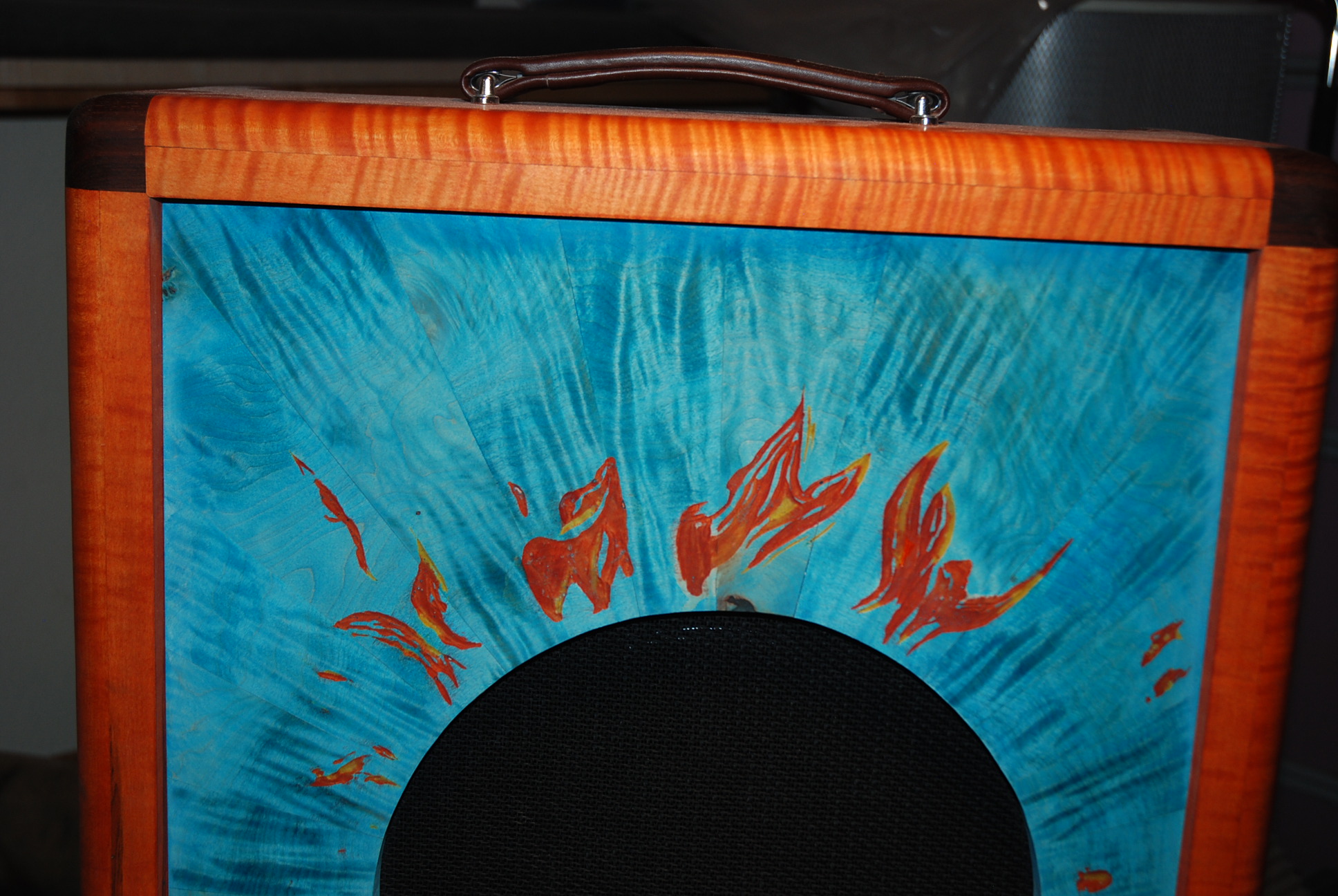

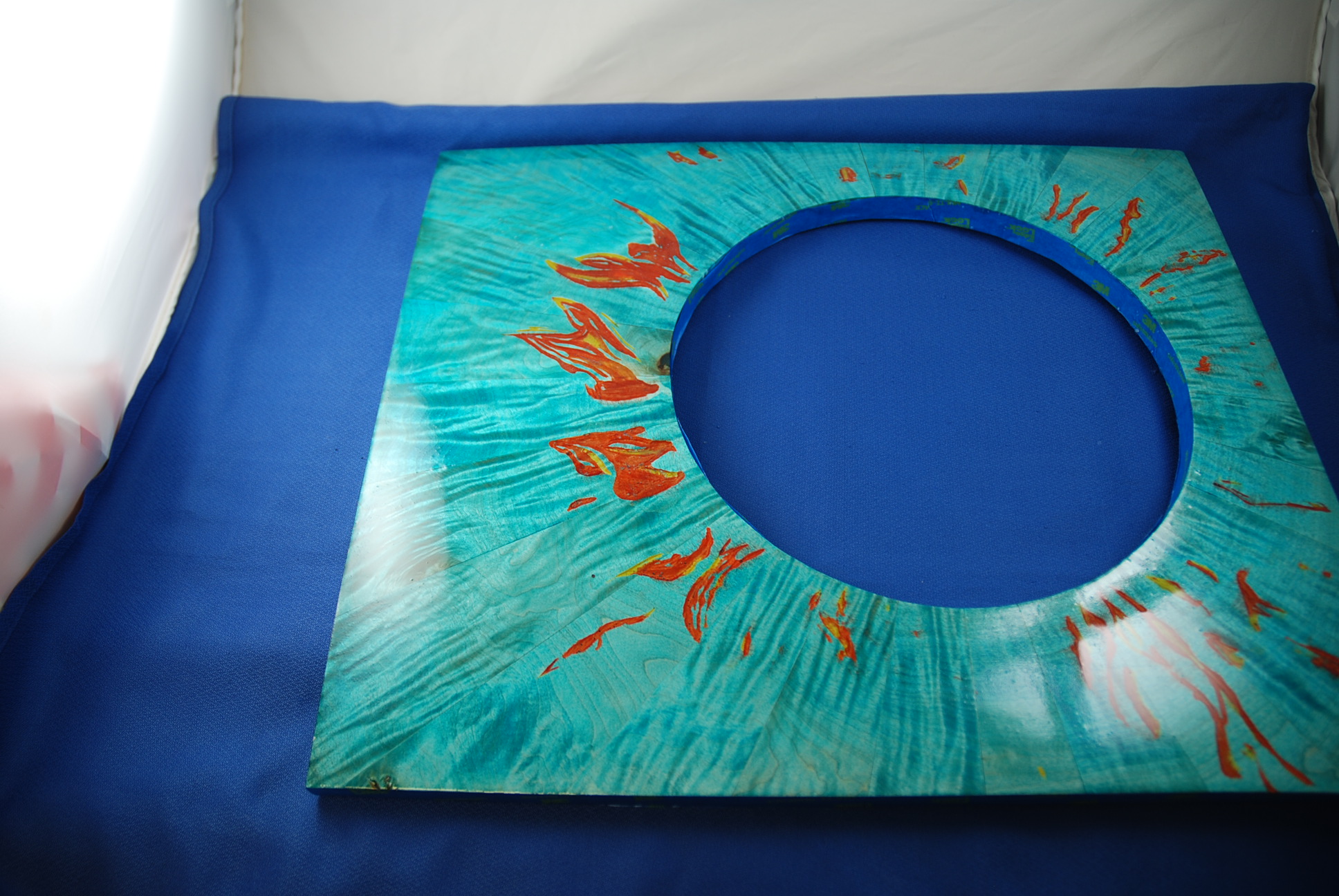

Here's the iris rebleached and the blue dye rubbed in. It's matte at this point
Now with 3+ coats of automotive clear brushed on
And wet sanded with 400 grit to level and give the paint a grip.
Now I gotta relearn how to use a two stage airbrush.

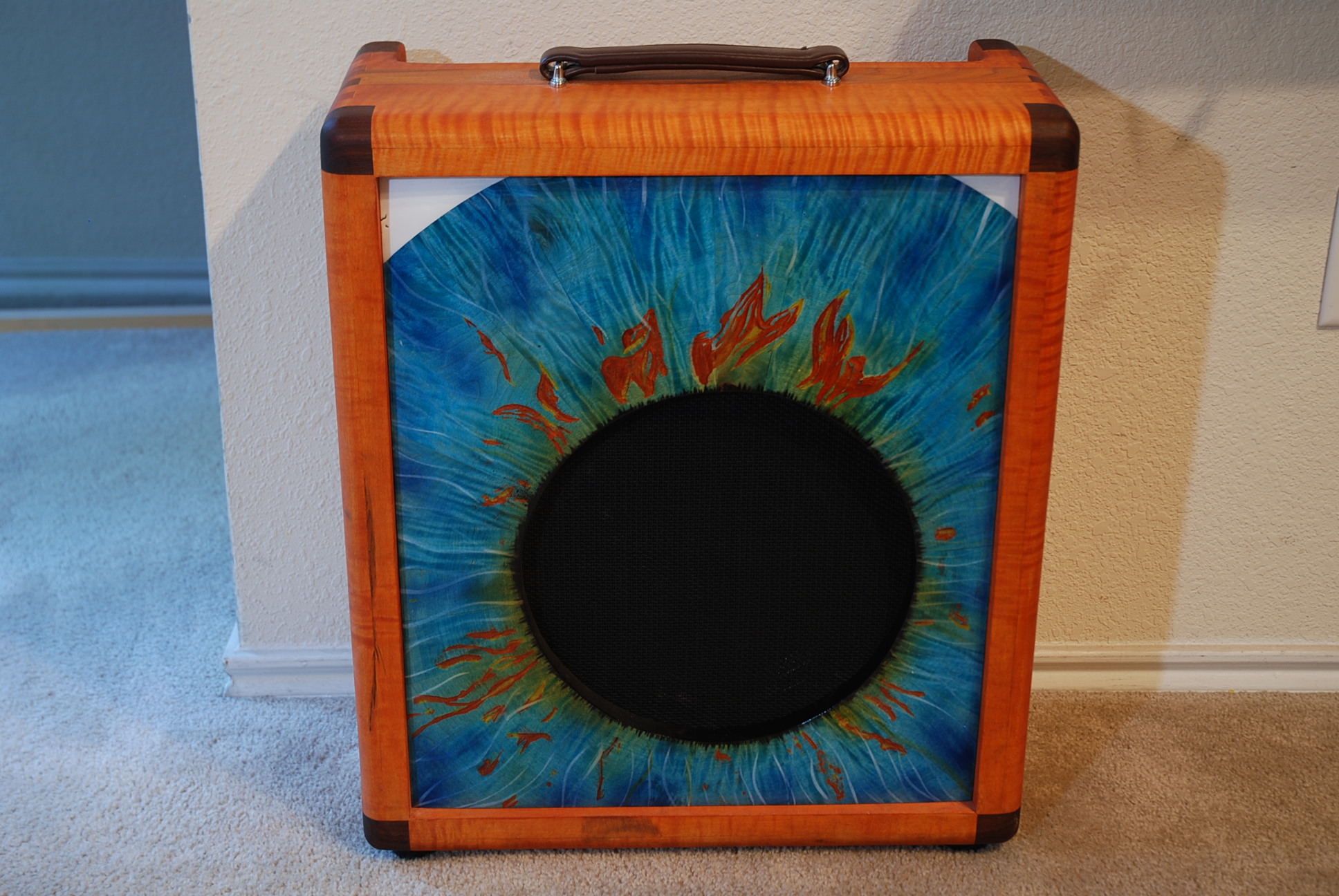

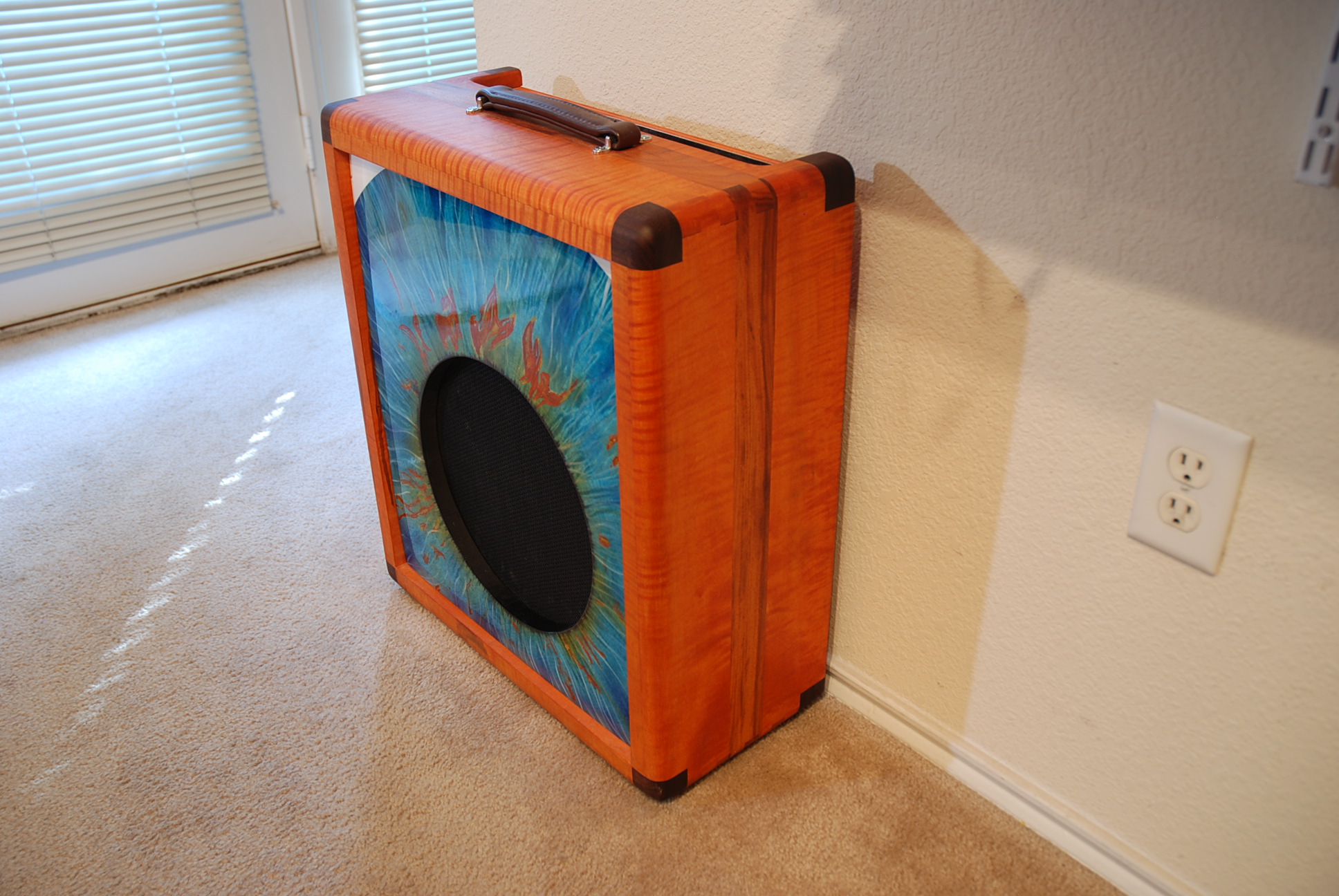

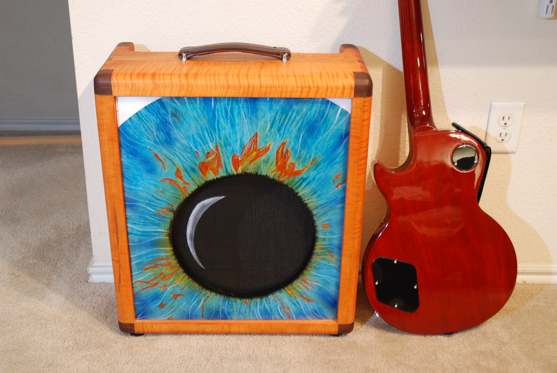

Getting closer to the finish line. I airbrushed in white highlights and some translucent orange on.
I liked the effects but I wasn't happy with the presentation - it didn't said EYE. More black hole on acid. After consulting with a artist friend I sprayed on some white accents.
AYE! - sorry couldn't resist. Three coats of automotive clear later...
I sprayed white on the pupil as a reflection but it was in the wrong place so I plan to redo it.

Re: Iris combo cab

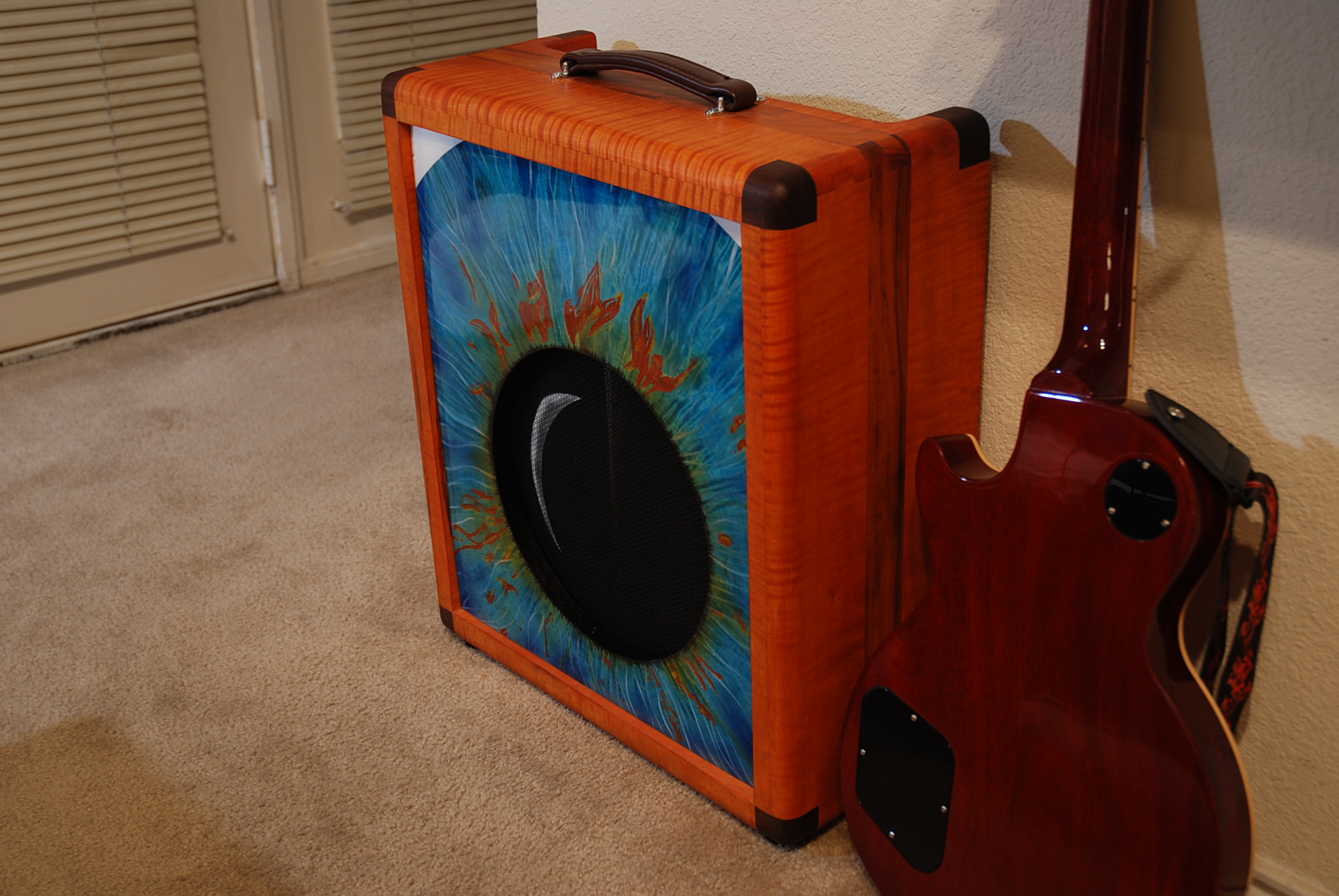

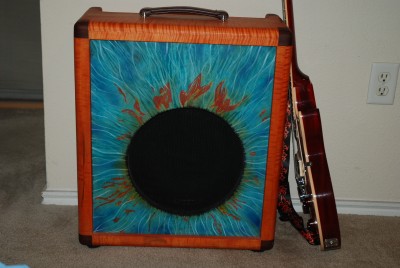

Fixed the FUBAR'd reflection on the pupil and sprayed a bit of lacquer to make it somewhat shiny.
Next will be to clean the disaster I call a shop and contemplate the next project as I don't do postpartum project depression well. Then I saw this and thought HOLY CRAP! A 2x12!
