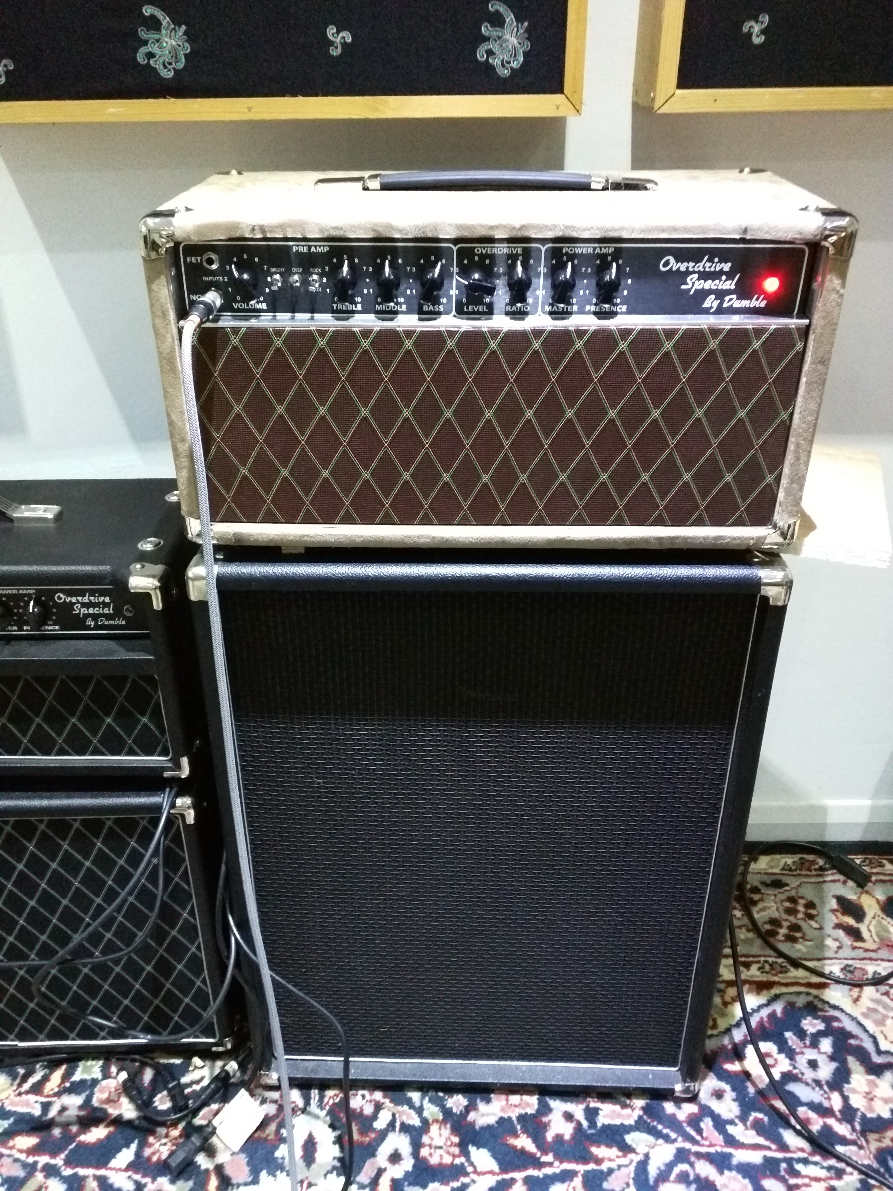

I'm about to do my first Dumble ODS cab and have some faux suede.
Do I cut the seam like using tolex so it's invisible (hopefully) or do you overlap like fender?

thanks, I have indeed finished it......and it was a nightmare.
Never use Faux suede fabric.....period.
It has zero give so wont stretch at all( see front cut out splits) the glue shows through if you use slightly too much and it frays terribly when cut making seams impossible.
I'm ordering real suede from now on.

Yes I'm sure at some point I'll re cover it.
From a distance it actually looks fine so the urge to redo it isn't as strong as if it were a complete dogs dinner :D
