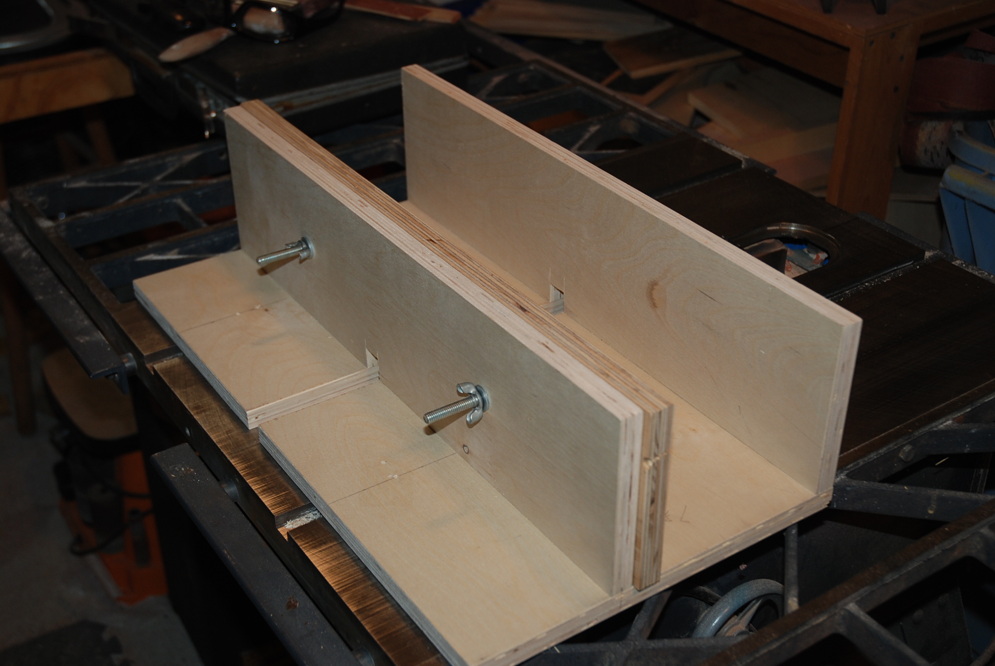

You can do a router table jointer. https://youtu.be/9lheWuf1Bzk
Pipe clamps are the way to go .
You can find old craftsman jointers for cheap. New knives and bearings should be under 50 bucks
Re: Joining boards
Cbass, Nice trick with the router. I like it! Thanks. I'll have to build that router table I've been blowing off.

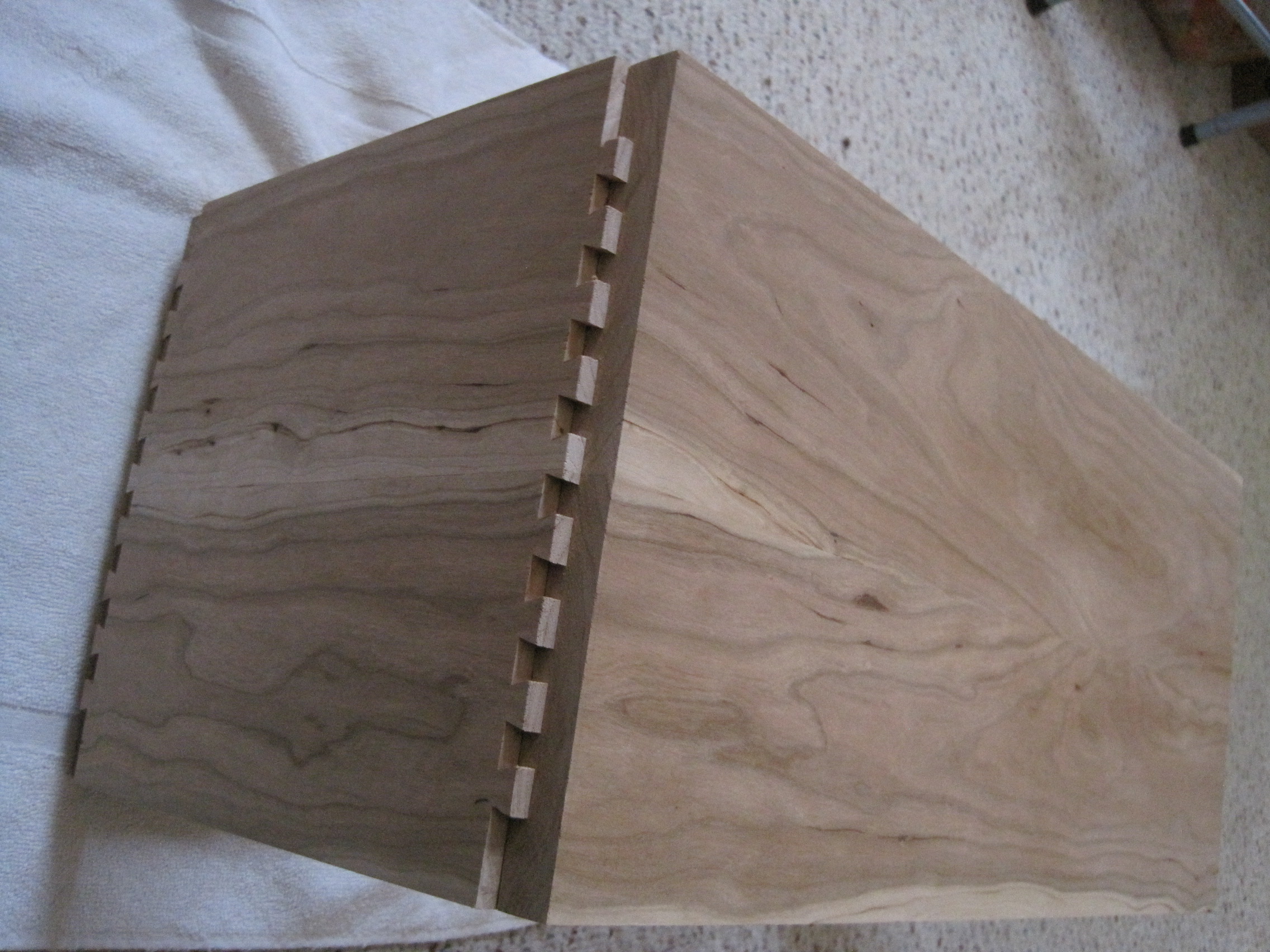

It's good to have confirmation on the wedges. I've got a brand new Freud LU series blade in the saw, so I should be good to go!
BTW, weirdness on the eBait auction for the walnut. The zero FB numbnuts who outbid me retracted his bid after goading me to increase my maximum by $1
so once again I am high bidder. Eight hours to go. Maybe I'll get the walnut, too. We'll see.
I'll rant about eBait now. After being outbid, I left that auction behind and bought something else, as a direct result of being outbid. They shouldn't be allowed to once again make me high bidder without my consent. I think the seller should be required to either get consent from the next highest bidder or cancel the auction if he can't get any lower bidder to consent. Just my 2¢ and thanks for listening.
Edit: Well, someone did me a favor and bit on the walnut. The cherry has been shipped!

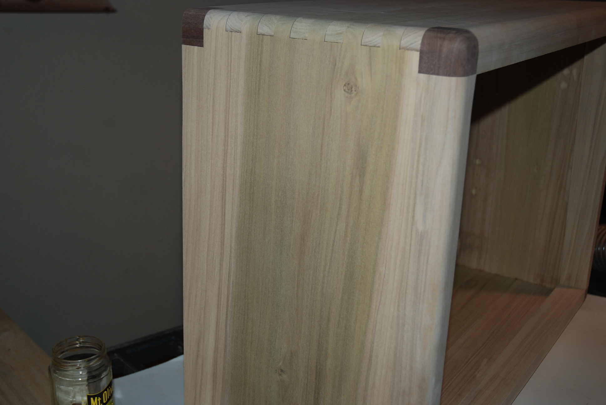

Hi Phil,
Welcome to the wild and wooly world of figured wood - you are doomed my friend!

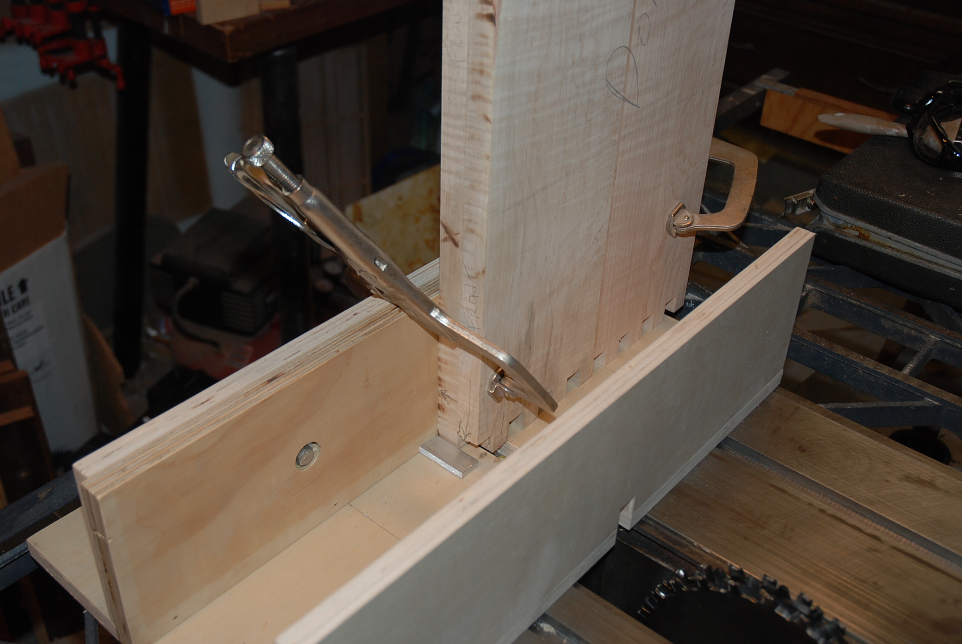

I have had lots of success by trimming to usable length [plus an inch] running the 7/8" thick planks through a table saw with carbide blade and multiple feather boards to control the sideways drift. Glue up on a flat surface and lots of clamps and rig up bow clamps to force the center down and / or LOTS of weight. I run the joined planks through a drum sander to level / smooth them and then off to the building I go.
It really works well when joining contrasting woods as any slight voids I fill with devcon clear epoxy and they go away from sight. I've dadoed 'em and biscuited 'em and being the opportunistic cockroach [some deem it lazy] I ain't gonna do that no more. I've not had issues on numerous 1936 2x12's with the carry handle on top using Titebond II & III.

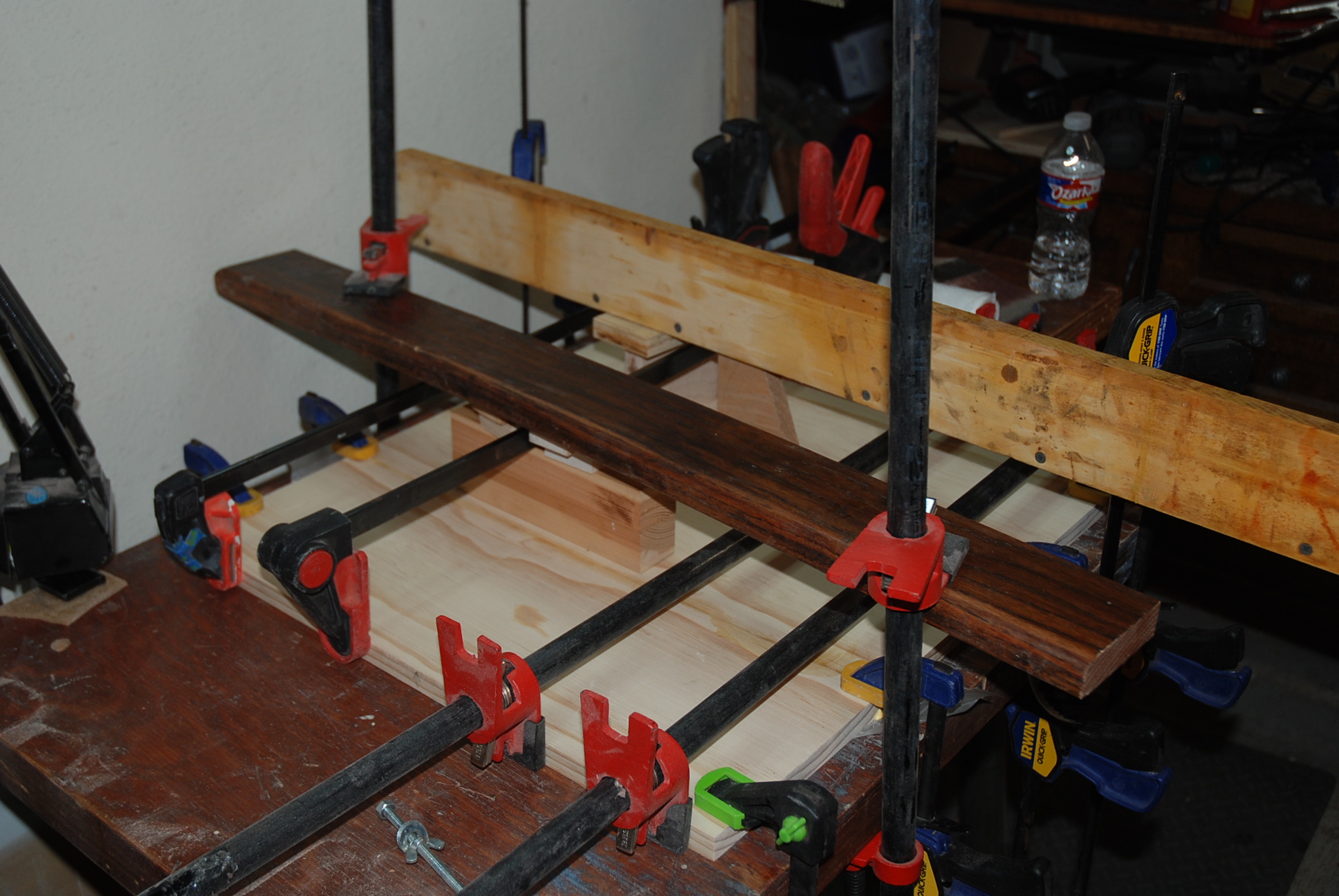

Re: Joining boards
Or what I call bow clamps. A stiff cross piece supported by 'feet' on the glued up planks pulled into a bow shape by clamps on the ends of the cross piece.

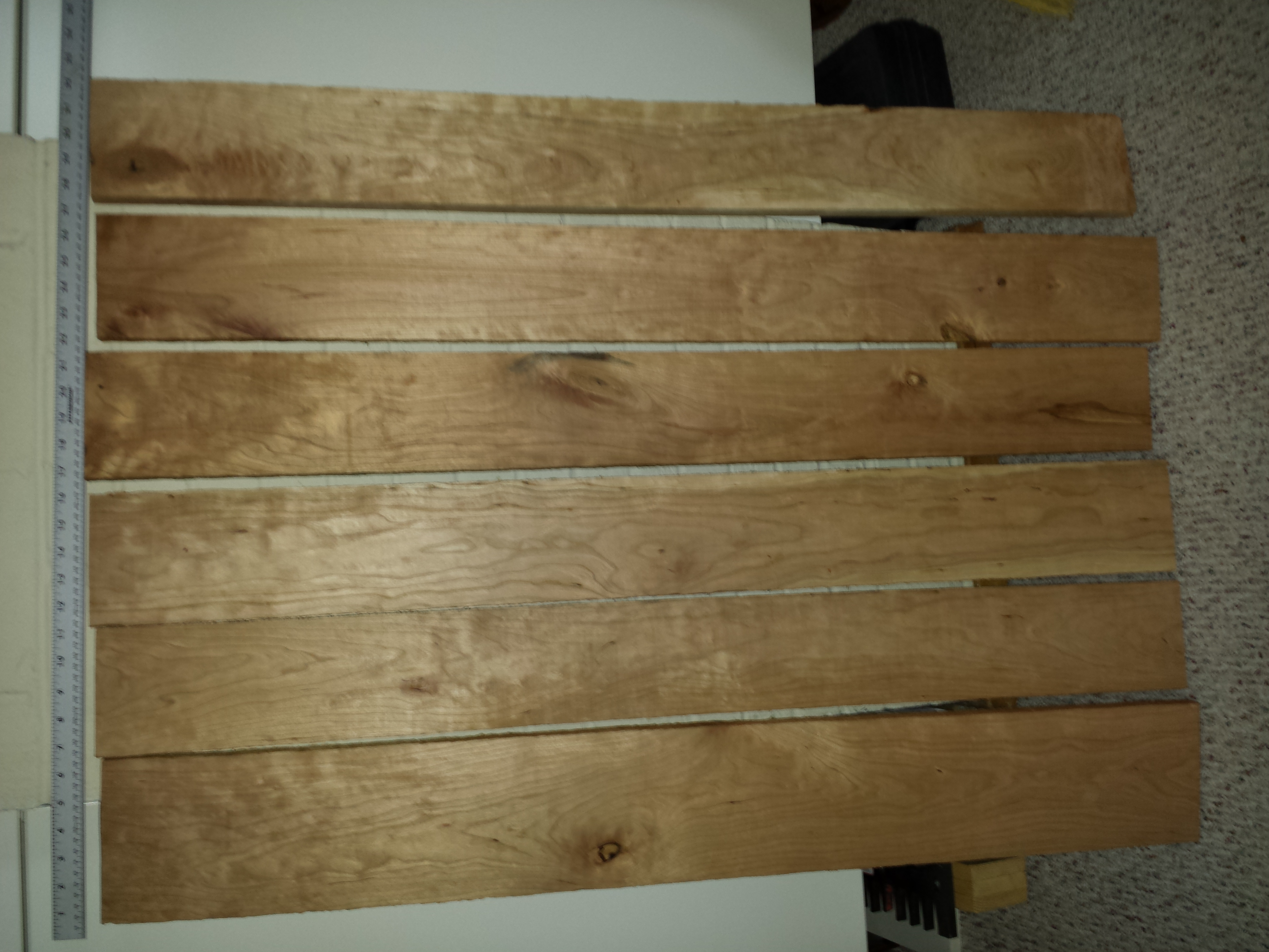

The wood arrived today, 2 days earlier than expected, thank you UPS. Most of it is nearly 1" thick, and all are over 7/8". One is clearly bowed, most of the others exhibit some bow from end to end. They seem to be fairly straight, but not perfect. They been put through a planer and show a little bit of snipe, but the good news is they are mostly flat. Edges area all rough cut, IMO that's better than finish cut that isn't good enough. All boards are the same length, just shy of 45".
I"ll be needing to join them to make two 9.5" x 20" and two 9.5" x 10". I have questions about how to approach this. Let's assume for now that I can make a competent joint seam that is hard to see.
I'll be planing them by hand (mostly) to remove the cupping. I might rig up the router sled, but the cupping (except one board) doesn't look like i should do that.
Should I cut to rough length, then join, then plane? Or should I join the boards full length?

Having worked with raw [full] length and cut to size - definitely cut it before you join it. The wood will squirm and you have less to pay attention to. Then beat them [plane] into useable form.

Got it! I think this changes the layout plan somewhat. It will also reduce the amount of planing. Cutting the bow in half should flatten it somewhat. Time to build the crosscut sled. Really, I just got the saw. Thanks for the help!
