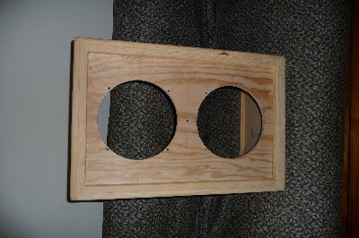

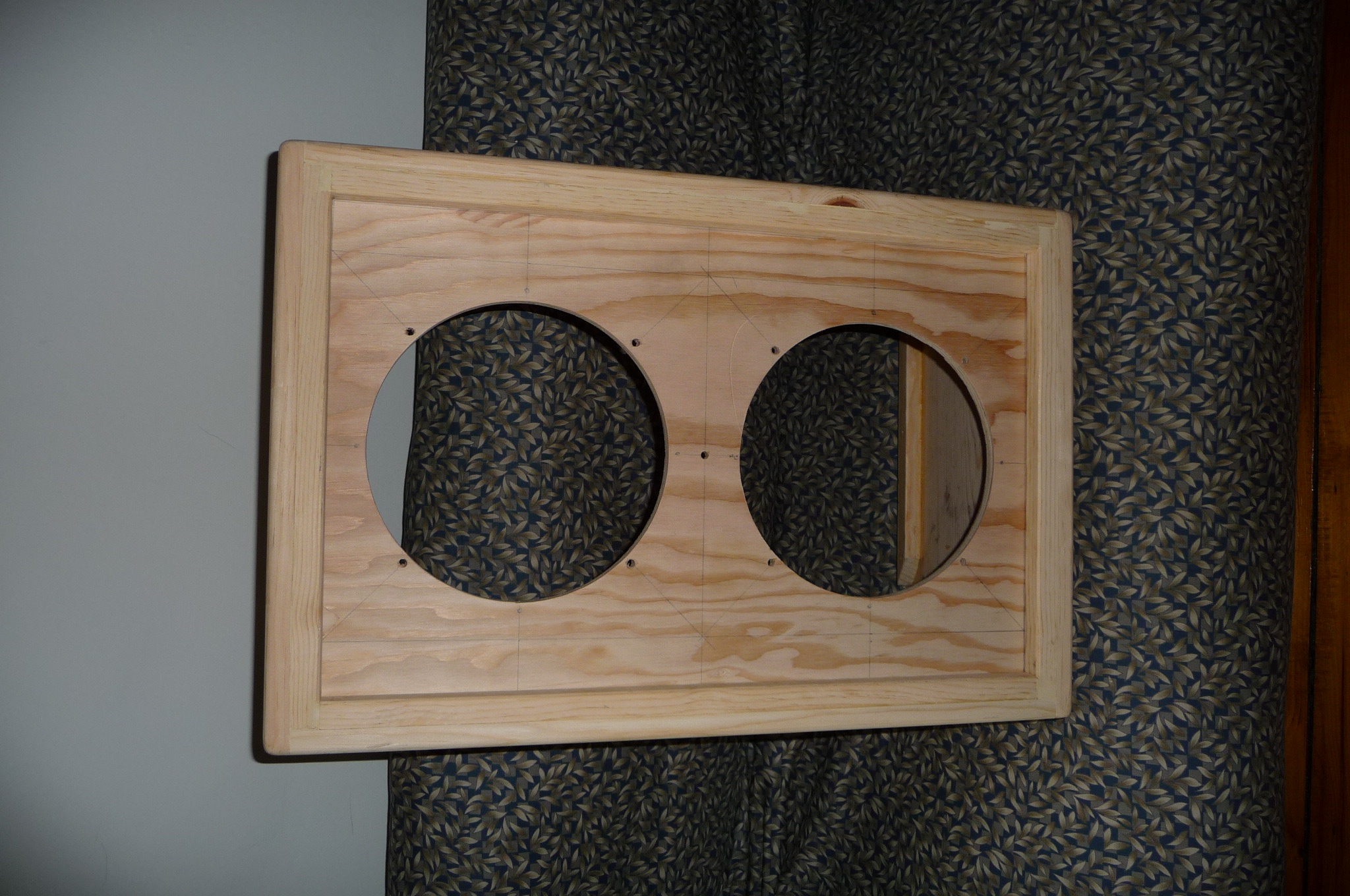

To do speaker cutouts you really need a router if you don’t want it to look like you used a rabid squirrel, here’s a pict of my NYC poor boy jig:
https://tubeamparchive.com/viewtopic.ph ... er&start=0
Worked amazingly great. Too bad I only do this every few years, by the time I finally get good I’ll be dead. Here’s how nice they came out with a junk store router and the scrap wood jig.
