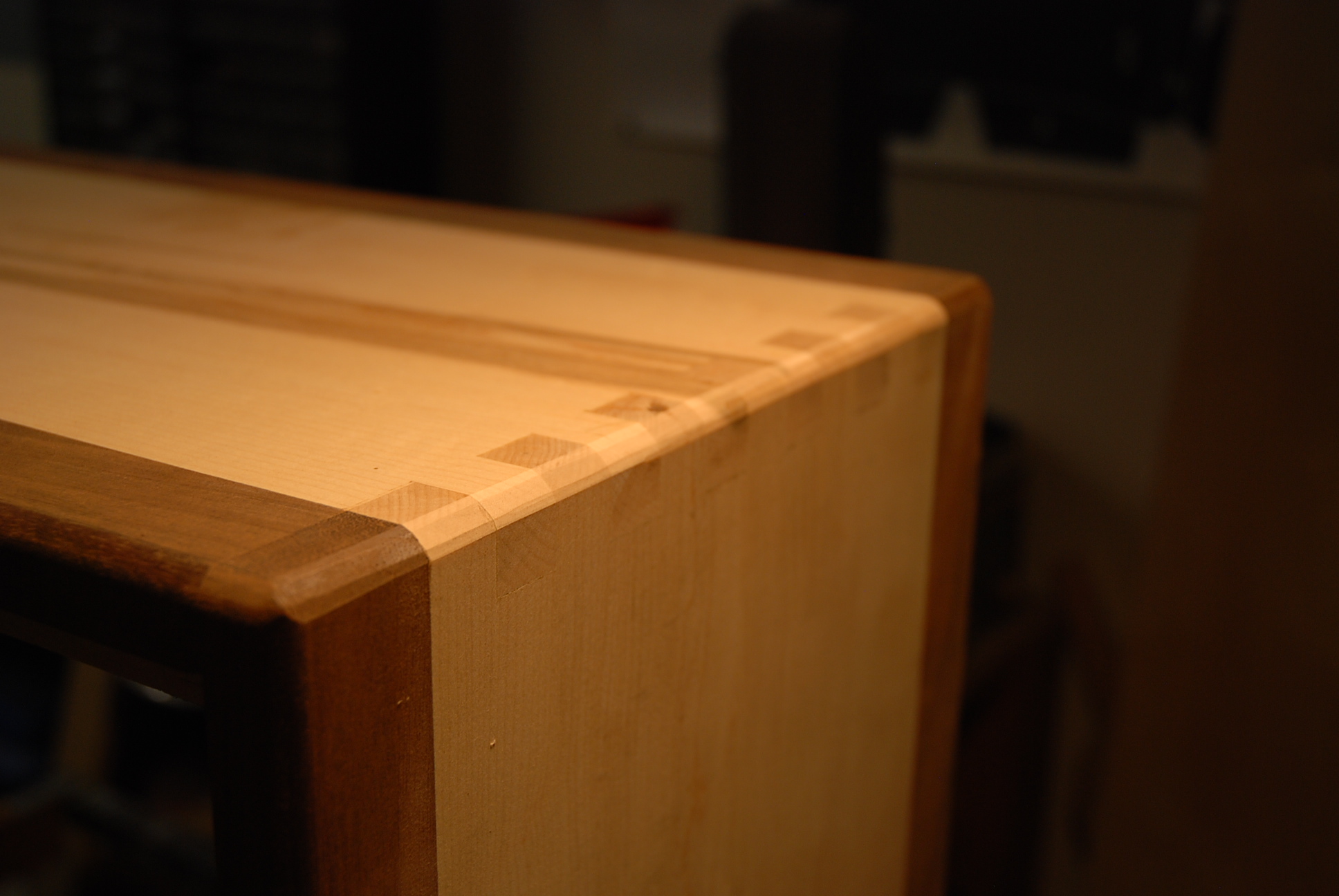

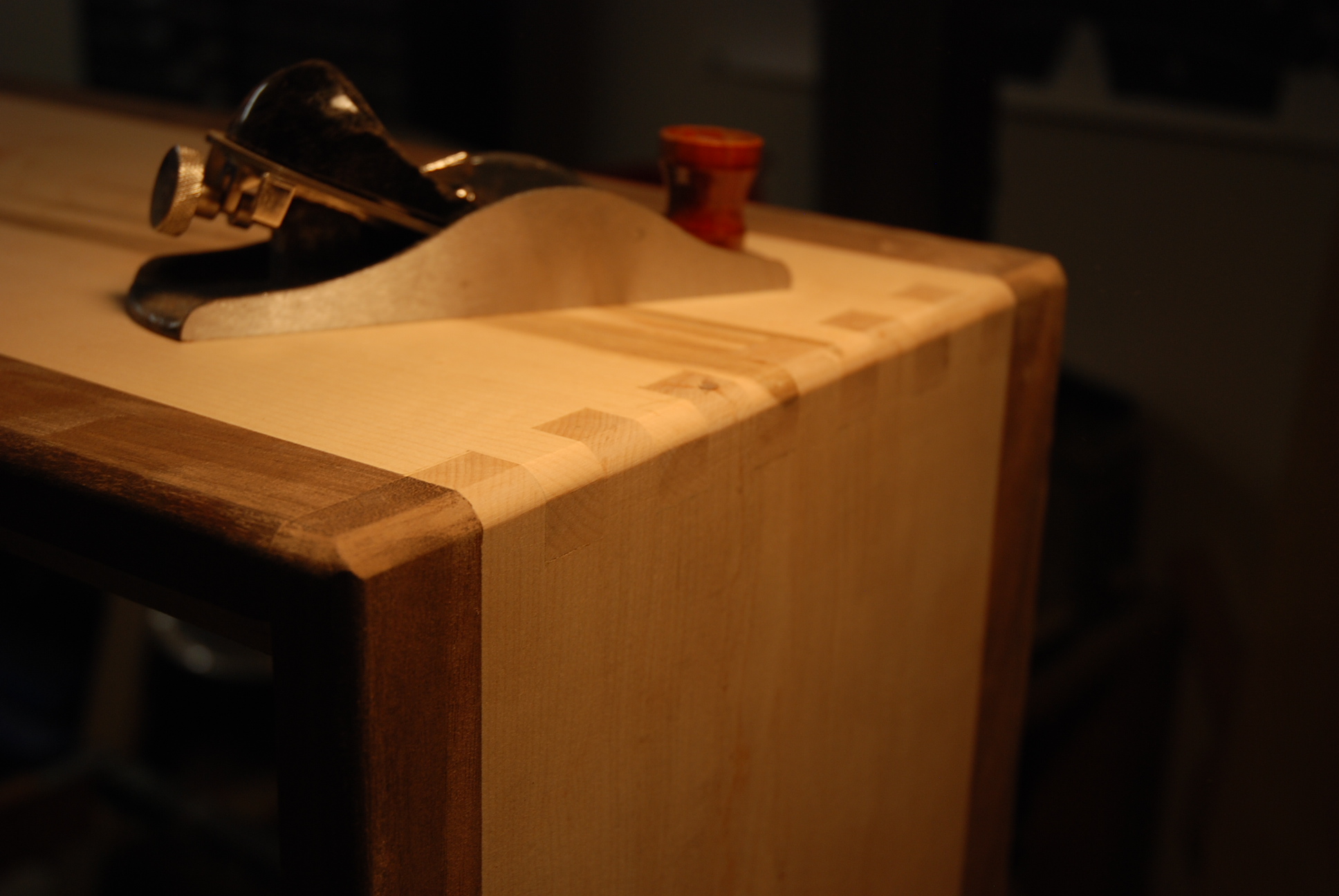

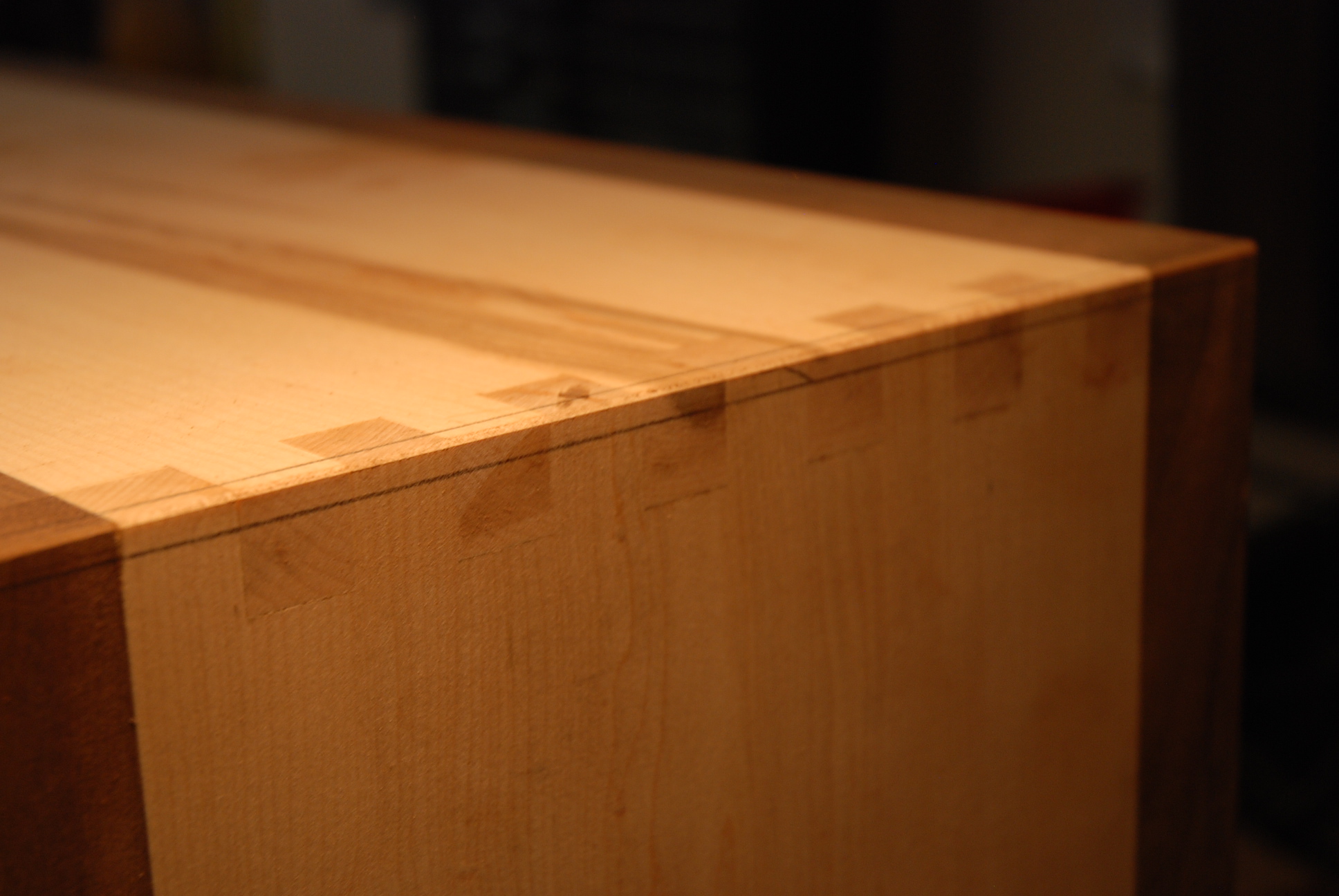

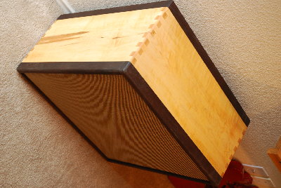

My new favorite wood working tool is the basic block plane. I bought a Sheffield brand [True Value had 'em cheap] 6" model. The biggest reason I bought it was to experiment with rounding corners on head shells and cabs. I used a router table for a number of cabs and found it to be an uneven experience. If you didn't tighten the collet just right [like just this side of smoking gorilla grip] the bit would dive into the wood creating a non fix able issue - wood putty is not a decorative feature. Even after I learned the gorilla trick the high anxiety of super vigilance for each pass was a royal pain. The other more annoying issue was tear out. A bit spinning 20K can rip out a crap load of wood. After spending hours on a project only to have hunks of beautiful wood ripped out of the trim - lest just say it is a expletive filled moment or two. The grain in highly figured wood is not all 'going the same way' - walnut in particular.
One of the tricks to hand planing is figuring out which way the grain 'flows'. One way tends to pull the wood off the other shaves it nicely. I have found [again mostly walnut] that I have to plane many pieces from two directions to keep the shave going well. Another tip is to sharpen the new blade - a better trick here [if you are like me and tend to ruin blades by 'sharpening'] is to locate a friendly soul who can actually sharpen the blade correctly. Another is to have just enough blade out to shave the wood - some experimentation is necessary.

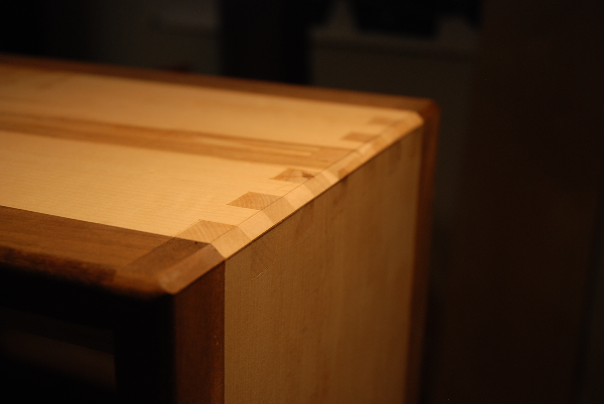

When I round the corners I mark to lines with a square 1/4" from the edge on both sides to keep my strokes honest. Never hurts to work a bit from both ends to avoid tear out on the ends. Once I get to the lines using a 45 degree stroke I then make a few passes at 22 degrees to break the edges. 100 grit paper folded over a few times blends all of the faces into a smooth curve. It takes about 5 minutes per edge to round each edge. Yes slow but I avoid any heart pounding !!#**#@! moments.
One other benefit which prompted me to write this - I've yet to make a perfectly square case. The requirement to take 1/64" off of one corner of the front and back baffles was always a royal pain filled with !!$&**! too much! The humble block pain shaves end grain wonderfully nibble by nibble until the baffle falls into place.
If you don't have one of these unspoken hero's you might want to bring one home.

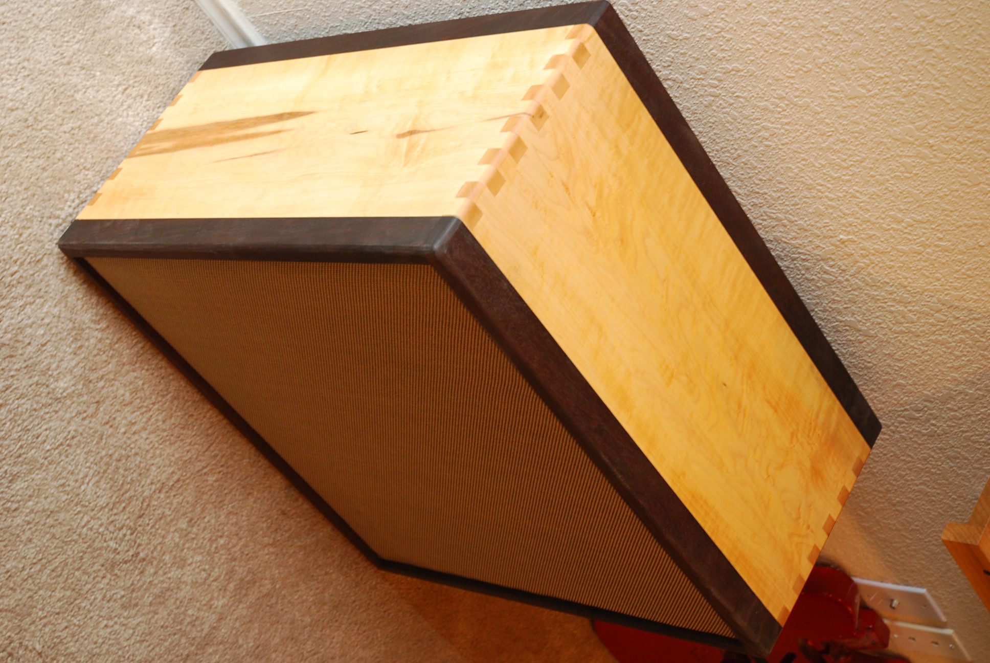

What you did to the corners is something different and something people might like. I think it looks good.

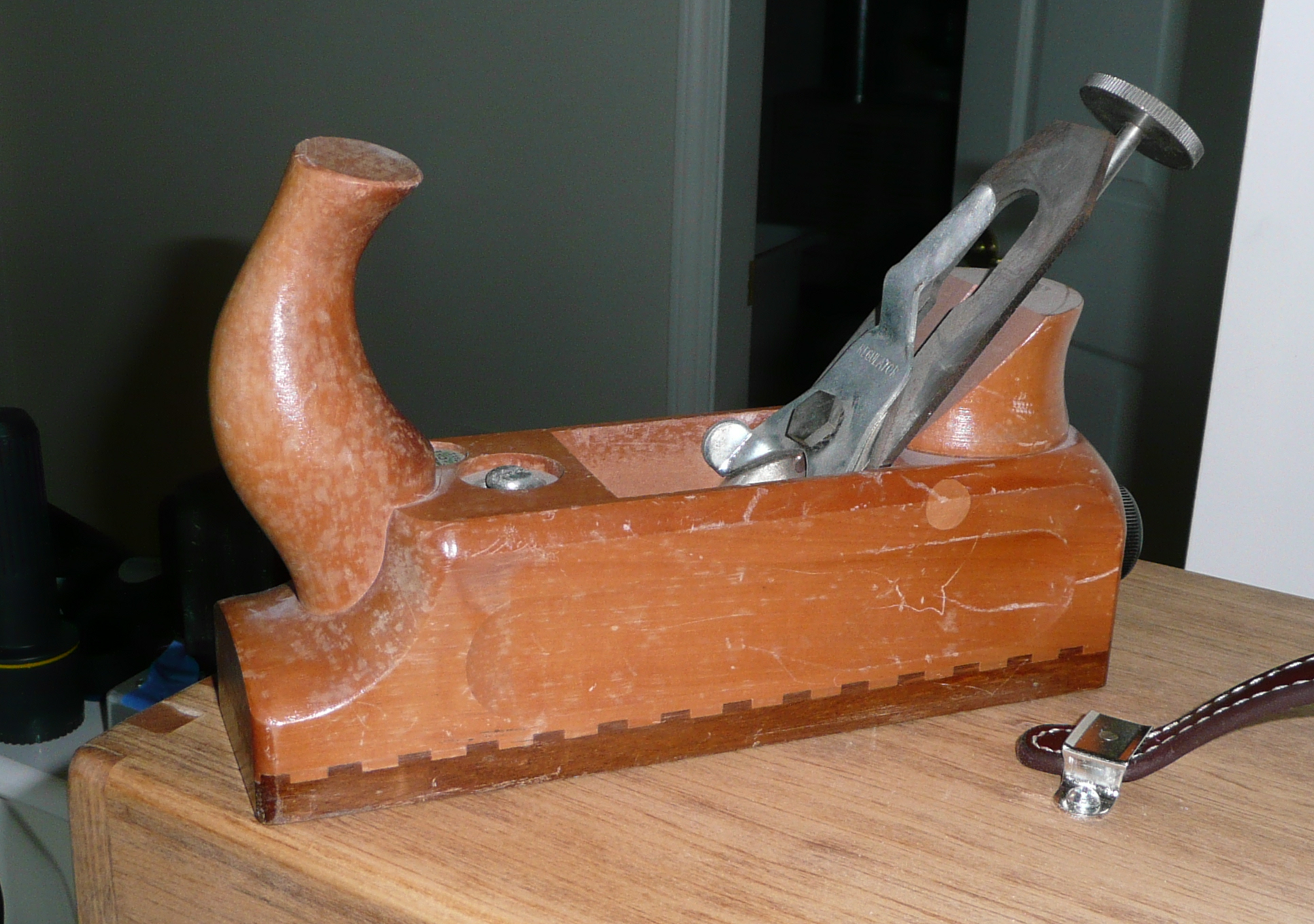

13 years ago when I made my one-and-only scratch built guitar I bought one of these, see pic. The sole is made of lignum vitae. Made in Germany by ECE.
These are a bitch to set up but when you get them right they can do amazing things.
